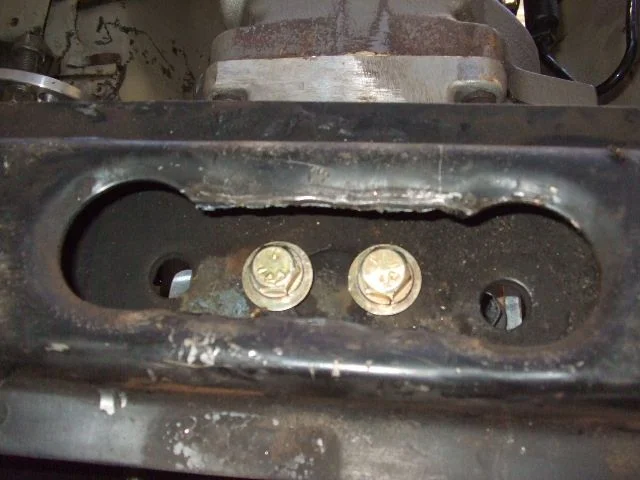

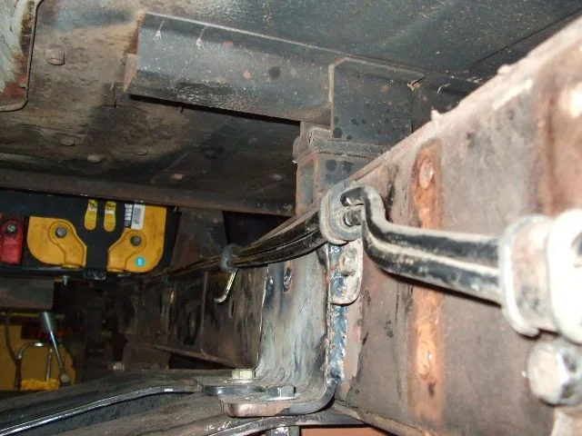

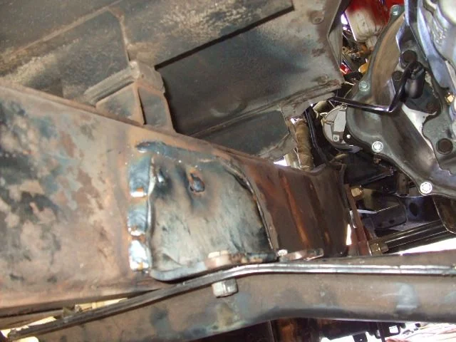

Been traveling and Mudshipping in route so I'm a little behind on the project list.
I did not like the rear crossmember I had. installing the twins stick were too tight and I have the room so I dropped the tranny back down a bit so the engine sits at 5 degrees.
I made a new style crossmember from the stock FJ60 crossmember.

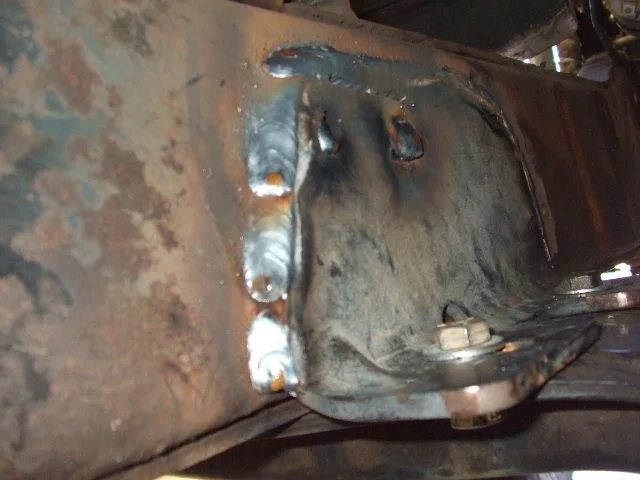

I welded the side brackets just like Ige taught me too.
Yes I suck at welding upside down.

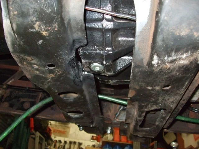

A few more of the crossmember.

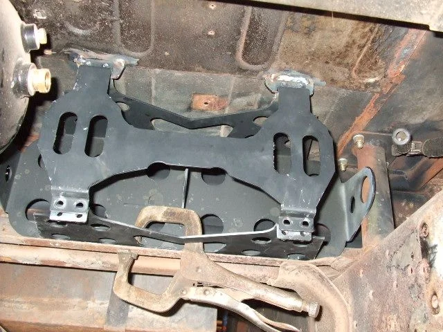

Installed the dual battery tray.

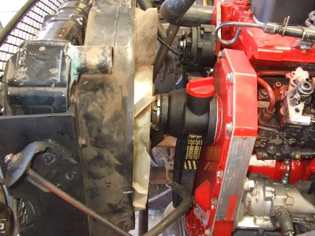

The fan is a bit more out of the schroud than before so I will be having a new thicker adaptor made.
Run it before you screw with it. I bet it'll be fine.

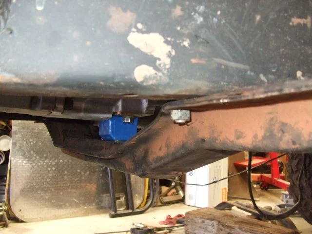

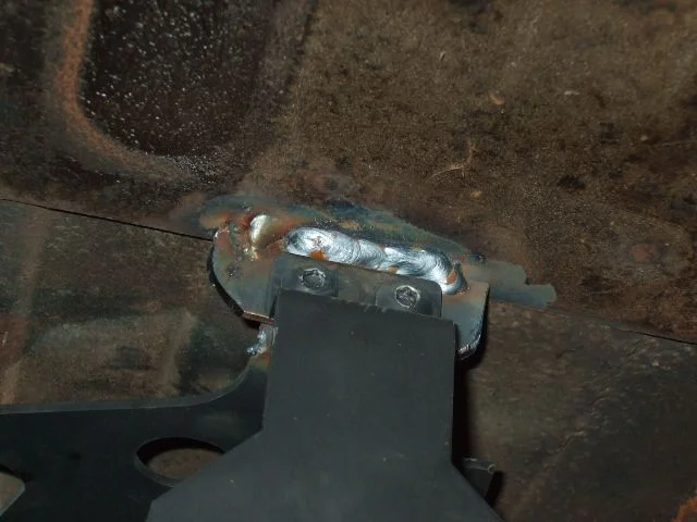

Used a second crossmember for the traction bar.
A little cutting, grinding, plating and welding to make it fit.

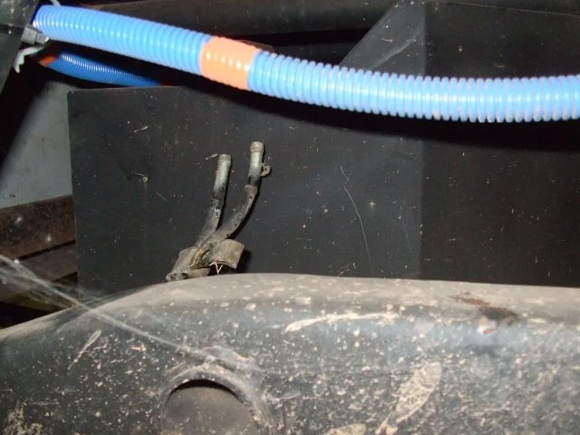

Ran the hard fuel lines down the drivers side frame.
From the engine all the way back to the fuel tanks.
The tank selector valve will go back by the tanks.

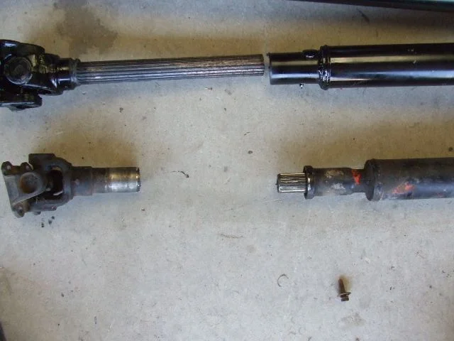

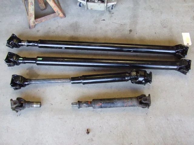

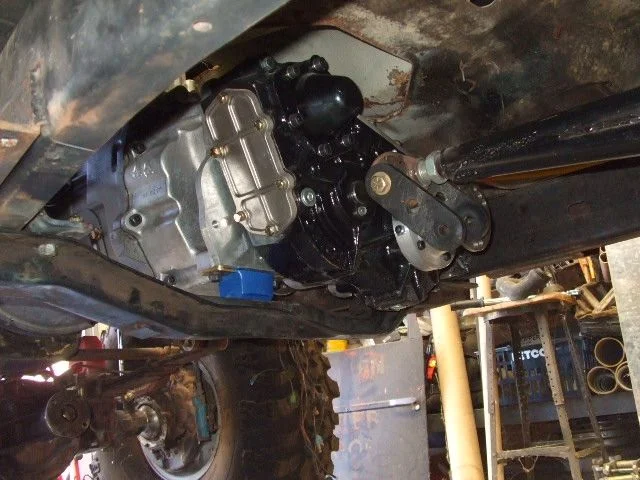

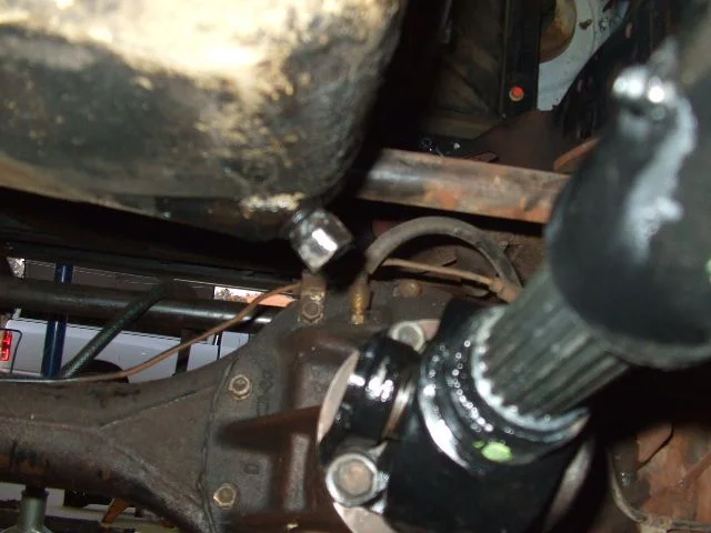

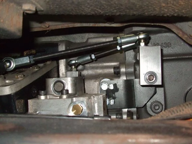

Changed the oil in the 8274 and mounted it. Time to measure and have driveshaft made, again.
I also have to order a twin stick set up since what I have will not work with the Irion 4:1HD.

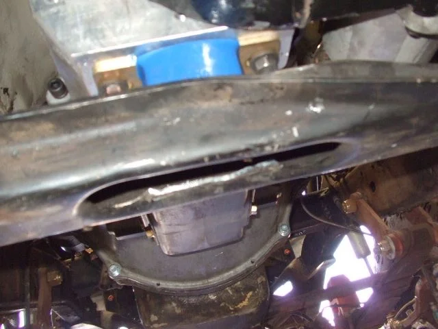

quick question... what transmission mount bushing (blue) is that? thanks!
gifu is offline   Reply With Quote
Old 06-30-09, 01:40 PM   #1101 (permalink)
Forum Lifer
D'Animal's Avatar
Join Date: Mar 2006
Location: Central California
TLCA# 17104
Posts: 15,994
Garage
Quote:
Suspension Restoration Parts Co
319 - C Motor City Court
Modesto, Ca.
Phone # 209 578 0562
www.suspension.com
E-mail sales@suspension.com
Part # 3.1108B was a perfect fit for my application. (B is for Blue). This is also a GM Transmisison mount but is built to interlock so it will not come apart.
Here is more info on the why and how.
NV4500 to Toyota Landcruiser Crossmember Mount - Cummins 4BT & Diesel Conversions Forums

coolio. thanks! i've never been able to find just the right mount that bolted up to the NV4500->Orion adapter. I'll get on the phone!
Summit racing has them as well. I understand that it is a standard GM transmission mount.

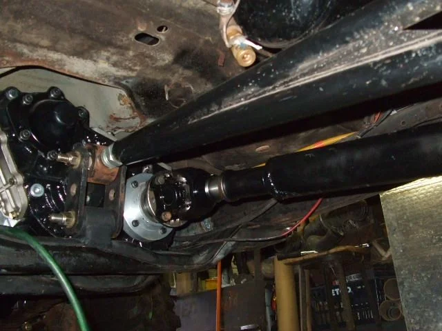

I got my new driveshafts made the two long ones are are for the rear and a spare.
The bottom two in the picture are the before (standard) and after (Long Travel) modifications.

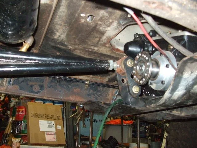

Twin Stick linkage installed.

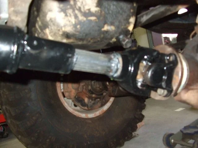

Driveshafts installed.
The front allows for 4" of compression and 8" of travel without coming apart.
I'm still looking for a larger drain plug.
Rear shaft looks good.

Yeah... that's what I understood as well... but the one I bought (can't remember part number) didn't match the bolt pattern on bottom of adapter. was easy to make a bracket, but frustrating that it wasn't just a "bolt on". it looked just like that. BUT, my NV4500 adapter is/was really old (10 years+), so... who knows. anyway, thanks again.

The rear DS looks much more tight in compresion compared to the front DS travel .. ( compresion too )

You must have paid a pretty penny for that DC long travel front driveshaft

Not as bad as you would think.
