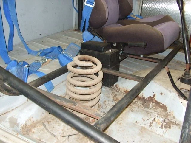

Worked on the Ejection seat. Didn't get very far, I didn't win the Eject knob and the wife pointed out the roll cage was in the way.

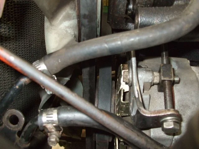

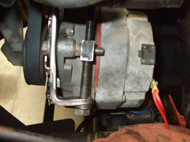

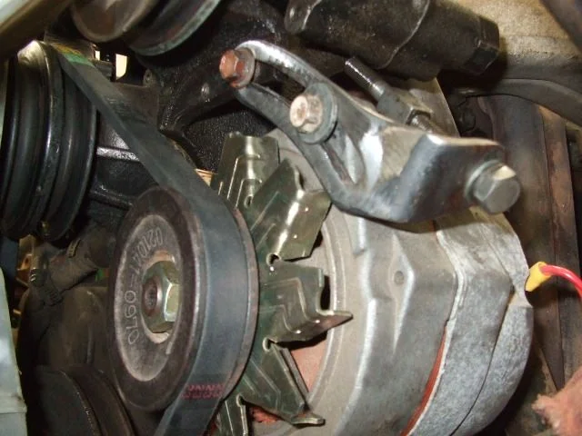

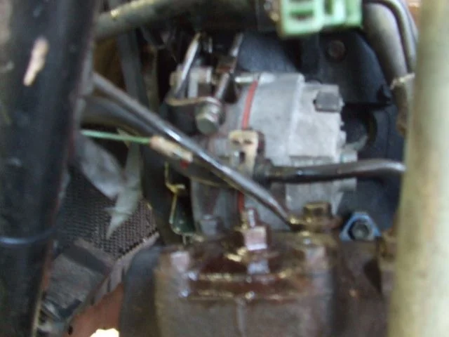

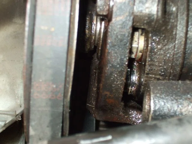

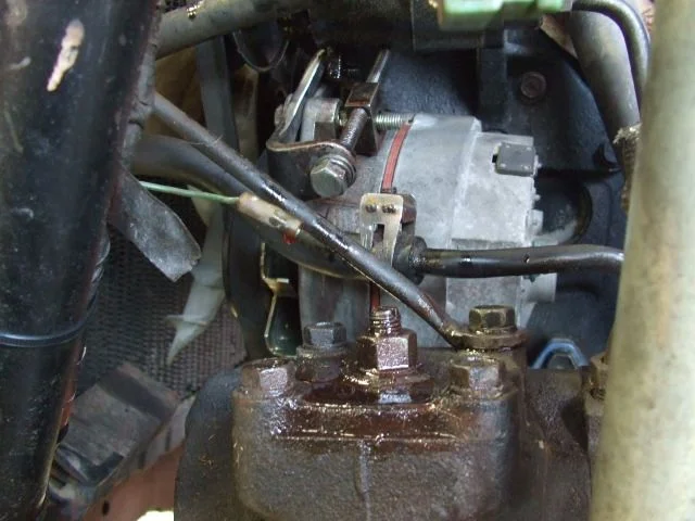

I was running a 3FE alternator but I just didn't like the way it was set up. It worked great, I just didn't like it.
I put a smog pump eliminator braket on and found that my belts were rubbing.
I installed a 125 Amp Chevy/Delco Alternator. I put a build thread covering it in the 40 series section.

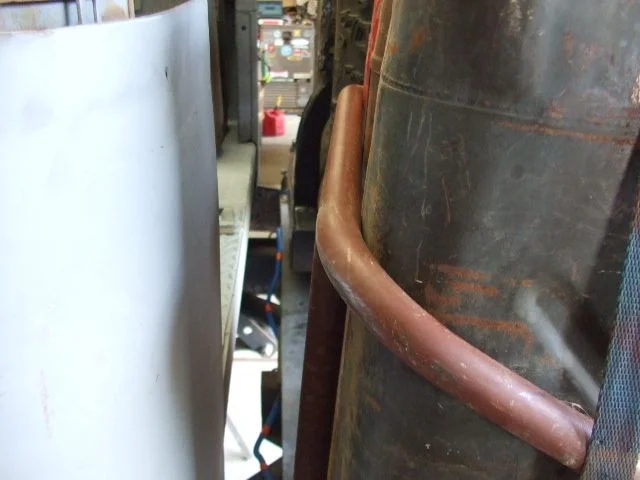

Garage

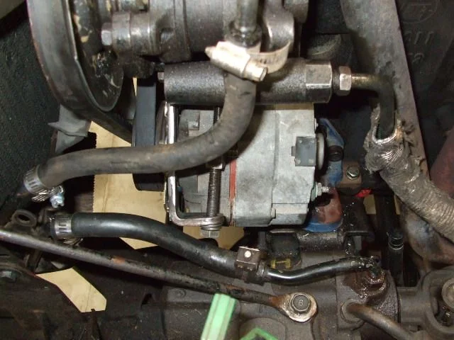

Installed a Power Steering cooler.

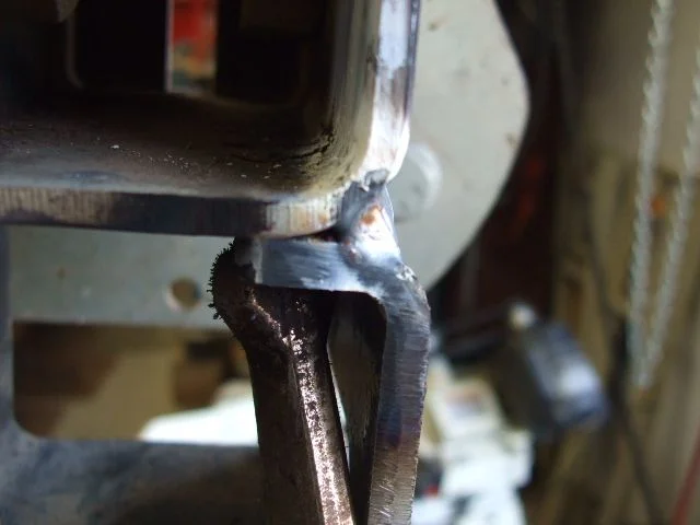

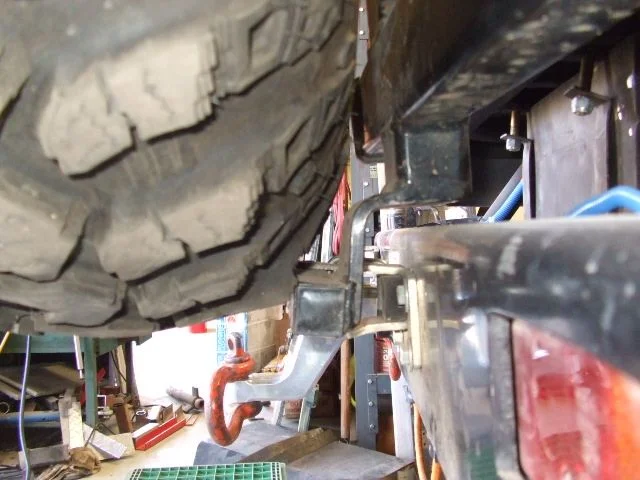

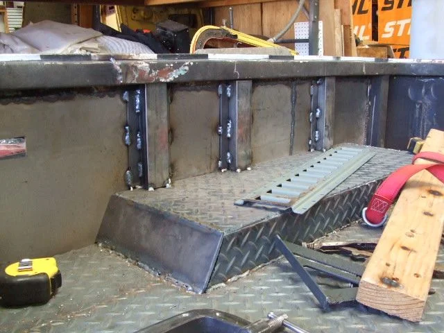

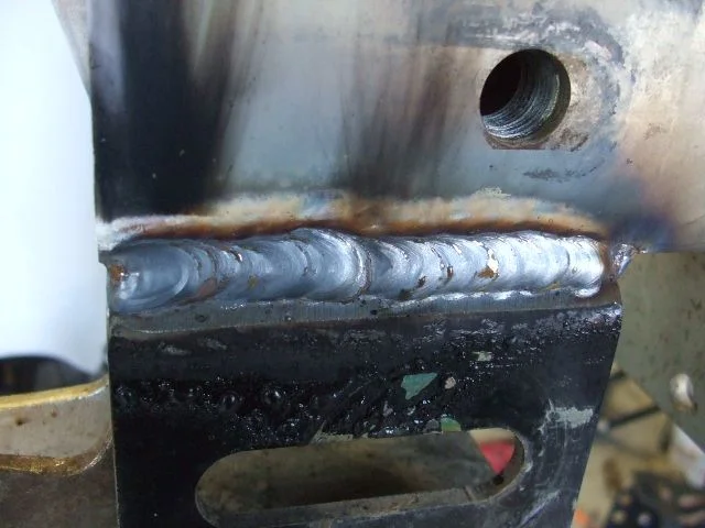

Worked on the Bed.
Installed the tabs on the subframe and bolted the bed down.

Hmmmmm. Excellent alt setup. What pulley?

I used the pulley off one of my spare 2F alternators. Goes right on and eccepts the 5/8" belt. I used a 5L430 belt since a tractor parts place was the only thing open. I will change it to an automotive belt on monday.

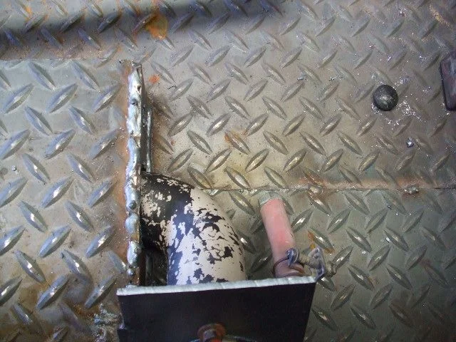

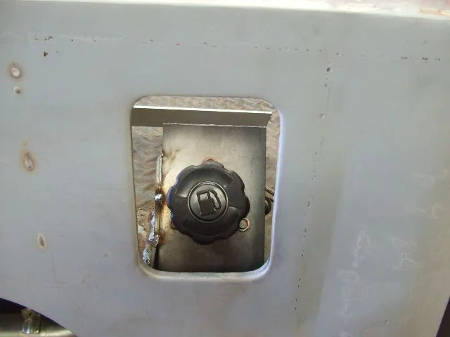

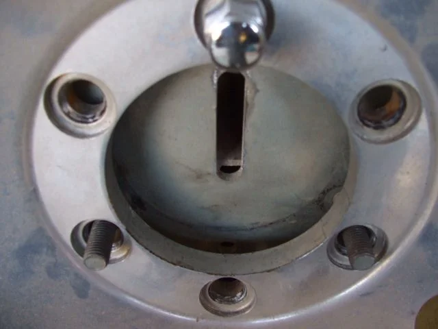

Now that the bed is bolted down, I worked on the fuel filler assy.
I'm not done with it, but it is better than a bungie cord.

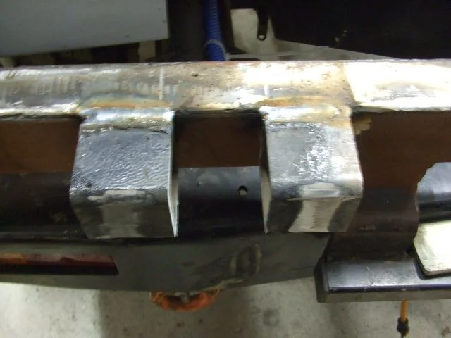

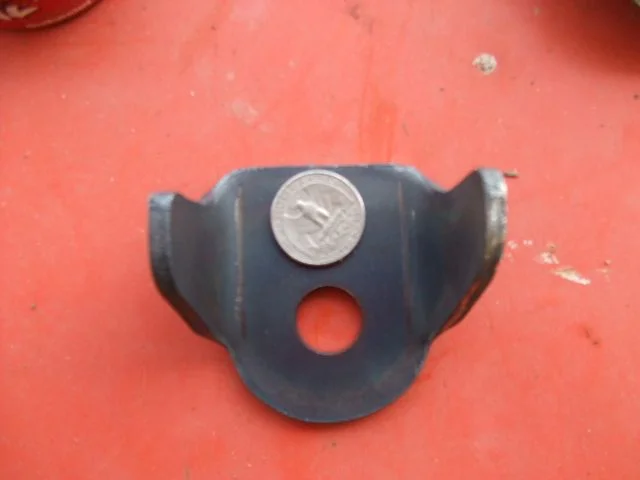

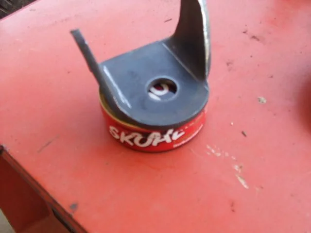

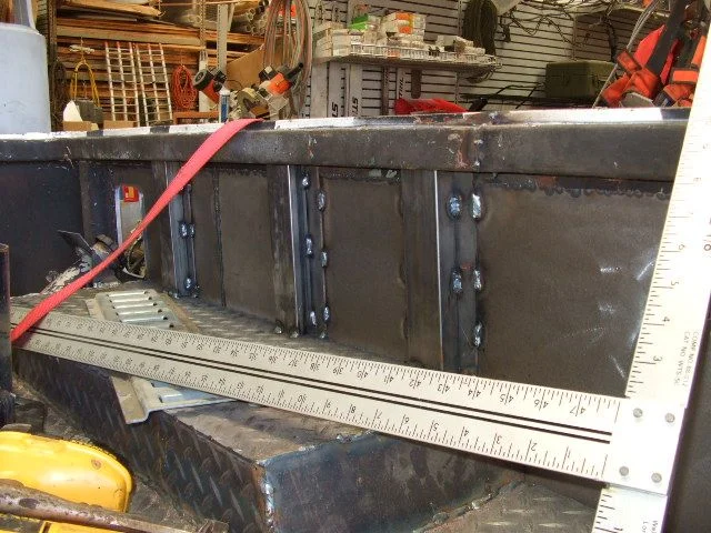

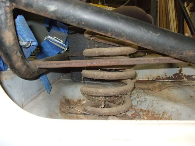

I made the uprights for the bed supports and welded them in.

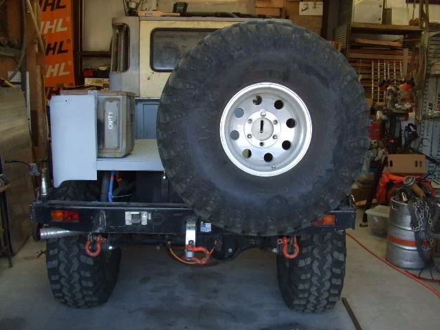

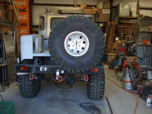

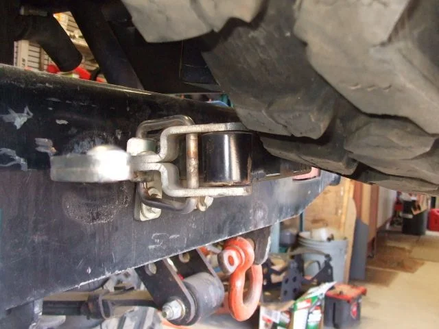

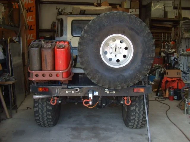

I then went to install a spare tire so I can pass Tech inspection at Moab.
Good Gosh those 39.5" Irocs are huge when they are at eye level.
I may as well sell my rear view mirror since it will be worthless.

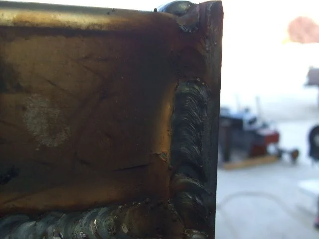

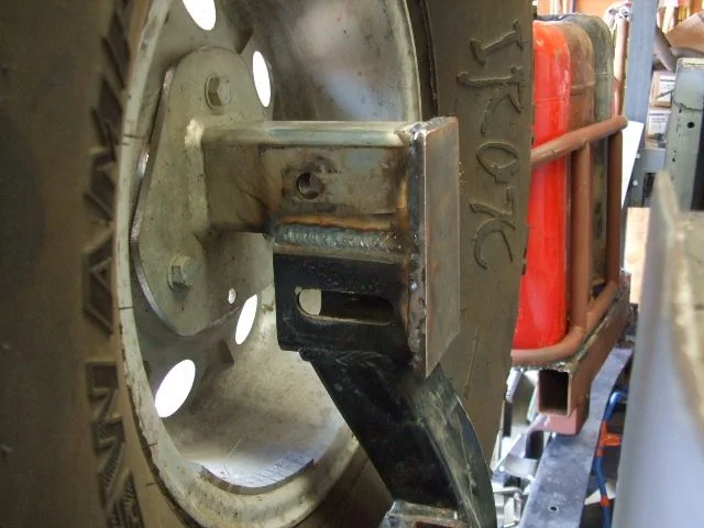

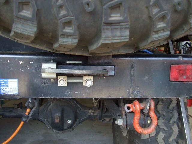

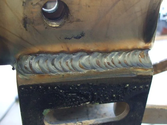

Did I mention that 39.5" Irocs don't fit on a Kaymar Bumper.
More fabing and welding.
Does it ever end?

Just throw that puppy in the bed and strap'er down. My spare, like yours, is just too friggin big for a tire carrier, IMO. I would think if you have beadlocks they should let the no spare thing slide. Again my opinion.
Have a safe trip out and we'll see you guy's in camp.

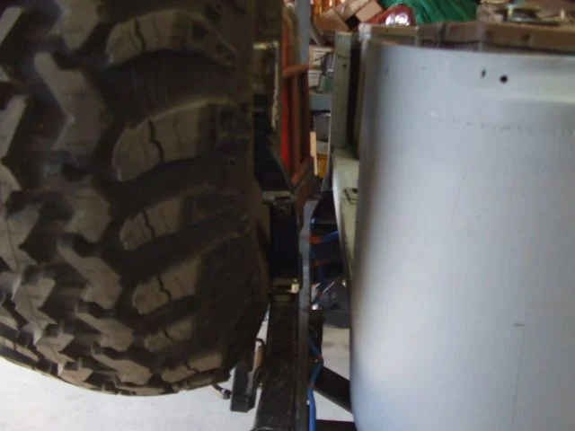

The spare now fits.
Quote:
Mike

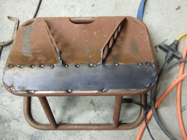

So does the jerry can holder on the drivers side. Things are too hot to paint.

Here is how I got the 39.5 Iroc to fit. It did not fit in two ways as seen in the pictures above show.
First was the height. It was too large to ever be able to use the latch.
The second fiment issue was the widthe of the tire itself. the width of the tire was hitting the bottom of the carrier. This did not allow for it to wheel stud surface to mate properly. A wheel spacer would have fixed it in a pinch but Mock up is done on this rig. Everything being done now is permanant.
I simple removed the wheel mount assy and placed it on top of the mount. After cleaning all surfaces, I cranked up the welder and welded them together. i think I got some good penetration.

Since there is a tremendous amout of leverage on this I added a back strap to weld then ends together.
I slid the wheel mount out so the ends were even in order to gain the clearance I needed when the spare is mounted.

The three fuel can swing out needed to be changed to work with the bed.
FC Fabrication made this and it was sweet.
I could not believe how well it was welded. Getting it apart involved over an hour with a Plasma and an 8' pry bar.
It needed to be spaced out to clear the bed.
I ended up cutting the carrage off the swing out and adding a new piece of 4" x 1/8" steel to the floor of it.
For the spacing, I needed 2 1/2" inches. I used some sections of 1/4 wall square tubing. I welded everything up and it came out great.

Finished product.
You can now clearly see the Kaymar latch under the tire.

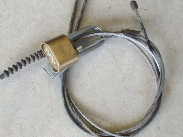

Quote:
Originally Posted by Mace View Post
BTW, I have a line lock somewhere as well.
I have not been able to get my line locks to work right.
Maybe I should go with Micro Locks?
or
I should probably do my research.

Here is the clearance between the trire assy and the fuel can swing out and the bed.
My KayMar bumper is bent so the fuel can swing out does not fit exactly as it should. I need to borrow/rent a porta power to straighten it.

Garage
Quote:
Originally Posted by D'Animal View Post
Does it ever end?
So I jacked up the front end and began bleeding the air out of my power steering system. This was the last thing to do before loading it on the trailer.
Front seal blew out after about 10 turns of the wheel and about a quart of fluid.
