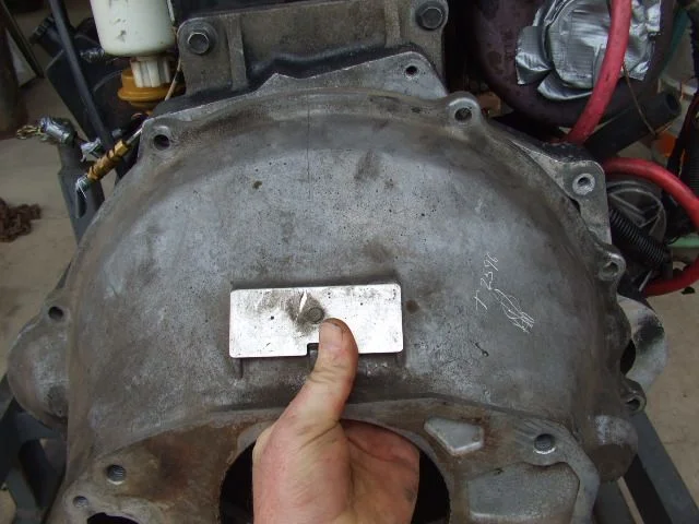

whoops, almost forgot, that is your super-pimp gear-train combo.
the answer to your next question is "NO". it's about 90% done right now, waiting on one more bearing and a new range fork from AA. did'nt want to run the old fork and had the wrong bearing so i could'nt finish it today. i will call you the second it's done though.

Thanks for doing it right!

thanks dan, some things are worth waiting for. i've been beyond anal when it comes to putting this combo together. i gotta prove "orion hill" wrong!

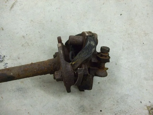

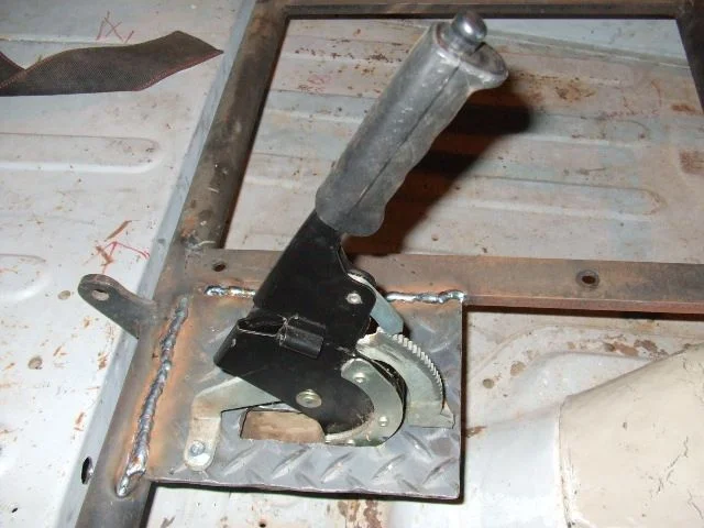

Got the rear E-Brake cables ran. Fabbed and installed the E-Brake handle/lever.
Cable is about 42" to short to reach.
Next step is the cup holders.

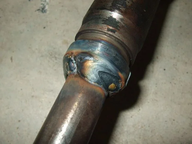

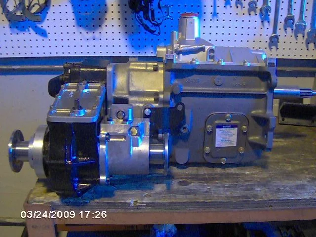

DONE!!!!!

I'm so glad your coming down Sat to help install it.
Your bringing GreenFox as well, right?
Just kidding, thanks again for doing it correctly.

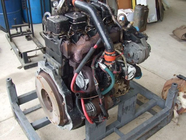

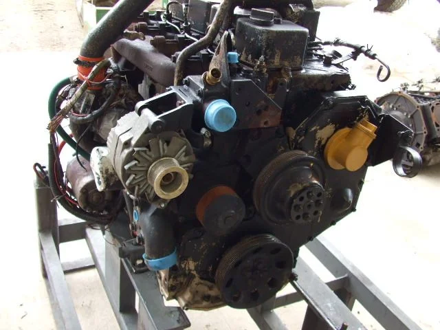

It will still be burning petro for Cruise Moab but should be running on Diesel for Rubithon.

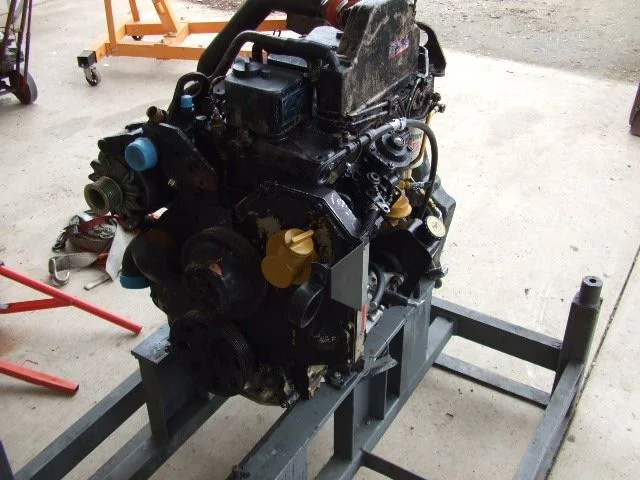

D'Animal's Avatar
Join Date: Mar 2006
Location: Central California
TLCA# 17104
Posts: 15,945
Garage

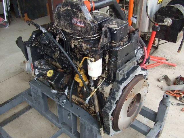

Few more.

Site Addict
calfj60's Avatar
Join Date: Aug 2004
Location: Closer to LAX than the Beach
Posts: 1,519
Dan....this project just keeps getting cooler.....looks like you have a little cleaning to do...

Garage
It is actually black paint. I pressure washsed it and all the loose stuff came off.
A good cleaning is in order though.
I already replaced the rear main seal and had the pump rebuilt.
This the 140hp version.

If you go to the orion thread, you will see that AA discontinued the 4:1HD. They only built 51 one of these total. AA made this decision during the build of this.
OrangeFJ45 (Valley Hybrid) was persistant and steadfast and was able to build # 52.

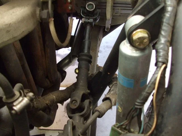

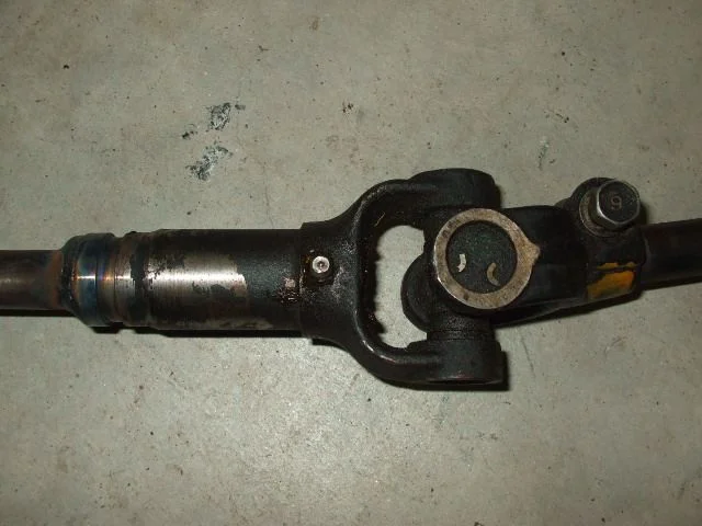

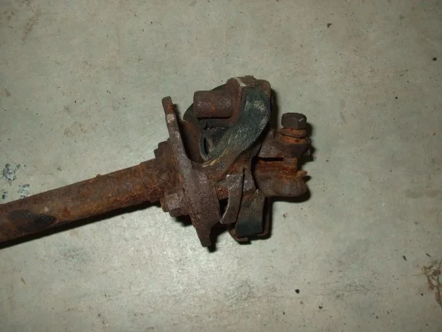

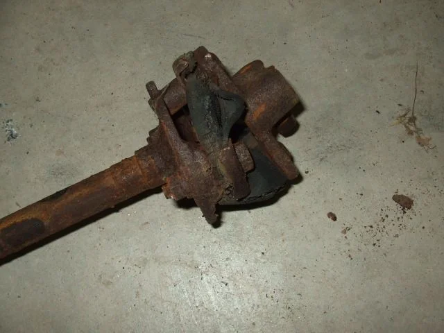

So on a club run at Calico a few weeks back, I notice a few things that needed attention.
My power steering pump went out and I was strong arming it the entire run. 39.5 with manual steering really sucks. I stayed completely away from the hardcore stuff.
The end result was a really bad rag joint. I saw this while out on the trail and was able to get it back to camp adn on the trailer. I put this in just to steer it around the shop, etc. It was intended for Mock Up only. It was on the list of things to do.

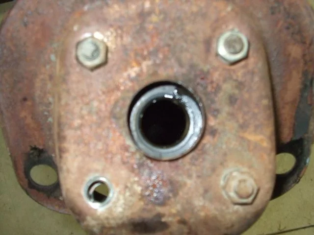

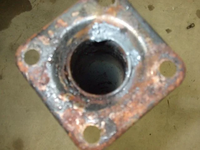

The bottom of the stering tube I guess is suppose to have a bushing in it.
I bought the 4- bolt Pillow Block Bearing but when I got everything apart, I realized that I had the 1" and not the 3/4".
I installed a new bushing and reassembled the tube.

The rag joint is a great thing for a stock rig.
Mock Up on this rig is pretty much done.
It is time to build things that will stay.

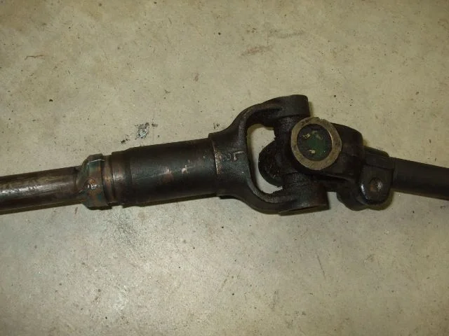

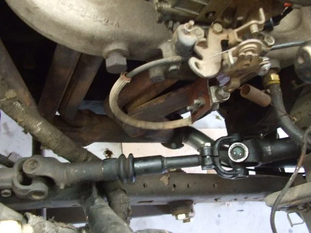

The finished product.
It is still somewhat collapsible in the splined area nearest the steering box.
It might be overkill but it was 11:00 on a Saturday night and I had to improvise with what I had.
Yes, my steering shaft has bigger Ujoints than my Jeeps Driveshaft.

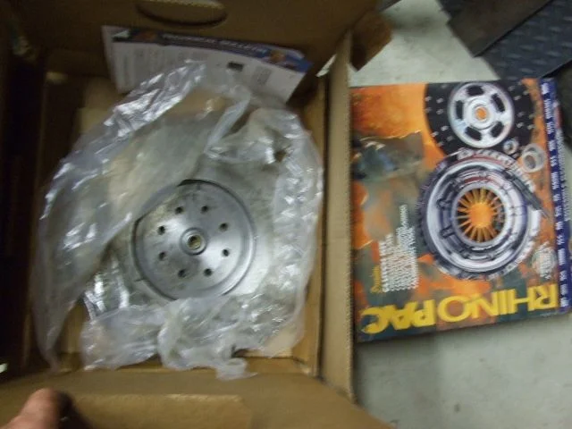

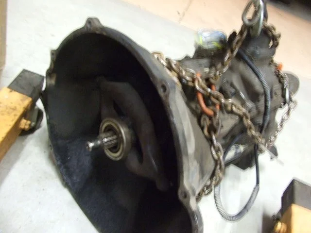

More pieces to the puzzle.
It's kinda funny how you order a flywheel, clutch assy and the throw out bearing assy with the arm, all the extra parts you get.

Old 04-21-09, 06:39 AM   #954 (permalink)
250+ Club
Z()LTAN's Avatar
Join Date: Jan 2007
Posts: 368
Quote:
Originally Posted by D'Animal View Post
Less wire speed or more amps mate.
Its coming together well! Looking forward to the 4bt install
__________________
Lock, Stomp and Steer, No Fear
Z()LTAN is offline   Reply With Quote

Dan, what are you doing with the 2F when you swap for the oil burner? Hint hint hint

Probably sell it to a guy in Redondo Beach who asked to buy it.

Dan,
The u-joints on the steering shaft are out of phase

I knew that was coming.
Quote:
Originally Posted by rockcod View Post
Dan,
There is a flat spot or splineless area in the coupling flanges. I could not get it aligned or phased properly.
I will let you know if I notice any vibration.
Great engine! It'll be nice to meet up at rubithon with another smoker

I wonder if I should post up the screen name of the guys who are telling me to not do it and that I will regret it later.
