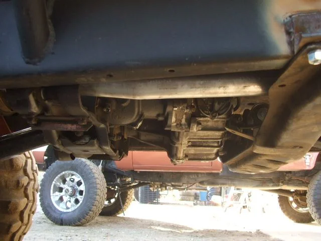

Dual Crossmembers
Front is T-Case/Tranny mount. Back is for the Traction Bar.

interesting you didn't use a shakle at the top of your tracktion bar ... ( frame side )

He used my extra cross member and bolted it up. The big Hemi joint is up in there. I would have shackled it, but I'm not complaining.
Quote:
LOL!

Doesn't the front of the trac bar need to be able to move forward with a shackle? Or does the heim allow for enough movement?

Dan, go flex that out oand see what it does to your springs.
A hard mounted bar like that is going to bind up something fierce..

It is an easy enough fix. Should it be a long shackle or short shackle?

mostly what fits currently..
Ramp the truck as it stands, look at the springs
Then disconnect the rear bar and ramp the truck again.
get a good idea of how much movement the bar will see dring articualtion.
That will help ya get a good feel for how long the shackle needs to be.

i would also highly recommend adding some more material to the axle mounts for the track bar. weld a plate across the back and one to the bottom to connect the two side supports and to get more surface on the housing itself.
without the extra plates, the two side plates can and will tear out of the housing. remember, these are stamped housings, not thick wall tubing like the domestic counterparts.
