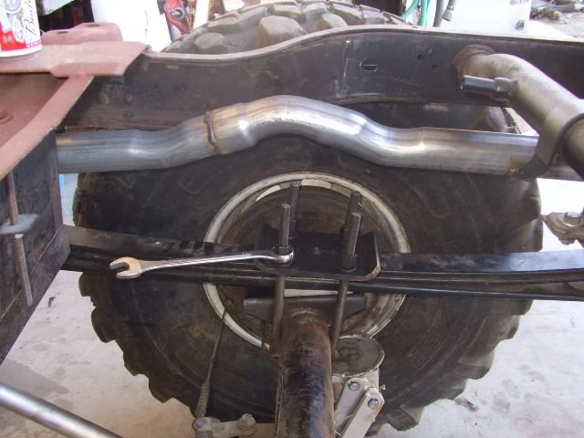

Last one of the Sexy Exhaust.
I promise!

I think even DHondaGod would be proud!
(or say holy crap, what are you doing with the 24mm wrench on the U- Bolts already.

So is it a bit quieter now? Bit less tractor-esque?
Looking good. Did the shims help that rear angle a bit?

I put 6 degree shim in and very snugly/tightened everything. It drive around through the Pit adn the front yard and retighten them. I took in "The Park" tonight and when I got home, I tightened everything again.
It is super quite even with a FlowMaster 40 series. I drove around and the neighbors did not know I was out and about.

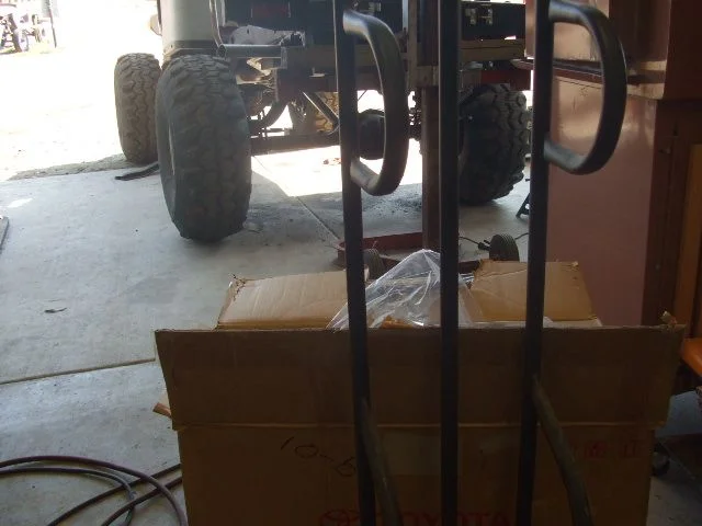

So close, but yet so far.

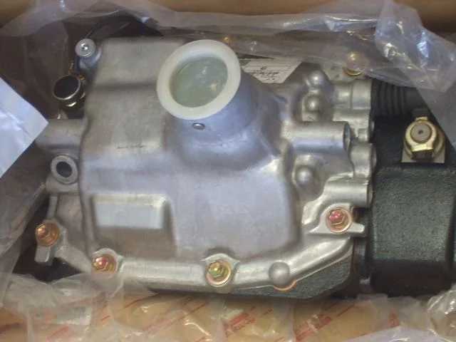

Join Date: Mar 2006
Location: Central California
TLCA# 17104
Posts: 11,362
I'm thinking about putting that H55 in the front seat just so I can say I had an H55 in it but took it out. LOL! I put a 22RE in my FJ60 that way.
Too bad it's not mine.

Nice. how much do one of does from toyota run for?
__________________
What is rock crawling?
My build http://www.pirate4x4.com/forum/showthread.php?t=637144
fj40forlife is offline   Reply With Quote
Old 09-16-08, 07:35 AM   #561
Beagles Rule!
D'Animal's Avatar
Join Date: Mar 2006
TLCA# 17104
Posts: 11,362
Used to be $1,800 from Toyota of El Cajon plus another $150 for the shift.
It weight a few hunded punds adn is shipped truck frieght.
Quote:
Quote:

Well the new spring perches finally showed up a week after I ordered them.
The Sping perches are in, drive shaft cut to right length and the traction bar installed.
Kinda hard to believe since I have been gone and dont know the guy. He came by the hosue and did it all in his mobile service/ fabrication truck. He did take the driveshaft to his shop for the cut and weld.
Thanks James! Whoever you are.
