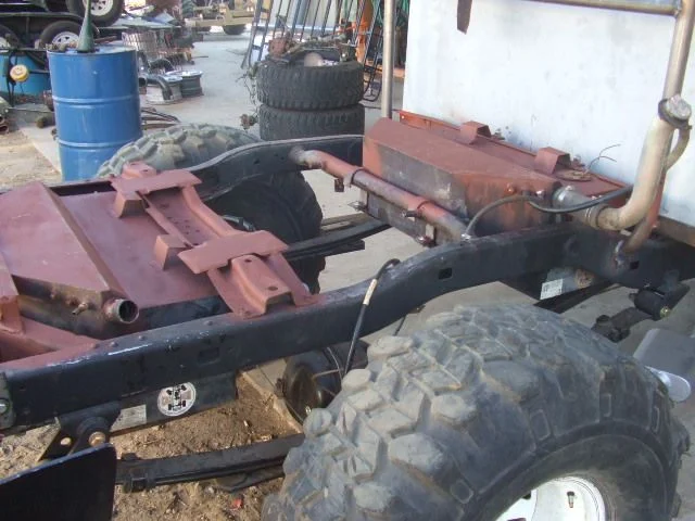

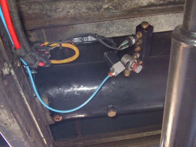

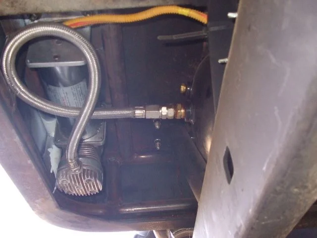

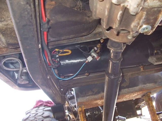

Detroit in the rear, ARB up front. 4:88's. The Viar 480C is mounted and plumbed as well as a 5 gallon air tank.

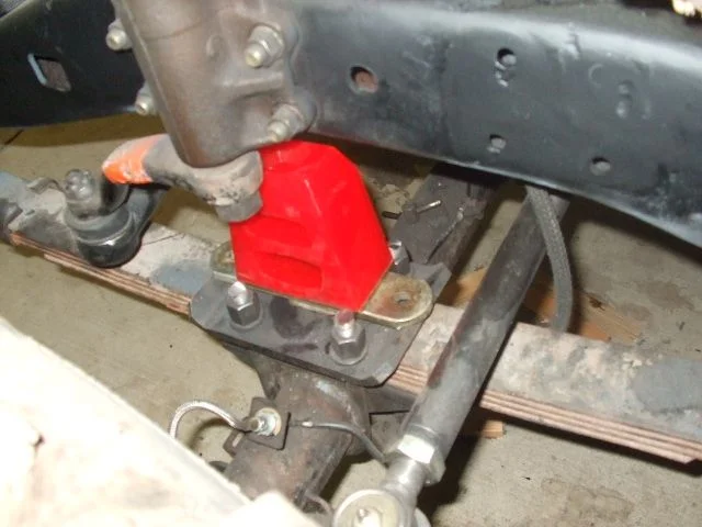

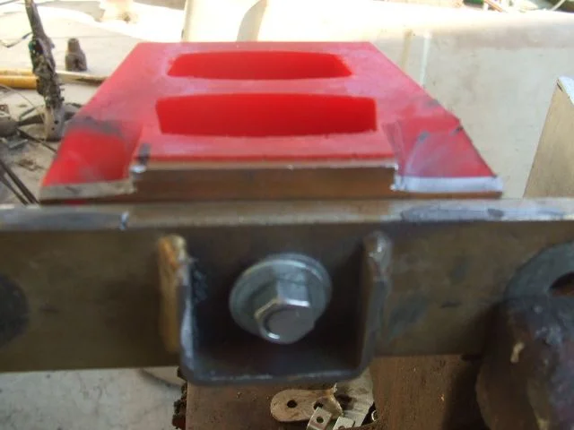

looking at the bumpstop pic .couldn't ya turn the bumpstop upside down compared to it in the pic and make a plate and attach it to the top of the u-bolts and have it bump up against the frame ? instead of attaching it to the frame and bumpimg into the u-bolt plates. .
Quote:
Originally Posted by D'Animal View Post
Well I did a few things to it on sunday.
I cut the front U bolts and am pondering the bump stops and mounts.
__________________
I'm thinking that is the easiest. One reason I was going to mount on the frame is that the spring plate is a bigger target to hit. If I mounted to the spring plate, the frame is small target to hit at only about 2 1/2" wide.

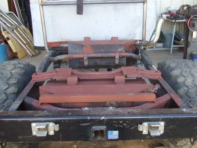

I'm also looking at the antiwrap bar for the rear.

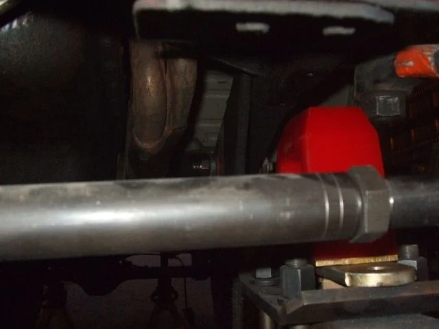

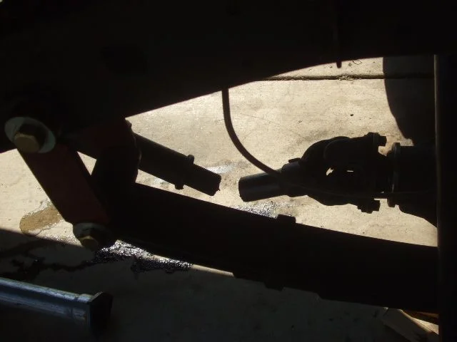

Bump stops
So what do you think before they are welded in place?

just been through this whole thread & I like what you have done so far......oh yeah bump stops look good where they are

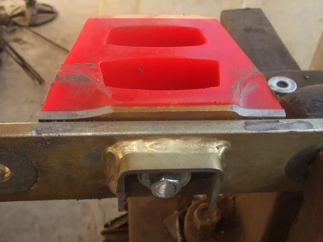

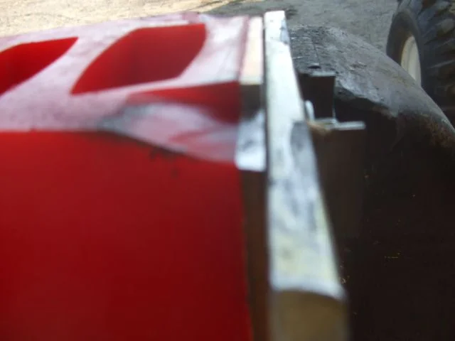

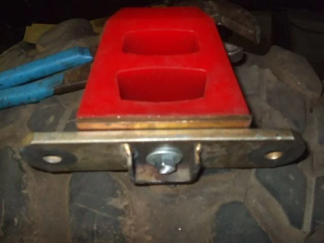

Knotched For the U-Bolt studs
Combination of Band Saw and Sander and they look kinda custom.

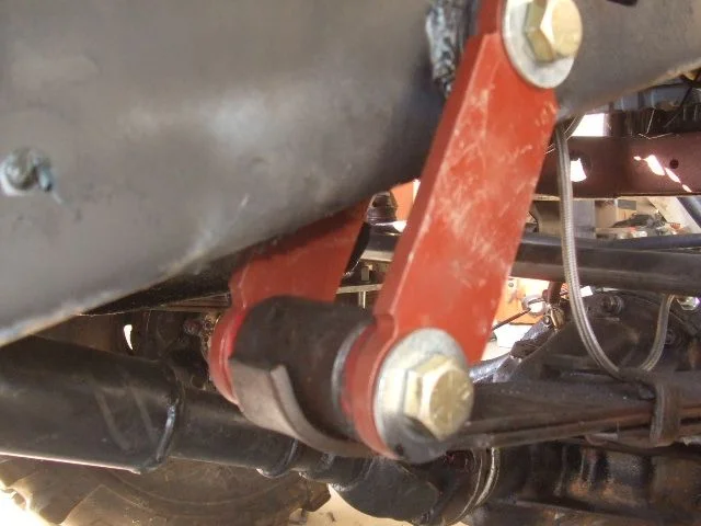

After the shakle reversal up front the springs were a little too close to the frame for my liking. I added some 1" longer shackles and it made a big difference.

My Morning Sucks
This is the way my morning is going.
Longer shackles so the springs do not hit the frame. Lift the front end to weld the Bump Stop Brackets and find the Driveshaft is too short.
I think I need a European Beer already (Budweiser) and it is only 10:00am.

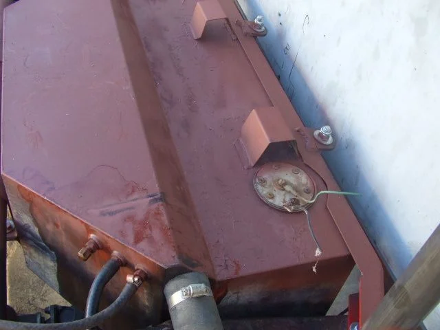

Removed the custom fuel cell and installed fuel tank I bought from Rusty_TLC.
The skid plate went on the rear tank.
