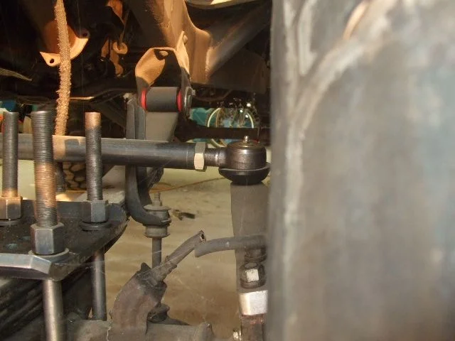

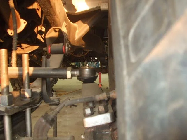

Something like this will net you roughly an inch or 2 drop (this was on my 40). Then sleeve the shackle bushing through the frame and you can pick up a couple of more inches. Should be pretty easy to get you down a bit.

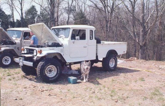

I really like the looks of that truck. I had it as a screen saver for a few years and told the wife I was going to build one one day.
Originally Posted by patches84 View Post
G'day D'Animal,
I have really enjoyed watching your progress, thank you for posting it. I'm sure you have seen this truck before, but I thought I would post it here anyway. This was taken in Virginia in about 1996 or 1997 if I remember correctly. I don't know where she is now, but she was featured in the Trails back in the 90s sometime. I have been planning a conversion like this for about 15 years... one day I will do it too...

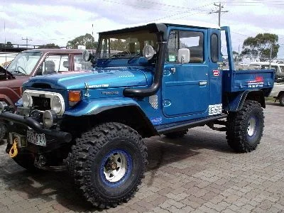

Here is a really nice one.
I'm kinda hoping mine some what resembles this when I'm done.

Wow, that green one is absolutely beautiful! I agree with you about the departure angle, though- looks a bit nicer with a bit of a bum out the back. Yours is going to be really amazing when it is done, I'm sure.
I really want to make one with a factory bed, though, as I love the way they look. It is really hard to find them with the factory bed (or 'Tray' in Aussie), but I have been looking. I like the idea of keeping mine factory wheelbase, and just moving the cab back a bit. Of course, once I get started, I will change all sorts of things, I'm sure.

That particular truck comes from Aus and as far as I know it is on the larges legal size rubber that can be used in that state.
But yes Chappys it seems D'animals truck will dwarf it!

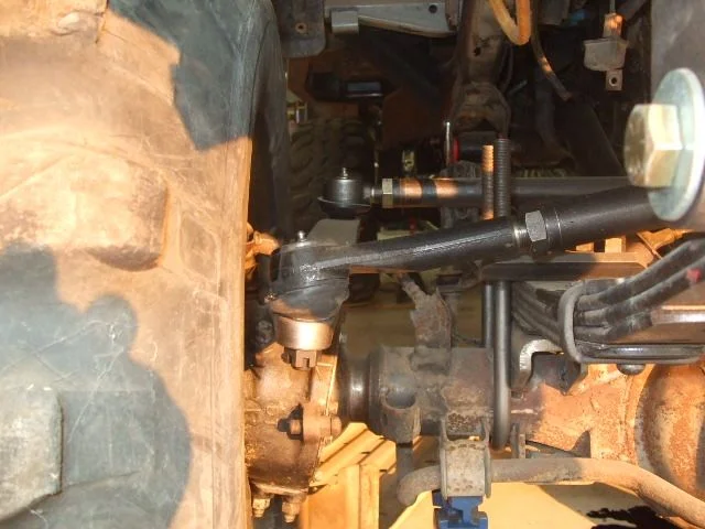

Looks like a lot of angle on the drag link. What drop do you have on your pitman arm? I guess you can only drop so far till you have interference with the leaf spring
