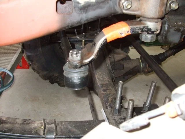

Valley Hybrids did a fast turn around on my power steering box. They reamed the pitman arm so the Dana 60 tie rod would fit.
I bolted the box back on last night and have steering for the first time in a long time.

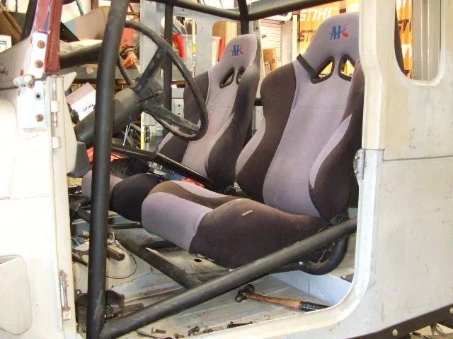

I got alot of the wiring lined up in the engine compartment. i stilll have not figured out where the red wire goes.
I also installed the seats.

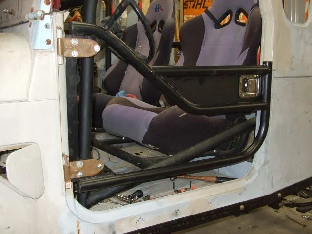

Metal Tech Tube door installed.

Location: Central California
TLCA# 17104
Posts: 11,359
Quote:
Quote:
Originally Posted by orangefj45 View Post
pics!
Here it be.

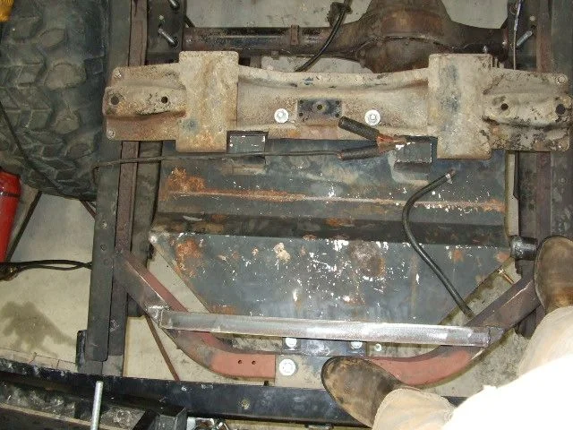

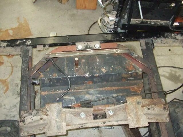

Con Fer FJ40 Long Range tank installed. Please remember that this is an FJ 60 frame.
It took three mudship connections to get it from Tahoe.
THANKS GUYS!
I flipped the spare tire carrier/frame brace over and notched it. I welded up a bracket to hold the rear of the tank down. I used the standard FJ40 Con Fer Long range tank straps.

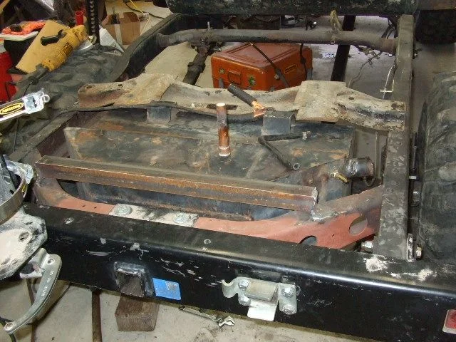

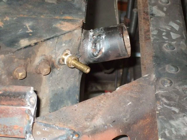

Fuel nipple modification to make it over the frame without the tank being too high for the flat bed.

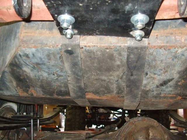

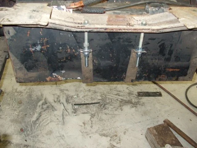

Standard Con Fer FJ40 long range straps installed and holding the tank up.
Nut are not tight yet.

Danimal is a great friend and mentor. When I visit he lets me wrench
on his projects with him, and I always learn alot from doing it.
The final version of the tank mount was the results of trial and error
but worked out great.

4x4 Lab Gear installed.
Dan, what pitman arm did you use? I need to get my tie-rod horizontal and with 4" SUA, the more drop the better.
__________________
