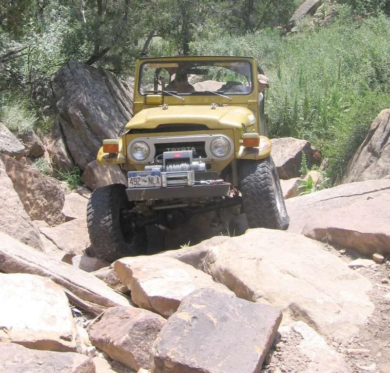

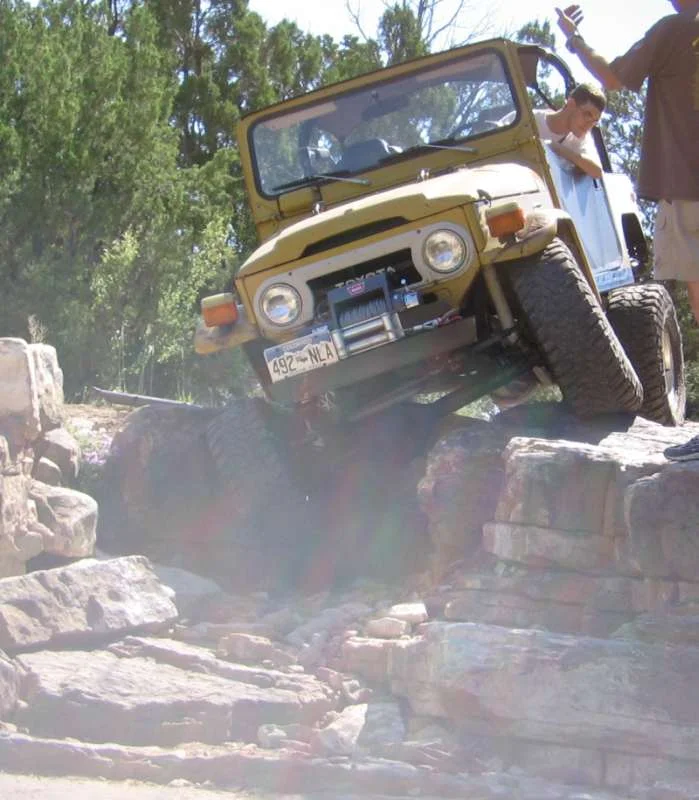

Too Much Flex (from my Hood)
My Hood is everywhere, It shifts from side to side about 2 inches, and eventualy i loose my latches and its catching air.. I did not realize how bad it was till i saw this photo..
Im going to be doing a cage tied to the frame at 6 places, aswell as some tube fenders / Radiator protection soon, Any tricks to keeping things in place while flexing??

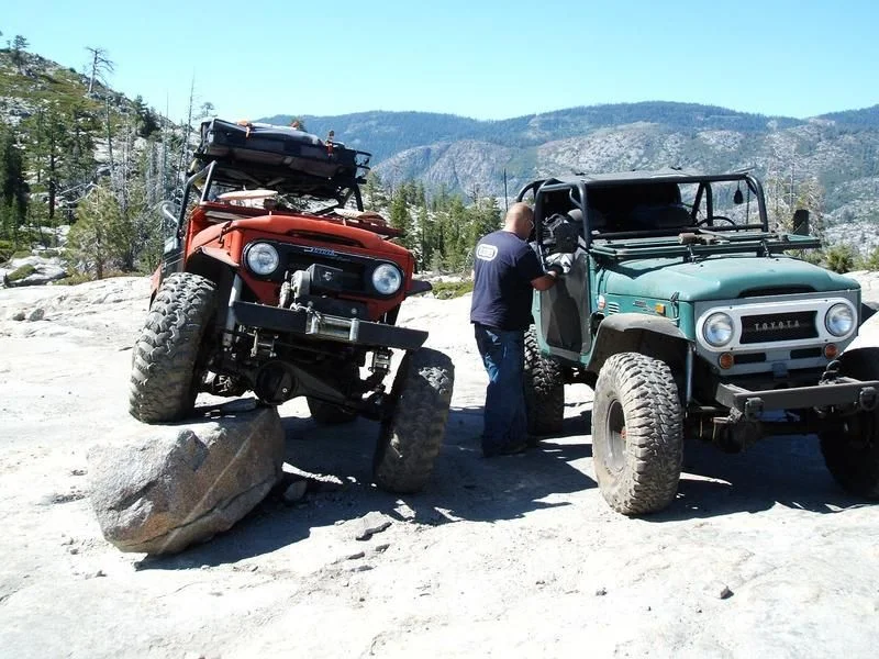

I stitch weilded the frame on my 74 it did help out alot.
