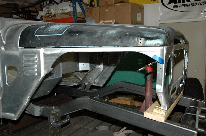

Posts: 155

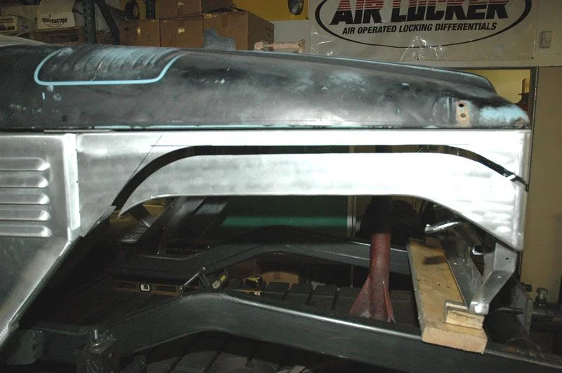

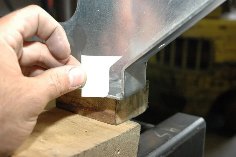

Got some more work done...trying to get all the mounts mocked up so I can remove the body and do the alluminum welding on it to fix/modify it.
We removed 3" from the fender apron. This lets me move the fender up 3" and forward approx. 2.5". This will help me fit the 40's easier but still keep the LC frontend lines. I am extending the rear part of the fender and may be slighly widening it also.
Lar

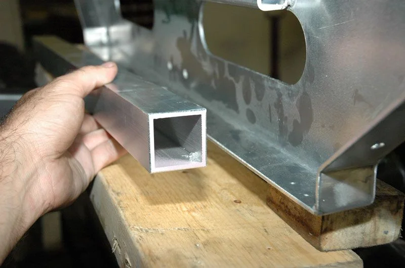

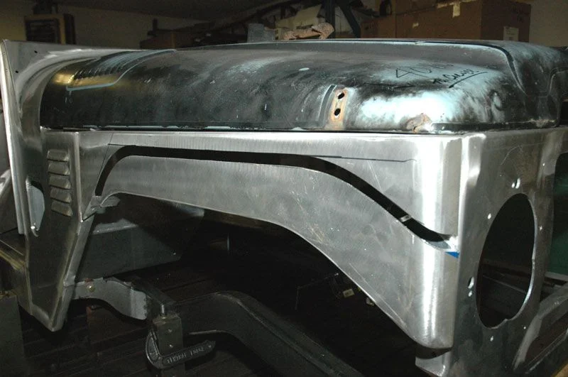

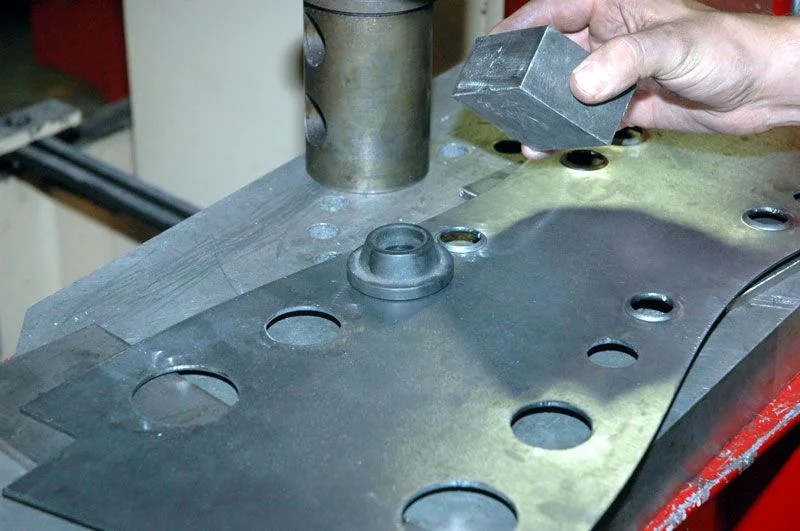

I need to add 1/2" of material between cowl and apron to get the hood to flush out on the grill...I will be welding bar stock in there and you wont even see it after its welded and buffed down. Apron allso reduced to 1" to hoodline.
The 3/8" spacing on the cowl to fender will also be filled for the 'smooth' look. I really dont like the gap so it will be made flush with the fender.

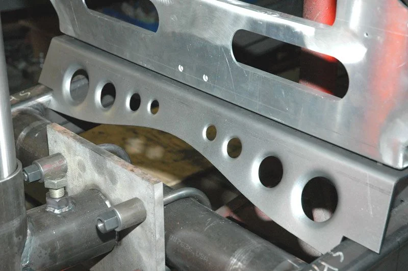

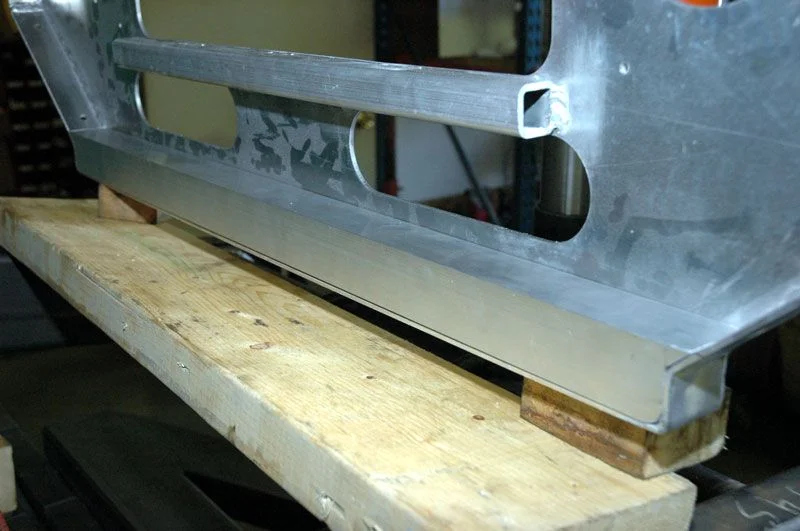

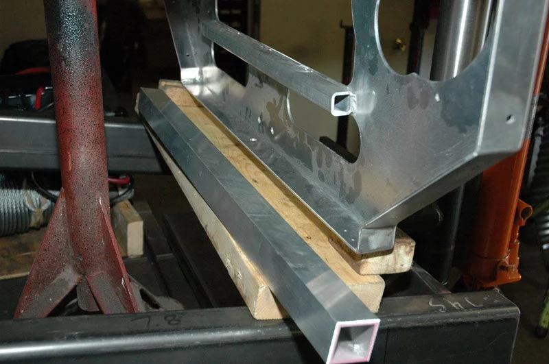

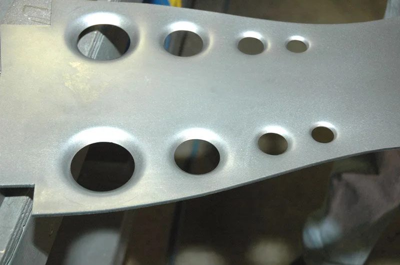

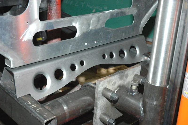

Working on grille mount. We are adding square to bottom of grille for strength and the mounts we have in mind. Will be welded and buffed when its fully fitted.

more.......

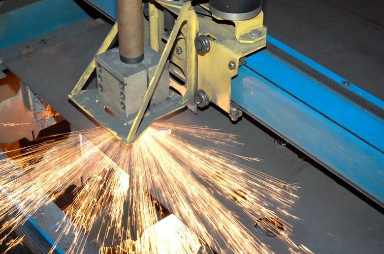

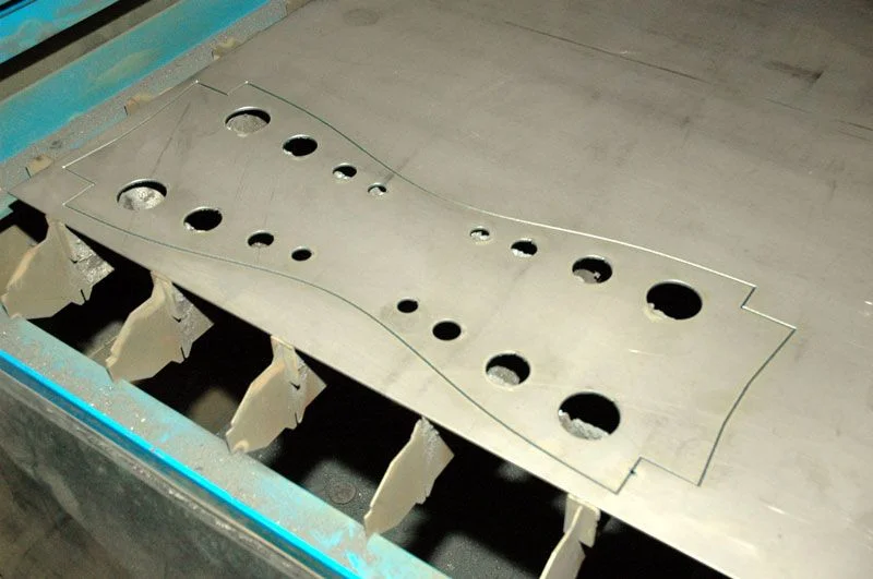

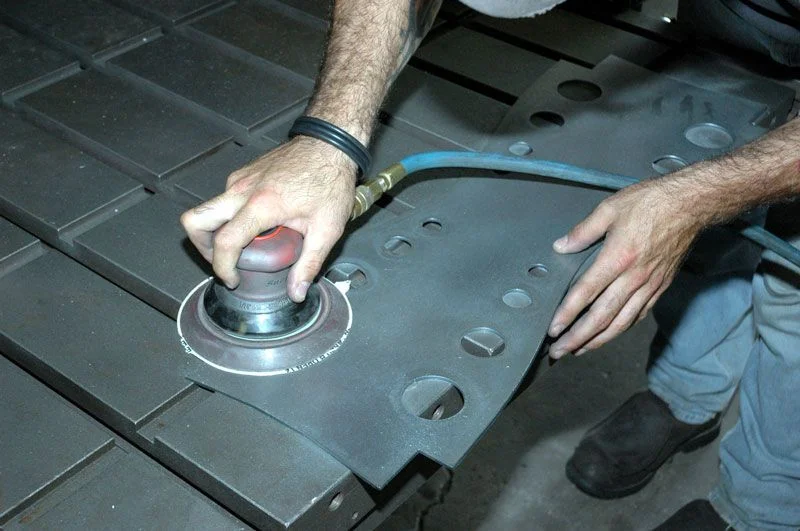

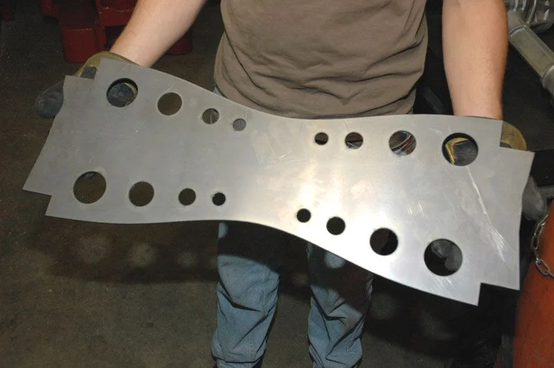

Grill mount crossmember....
We designed it, unfolded it, cut it out on our cnc plasma and then hit it with DA to buff it

After it is cleaned...we dimple died all the holes.... We then bent it on the press brake (forgot to take a shot of that).

Final result... A little overkill for the mount, but i like it. It is not finished yet...will be plated on bottom (dimpled also) and have a few other tweaks
I need to thank my wife for all the patience (long hours) and understanding...plus shes not scared to get dirty....gotta love that.
thanks,
Lar
