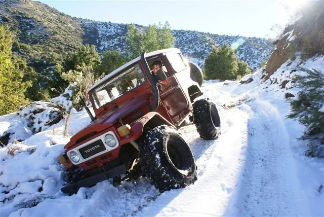

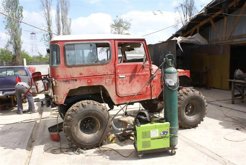

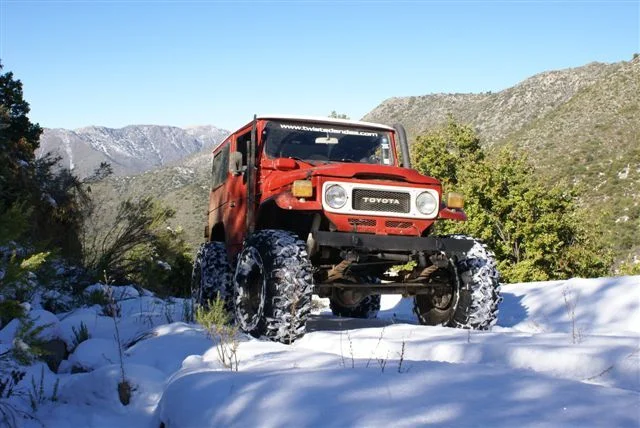

Hello
I'm Facundo form Chile, I have an FJ60 and FJ40, and this is my Project.
I build an FJ40 with FJ60 Axles (Full Floater Rear)
-4.88 R&P
-Powertrax No Slip Rear, ARB Front
-Longfileds
-Super Swamper TSL 38,5 x16 on 10" Rims with a lot of offset.
I use the FJ60 axles, they are stronger, and a litle wide.
Now Im going to change the engine (350 TBI), PTO Winch, rock sliders, and oters upgrades.
Today I went to a trip to test my cruiser before the engine change. here some pics.

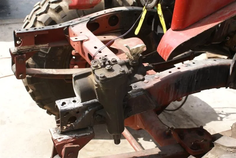

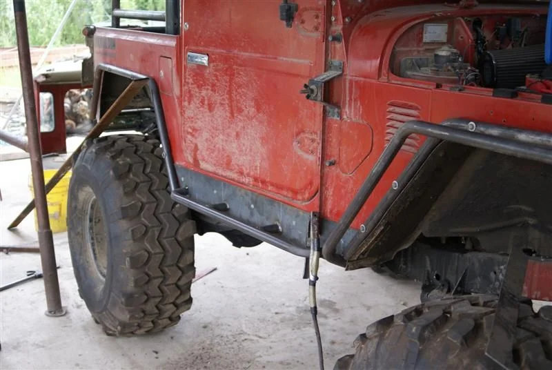

More pics

Great shirt
Nice cruiser to boot!

i love that shirt, need to get myself one
also love ya cruiser, lookin good, that snorkle is awsome too

Hi
I don't like this snorkle, I'm planing to change for an ARB snorkle in the future.

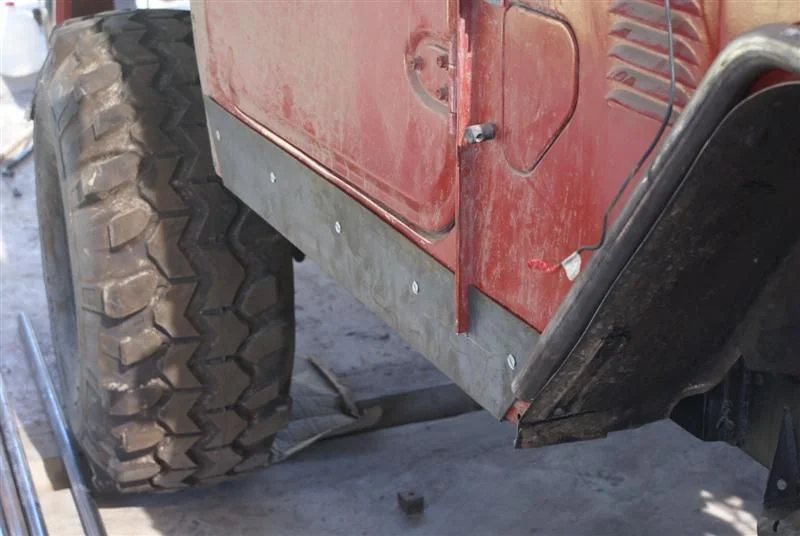

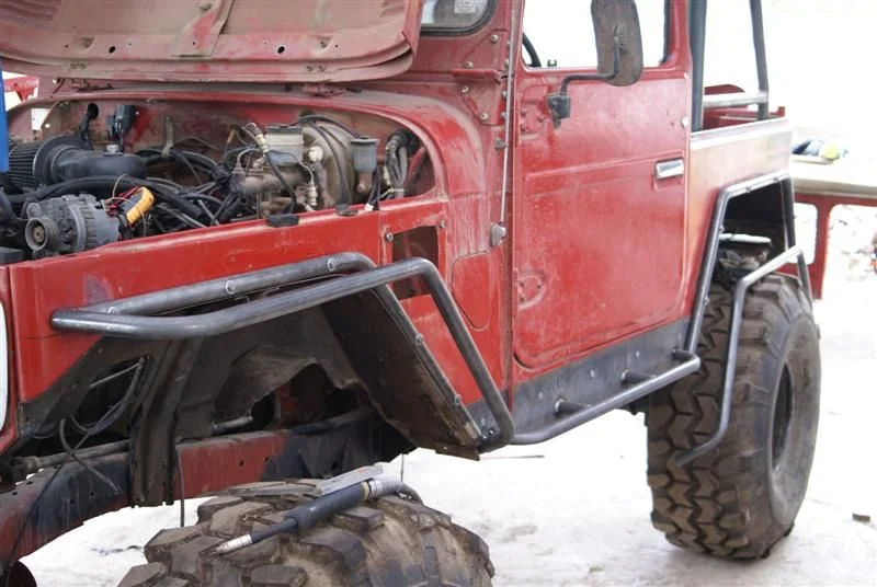

My Plans:
- V8 350 TBI + Downey Adapter + H42 + TLC Transfer case.
- New Full Roll Cage in 2" like Wranwler TJ
- New Rock Sliliders
- Tube Fenders Front and Rear
- Rear Revolver Shackle
- Front PTO Winch
- Rear Warn 8000 Winch

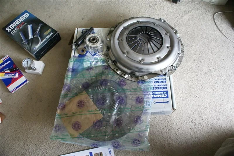

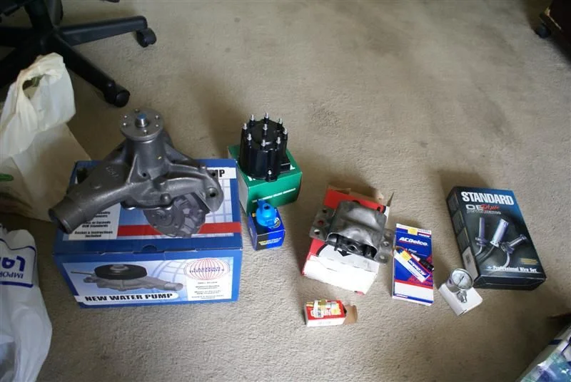

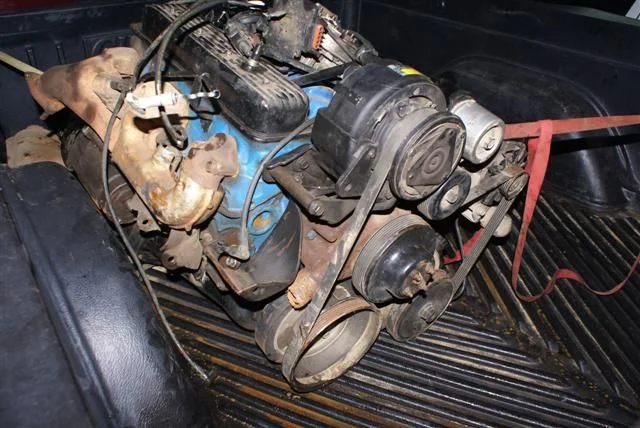

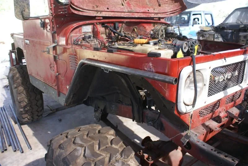

I have Engine.
350 TBI

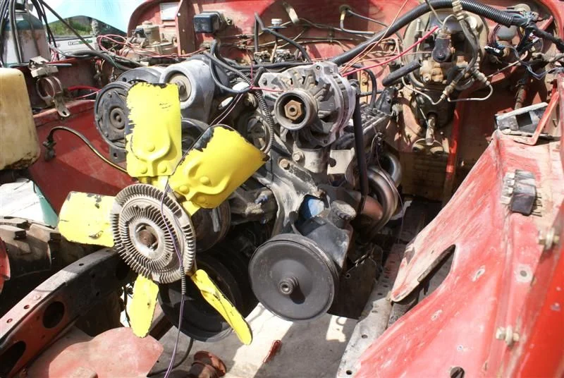

more pics...

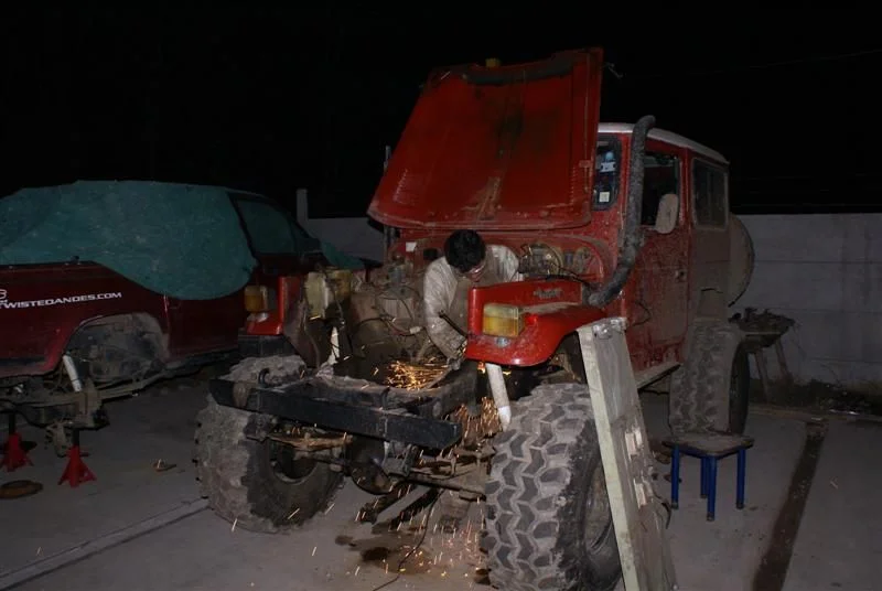

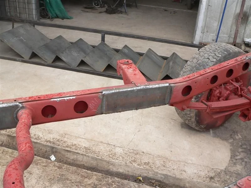

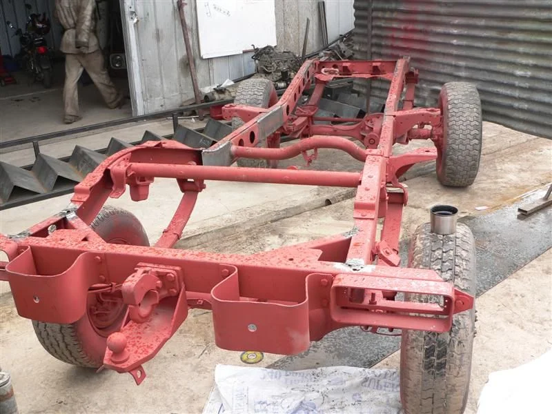

I sandblast the chasis and repair some rusted sections. also I bougt 4 Bilstein 5125 14.3"

thats one hell of a trailer hitch

More Pictures

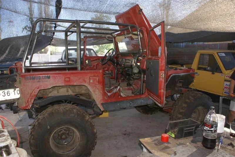

The engine is ready and it starts , steering is ready too, I userd a Toyota Hilux IFS steering box, and I will Install a Trail Gear Rock Ram.
The bodie is mounted on poliuretane body mounts.

New pics...
The roll cage is ready,
__________________
1985 TLC FJ60, 2F TBI
1984 TLC FJ40 TSL 16/38.5, 4.88, Full Floater Rear, Powertrax No-Slip, ARB Front.
flozano is offline   Reply With Quote
Old 11-17-07, 08:14 AM   #27 (permalink)
Forum Regular
flozano's Avatar
Join Date: Sep 2003
Posts: 64

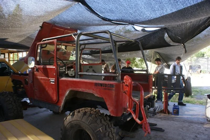

more pics,
now we start with the fla fender and rock sliders.

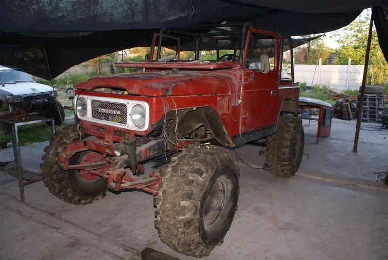

Updates...
