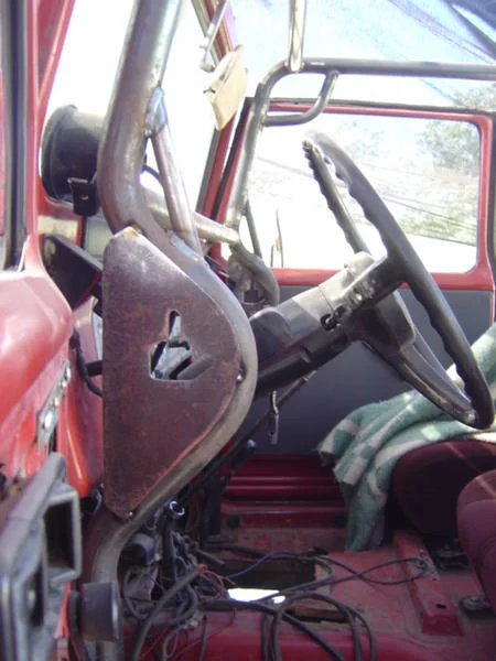

Old 12-21-07, 04:33 AM   #36 (permalink)
Forum Regular
flozano's Avatar
Join Date: Sep 2003
Posts: 64

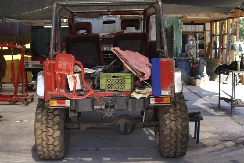

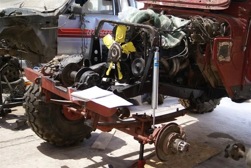

New Pics...

Old 12-21-07, 04:36 AM   #37 (permalink)
Forum Regular
flozano's Avatar
Join Date: Sep 2003
Posts: 64

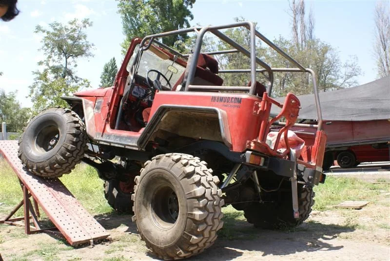

more pics...

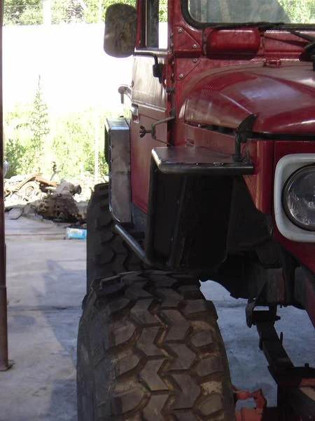

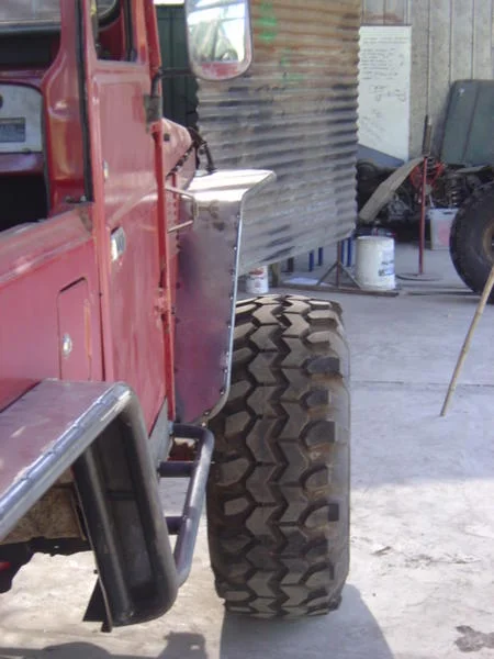

I really like the f&r tube fenders! great idea to tie it all together like that.

Facu .. your proyect it's coming better !

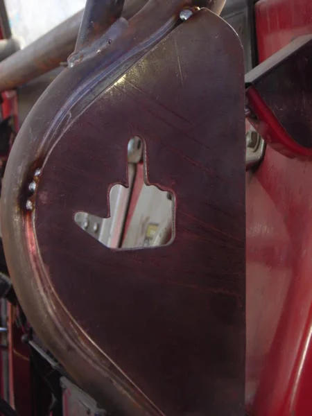

That front hoop insert with the pretty finger is sik! Great idea .

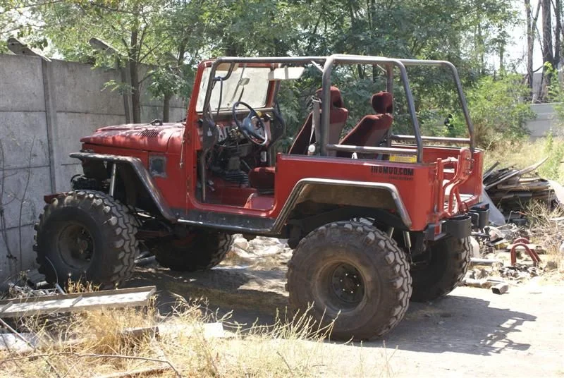

Old 12-25-07, 07:29 AM   #42 (permalink)
Forum Regular
flozano's Avatar
Join Date: Sep 2003
Posts: 64

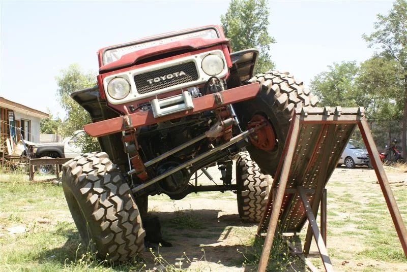

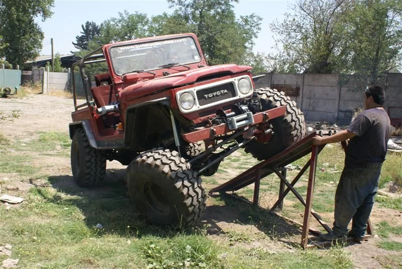

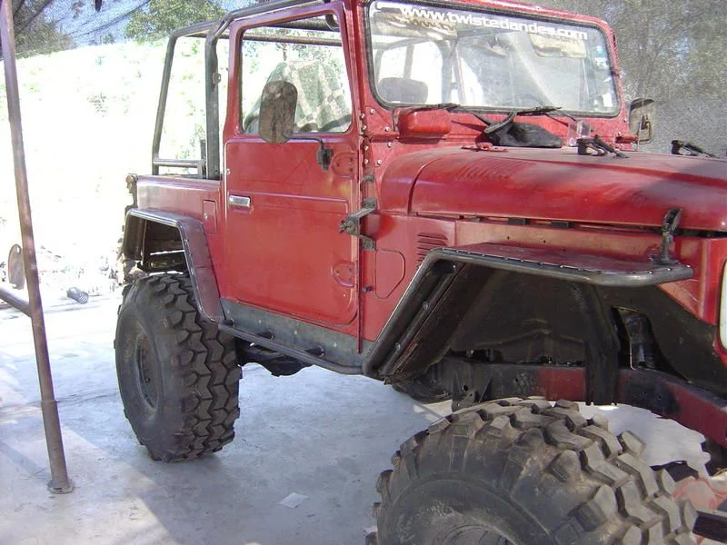

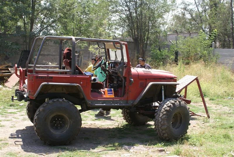

New Pics

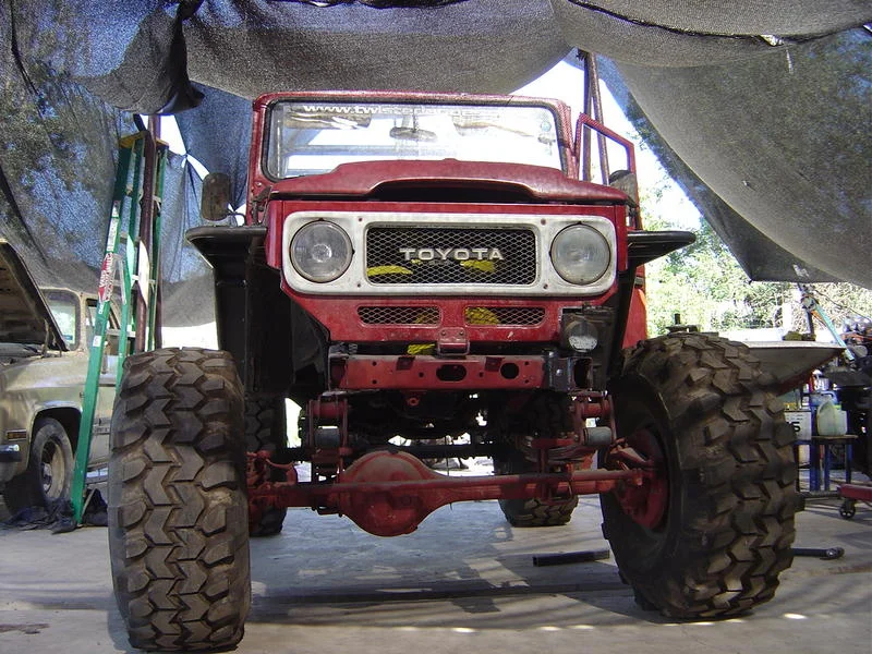

Old 12-25-07, 11:43 AM   #43 (permalink)
Forum Regular
Join Date: Dec 2007
Posts: 17
First off sweet build man. One thing i would rethink is the rear revolver. They are great on the RTI ramp but for braking and steep downhills they unload and makes things a little interesting. I would invest in some nice springs and set a good shackle angle and skip the revolvers. Just my .02 though. Nice work
82 Toy is offline   Reply With Quote
Old 12-26-07, 01:01 AM   #44 (permalink)
Forum Lifer
1973Guppie's Avatar
Join Date: Jan 2003
Location: San Diego, CA
Posts: 2,982
I really like the way you did the rear fenders, question for you, do you plan on bracing the rear fender into the frame so that if it takes a hit from a rock it won't distort the fj40 tub? I would think that it would help greatly to have it tied into the frame at 2 places on those rear fenders, thanks! Noah
__________________
NEED A CRUISER MECHANIC?:http://forum.ih8mud.com/ca-san-diego...rlsbad-ca.html
Front disc brakes: http://forum.ih8mud.com/showthread.p...+brake+dummies
1973 FJ40 - Finished! Vortec/NV4500/ARB's/SOA
1970 FJ55 - Restoration project, 1996 FZJ80 - DD
FJ55 Restoration Thread: http://forum.ih8mud.com/fj55-iron-pig-preservation-society/102079-guppies-fj55-build-thread.html
FJ40 ROTW: http://forum.ih8mud.com/showthread.p...uppie%27s+fj40
1973Guppie is offline   Reply With Quote
Old 12-29-07, 01:10 PM   #45 (permalink)
Forum Regular
flozano's Avatar
Join Date: Sep 2003
Posts: 64

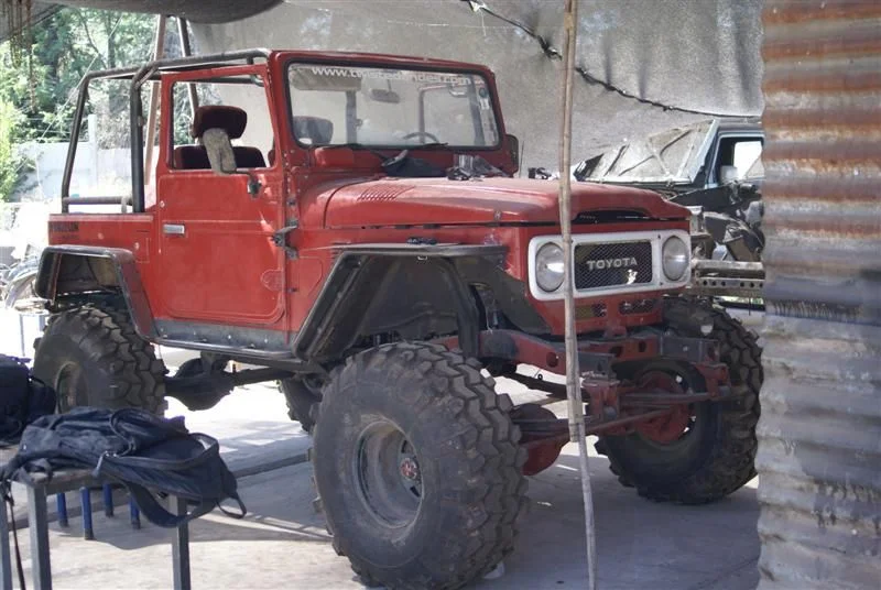

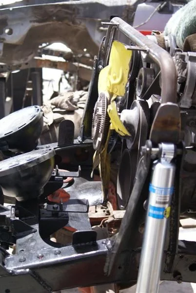

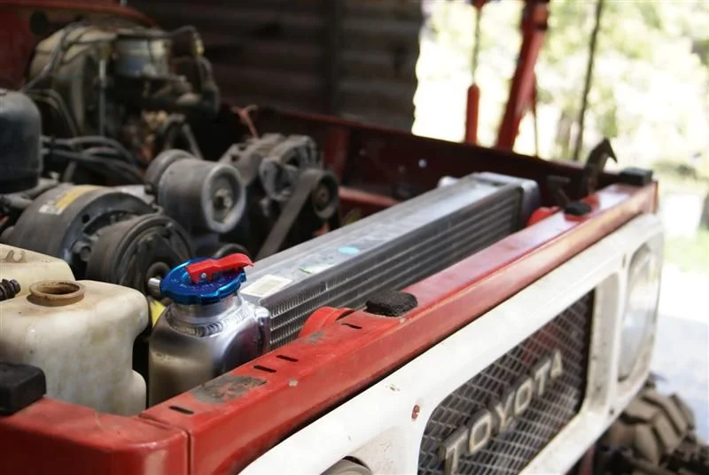

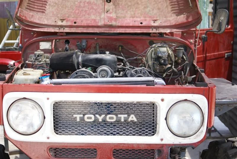

New Pics...

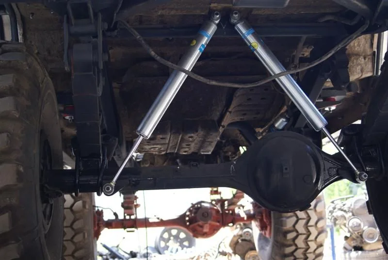

The rear shocks are ready and installed.
The new radiator was arrived today, I need to make some mounts, but fit perfect, is a griffin aluminium radiator.
__________________
1985 TLC FJ60, 2F TBI
1984 TLC FJ40 TSL 16/38.5, 4.88, Full Floater Rear, Powertrax No-Slip, ARB Front.
flozano is offline   Reply With Quote
Old 12-29-07, 01:19 PM   #46 (permalink)
Site Addict
fj40forlife's Avatar
Join Date: Dec 2005
Location: Orange County
TLCA# 5624562435
Posts: 1,278
you bent the u bolts? For the shock? Could you mount it higher and so it doesnt get hit by rocks?
__________________
What is rock crawling? 2 FJ40 on 60s
My build http://www.pirate4x4.com/forum/showthread.php?t=637144
fj40forlife is offline   Reply With Quote
Old 12-29-07, 01:59 PM   #47 (permalink)
Forum Regular
flozano's Avatar
Join Date: Sep 2003
Posts: 64
Quote:
I can't mount higher the shocks, I'm planning to lowering all the TLC 2"
__________________
Old 01-03-08, 11:43 AM   #48 (permalink)
Forum Regular
Join Date: Jan 2006
Posts: 203
where did you get that air cleaner?
76 PTO is offline   Reply With Quote
Old 01-03-08, 12:11 PM   #49 (permalink)
Forum Regular
flozano's Avatar
Join Date: Sep 2003
Posts: 64
eBay - New & used electronics, cars, apparel, collectibles, sporting goods & more at low prices
and the filter is K&N
__________________
Old 01-03-08, 05:18 PM   #50 (permalink)
Forum Regular
Join Date: Jan 2006
Posts: 203
do you know what vehical that is for? Is it a tbi car ? I 'm looking for a air cleaner like that for my 93 tbi with dual studs.
Old 01-03-08, 08:04 PM   #51 (permalink)
Forum Regular
stevecast's Avatar
Join Date: Jan 2007
Location: west covina CA
Posts: 31
like the fenders on ur tlc
__________________
holy crap i am surrounded by jXXps
stevecast is offline   Reply With Quote
Old 01-04-08, 06:57 PM   #52 (permalink)
Forum Regular
flozano's Avatar
Join Date: Sep 2003
Posts: 64
Nice Fenders..
Do you have more pics?
__________________
Old 01-05-08, 04:17 PM   #53 (permalink)
Forum Regular
flozano's Avatar
Join Date: Sep 2003
Posts: 64

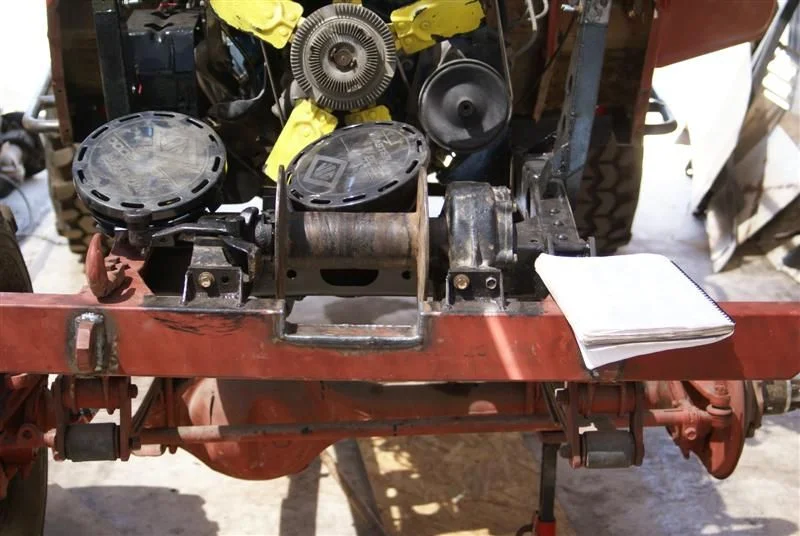

New Pics
The PTO Winch mount is ready, and Front Tower Shocks and radiator mount too.

Nice shocks Facu.. few $$$$ on it ..

interesting, I would have welded a plate on the rear spring hanger, lots of torque on the frame there.
Looks good, can't wait to see more pics, so i can get some ideas of what to do to mine.

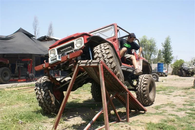

New Pics.

FFFFF antastic ! more pics in the ramp !

Quote:
As your wish...
__________________

Great job dude .. great great job .. well now you have a nice video compromise with us .. just to let us know are not only a ramp truck !
