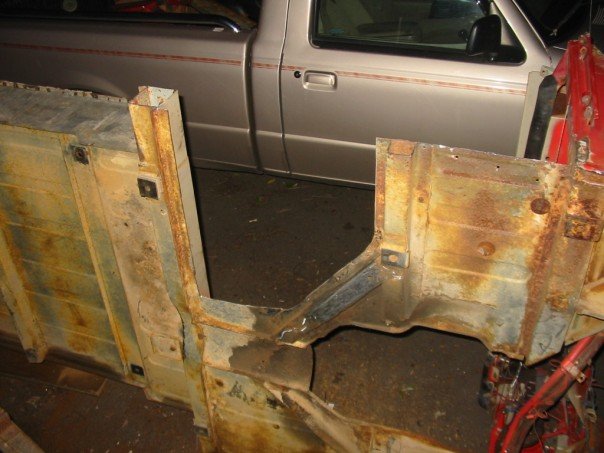

well...just got off the phone with the welding supply co here in nashville.
it'll be tomorrow morning before i can get my tank back for the welder. i ran out of gas about 6 tack welds into the sunday afternoon scheduled work :angry:
dropped the tank off this morning before work and apparently it's a funny size/shape? i thought it was just a normal 40lb tank...guess not as they didn't have any to exchange and i have to wait for it to get filled.
yesterday i did get to work on the wheelwell top piece. cut it all out of 16 gauge (i think that's what is, maybe 14...i got a 2'x4' drop from the steelyard for 10 bucks) and am about to go get the lips bent up on the pieces at my building's machine shop.
i'll hopefully get some pictures tonight and post up.

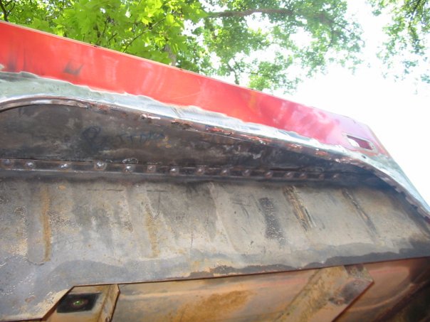

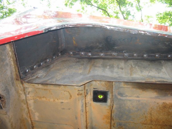

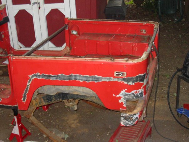

aight...slow progress, haven't been able to put in much time this week, but got some more gas for the welder yesterday
got the top of the wheelwell in:
and the quarter panel reattached to the rear sill...

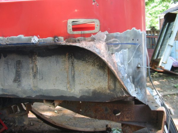

got some more work done this morning, so i figured i'd post it up while i'm eatin lunch

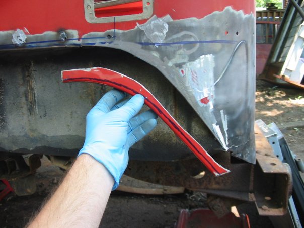

started the comp cut on the fender:
i decided to use the old lip of the fender to keep the flow of the original lines and also let me keep a clean lip on the fenders so i don't chotch up my tires if they rub.
for the straight parts of the fender i just cut an 3/4" overhang, drilled out holes for spot welds, then beat it flush with the bottom of the wheelwell, and then welded it up.

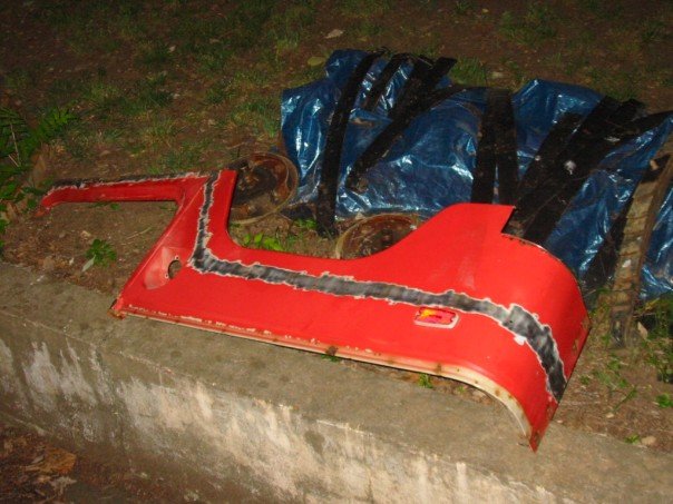

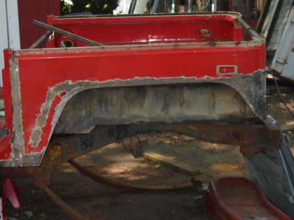

here are some finished shots of the cut and lip
a couple good shots of the lip and of the spot welds

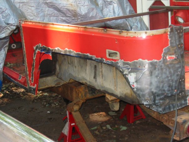

here's a side shot of the finished product:
before:
after:
also, thanks to dieselcruiserhead... while readin thru his awesome build thread i saw where he welded tabs to his fabbed firewall so he could move it around. i stole that idea and have been welding tabs to sheet metal on the cruiser that is hard to get a good ground clamp on...so then i can just clamp on the tab.
that's it for a bit, i'll be back at it after lunch. hope to get the passenger side cut off and started so i can just repeat the process and finish up this part of the build.

got back out to the cruiser after a couple of days hiatus...me and the roommate have got a solid weekly poker night on tuesdays and summer ultimate frisbee league on wednesday nights.
got the passenger side all cut off. hopefully i can get the passenger side done a bit more efficiently since i know what all the tricky parts of the process will be.
here's the passenger rocker and quarter
what's left of the tub after i cut out the rocker, quarter, wheelwell, and tank depression:
i cut out the tank depression for a guy here on the board for some rust repair...i had to get rid of it anyway b/c when i pull the door frame in at the b-pillar on this side i need a flat floorboard to attach the inside rocker to...
i am realizing that the all the pictures i am goin to take over the next few days are just goin to be mirror images of the stuff i've already posted, so unless there is something cool or new that happens i'll just post up the finished product when i get it done.
malphrus
