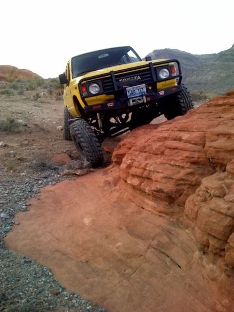

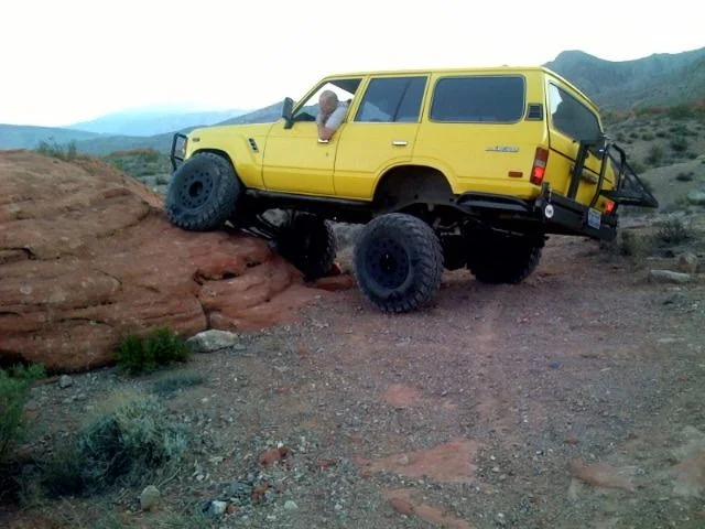

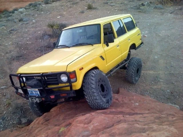

Took the rig out for a test run last night. Ran very well & the low gears are AWESOME! I still need to build an anti-wrap bar, redo my york system to operate the front arb, build some bump stops & few other things. I think I'm going to bend the wraps over on the rear springs, since at droop it puts alot of stress on the main leaf. bump steer sucks, I have to figure out a high steer setup. I climbeb a 3' calleche ledge & bent my front fender up. Here's a few poser pics:

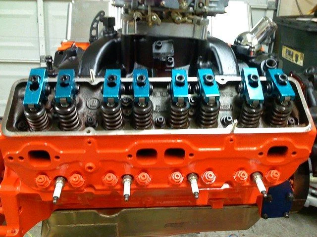

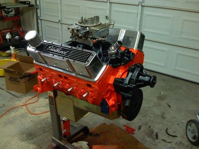

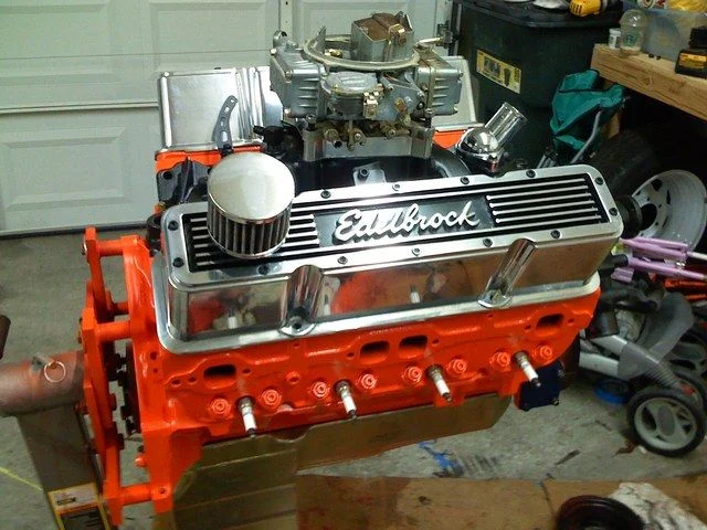

In case anyone is interested, about 6 months ago (& 30 miles after the build) the TBI350 developed a loud tick in the valve train & started running like crap. I tossed up a 4bt or 6bt conversion but after driving a chipped Duramax for the last 6 months I need some real power without the monster drivetrain & frame eating torque. I picked up a Built 385 stroker last Saturday (see pics below)
My plan is to run a 454 TBI & modified EBL ECM tuned to be able to pass smog & hopefully have close to 400hp & 440tq. It has tons of goodies in it & I got a great deal on it. The cam is pretty big but hopefully with the EBL it will be tunable.
Once that is done I have to address the steering & trim the fenders to accept some larger tires.

Oooo roller rockers
I think you are gonna need those tall valve covers....

I can get away with standard valve covers with the rockers if don't install girdles. It looks like the tall one will clear the a/c with about 1/4" to spare

Update...
The new stroker is bolted in with all of the goodies. I only need to redo my fuel lines & relocate the knock sensor. Then I need to save up for the wideband O2 and new ECM. I should be firing it this weekend.
