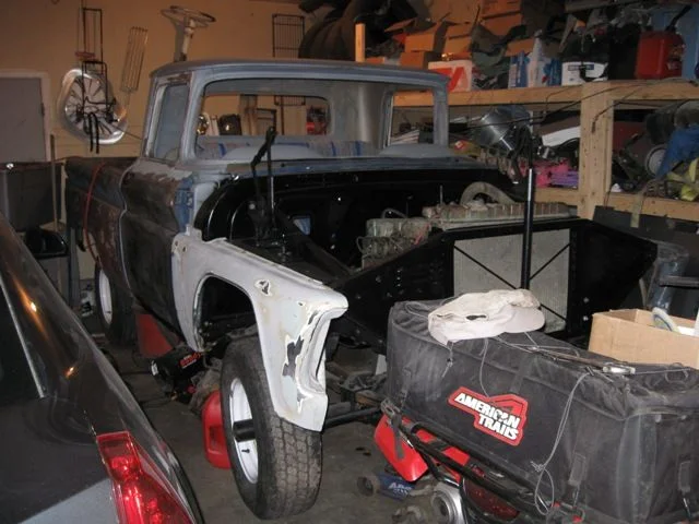

I always wanted one of these it's a 63 chevy half ton 4x4 short wheel base. I worked for a farmer when I was a teenager and he bought a new one, was the first new truck I ever drove. Thought I would share. Got the new frame blasted and POR 15ed, it's out in the snow, the cab is nearly finished some minor body work and paint and it goes on the frame, then I can strip the doner start work on the mechanicals.

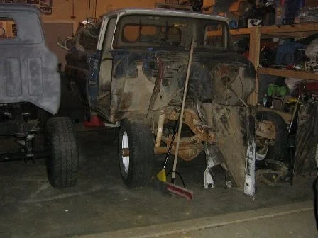

More progress

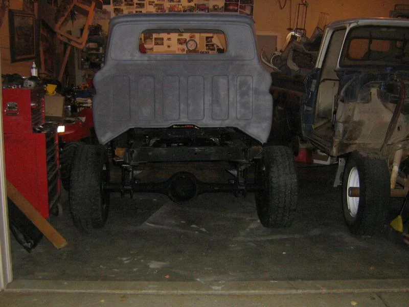

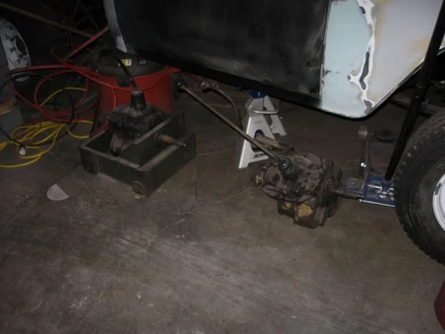

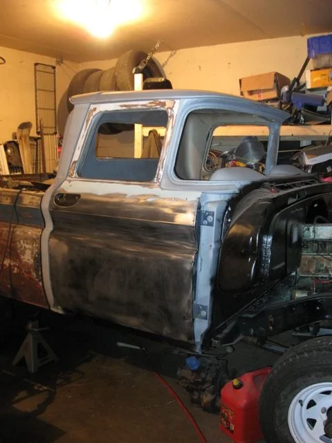

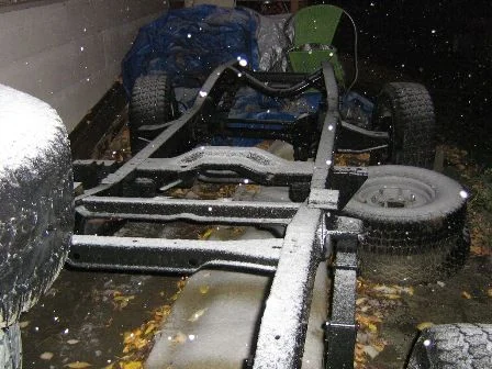

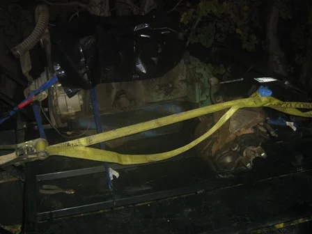

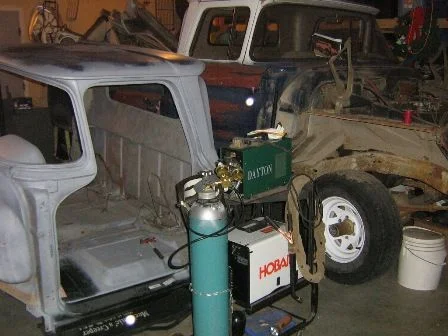

Got the cab on the frame, pulled the engine and tranny out of the donor, removed some of the parts from the frame on the donor truck time to prime sand and paint the fire wall and the interior.

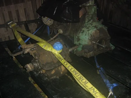

A few more shots

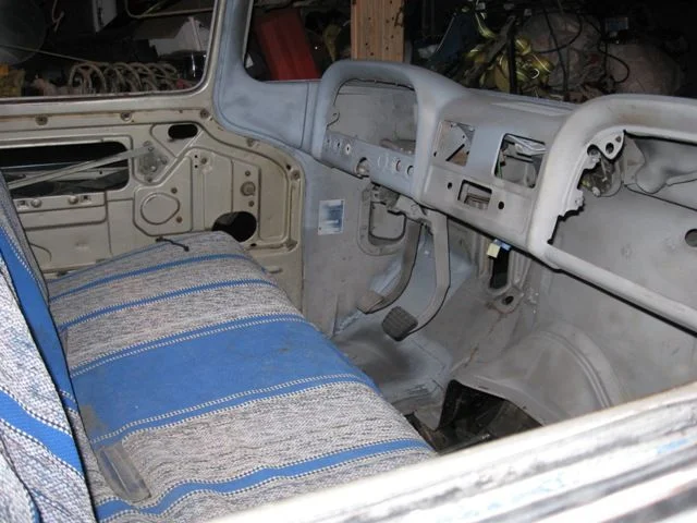

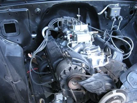

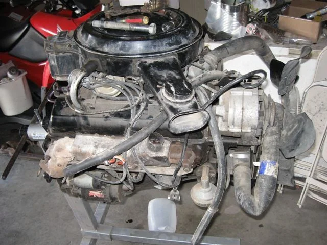

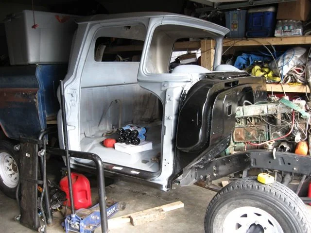

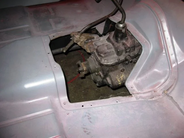

Pulled the 292 and the sm420, took them down for a cleaning, the engine had great compression and good oil pressure so I'm going to use it for a while, the tranny had no shavings and the oil looked great, I'll take off the inspection cover later and see how the insides are. I have another all rebuilt may have to use it, Larry

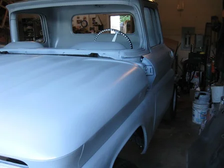

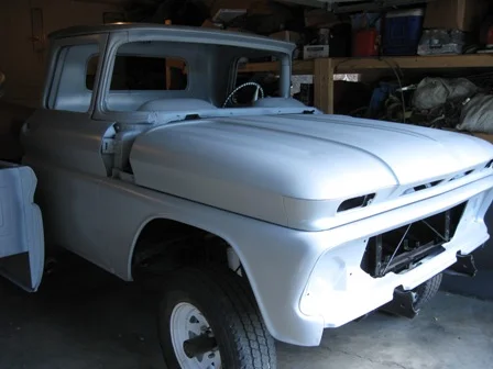

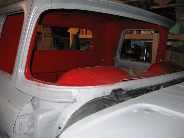

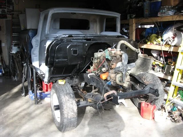

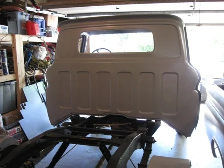

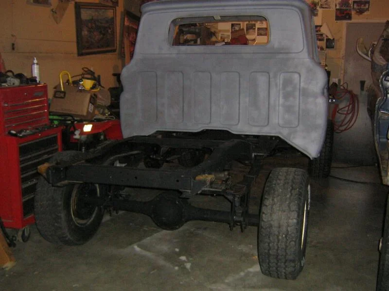

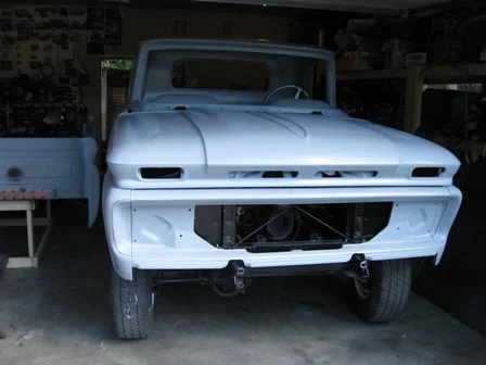

Have done some work, finished the body work on the truck cab, bed yet to go, I rebuilt the drive lines, installed the transfercase, new pinion seals, rebuilt the brakes, getting ready to install the engine and tranny usisng the engine to get the motor mounts right, next body work on all the other sheet metal and paint. Put in the PS box as well.

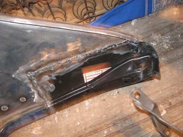

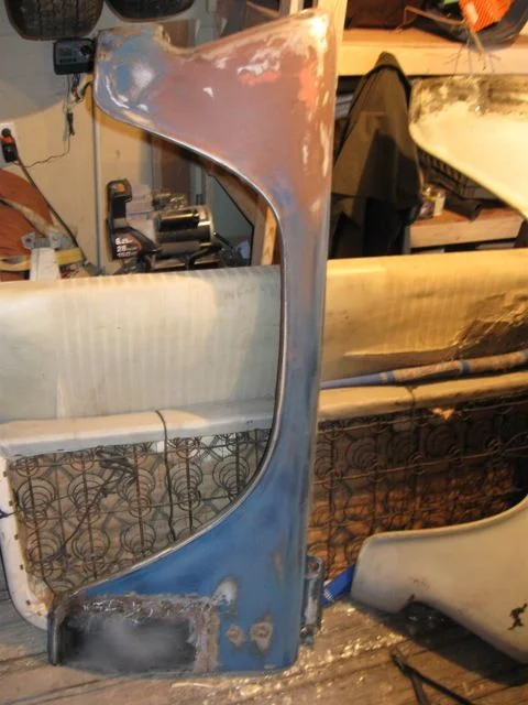

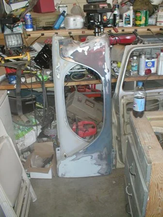

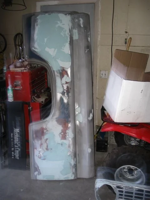

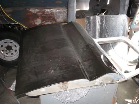

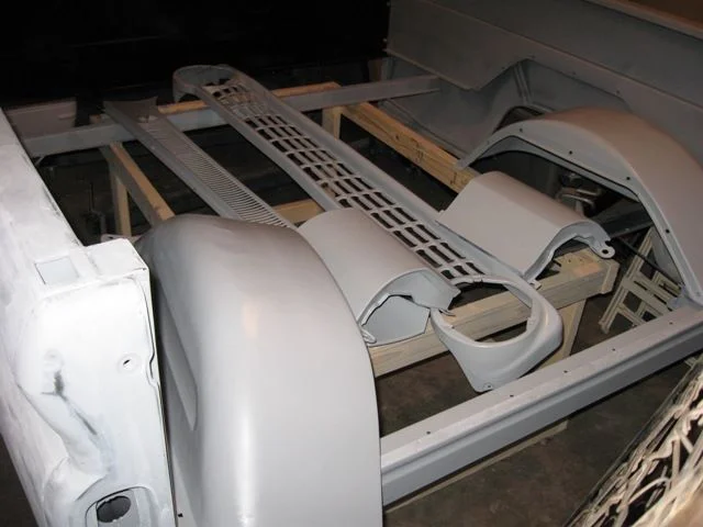

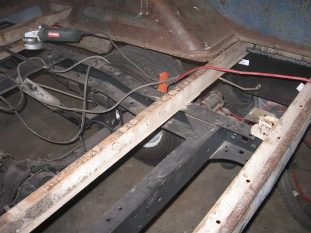

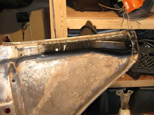

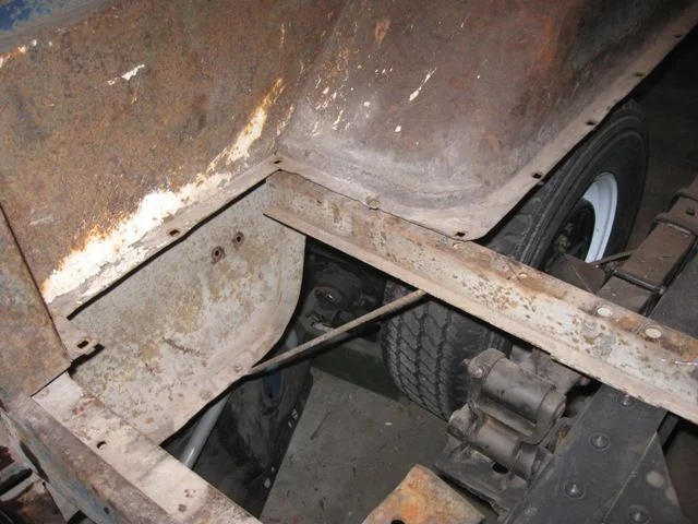

Worked on the fenders yesterday, patched some holes and replaced partof the rear braces on the fenders, a little filler then roll on primer then block it and start on the doors and the hood.

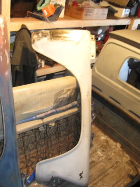

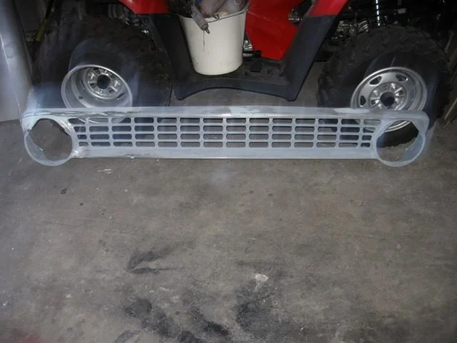

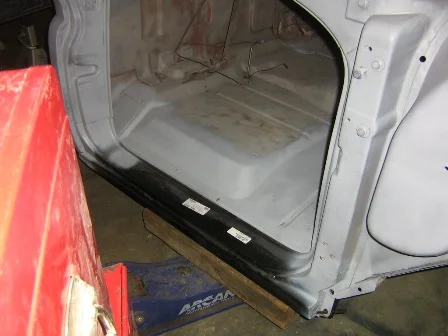

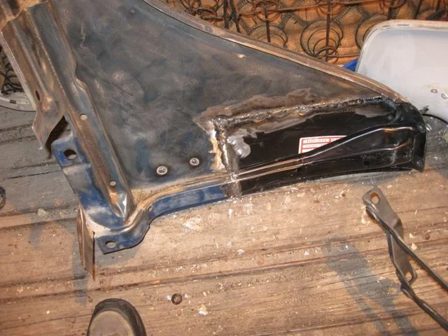

I finished the body work on the fenders ready to prime, rebuilt the carb and new fuel pump, re-did the brakes drive lines and the diffs, started the bed side, patched the lower rear and next week I'll reskin the doors.

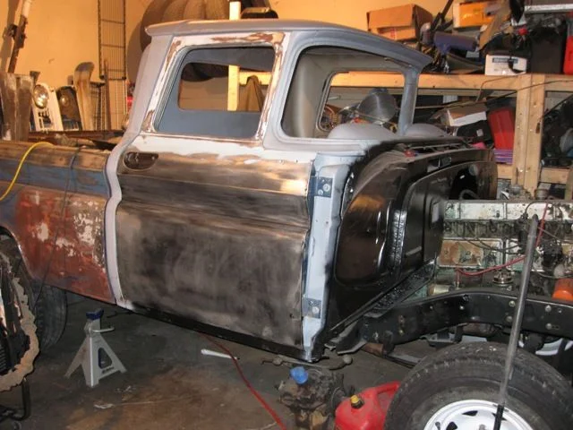

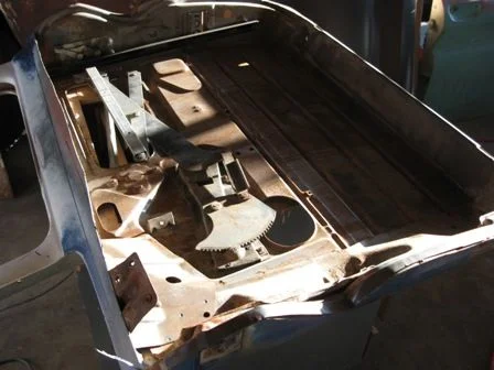

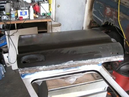

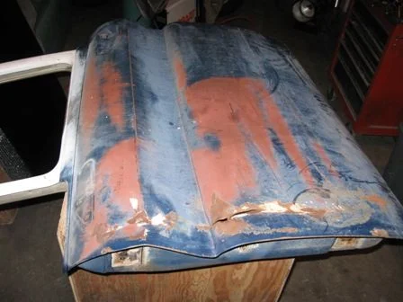

Door Skins on the driver door not too bad.

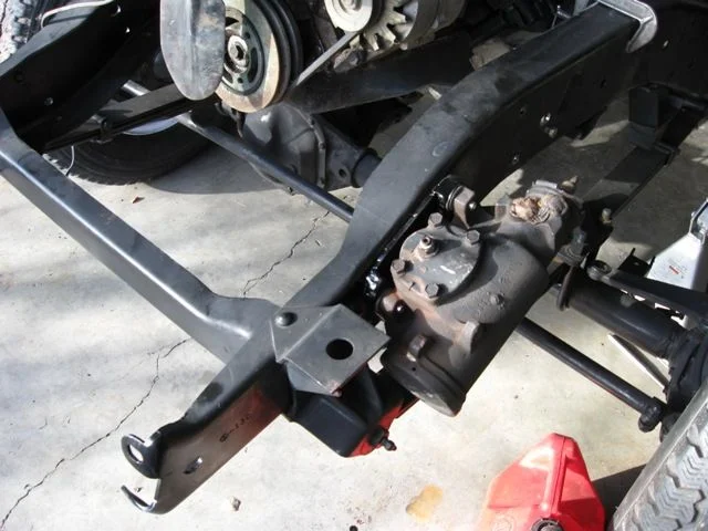

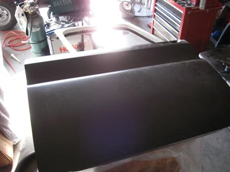

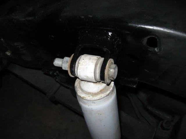

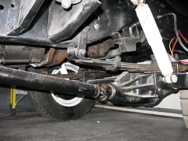

finished the doors and some front shock mounts, ready to prime and block.

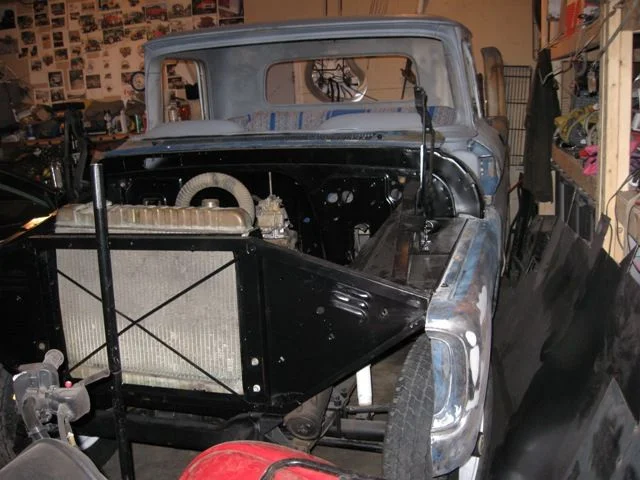

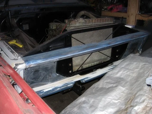

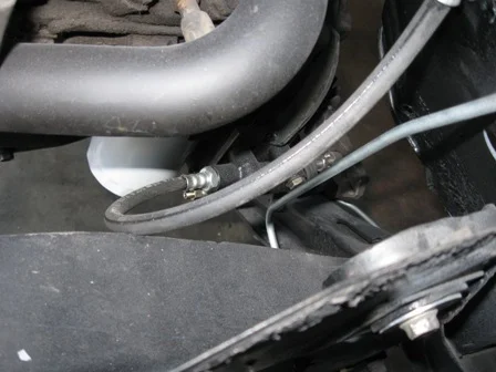

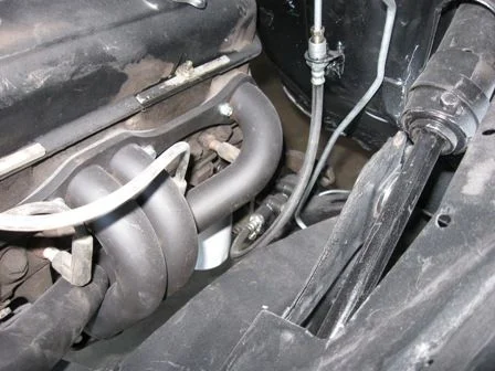

I replaced some of the bracing on the radiator and the inner fenders, painted them and hung them on the truck with the fenders so I could see where the doors might need to go. Started to grind off the bolts on the old bed strips to get rid of the old wood as well. I stuffed the seat in for storage it's going to snow and my wife wanted to put her car in the garage. I also wanted to sit in it just to see what it was like. More later, cheers, Larry

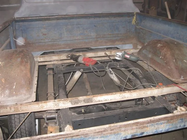

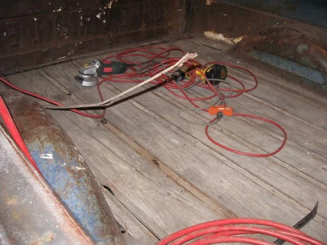

Got the bed wood all removed.

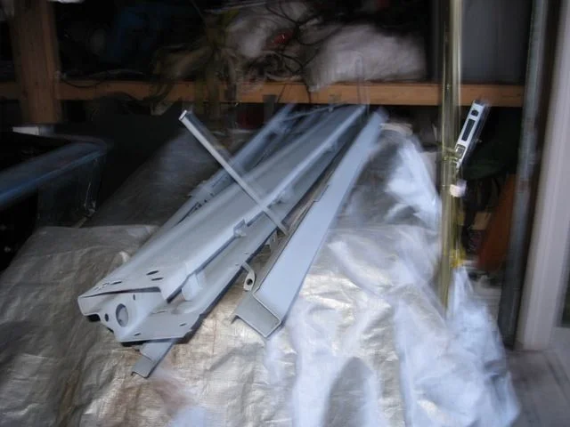

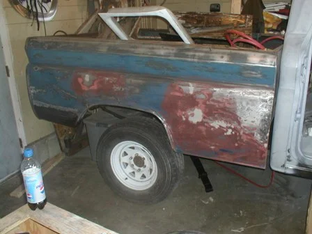

I got the bed parts sandblasted so their ready to go I did some work to clean the old paint off the hood, got it from a guy who was parting out a 66, I started the work on the bed sides but the passenger side is kind of crappy so I'm trying to find a new one, I found one on a trailer on an old homestead but getting to the owner is a challenge, I have been cleaning up the grill as well, should be good to go soon. More later

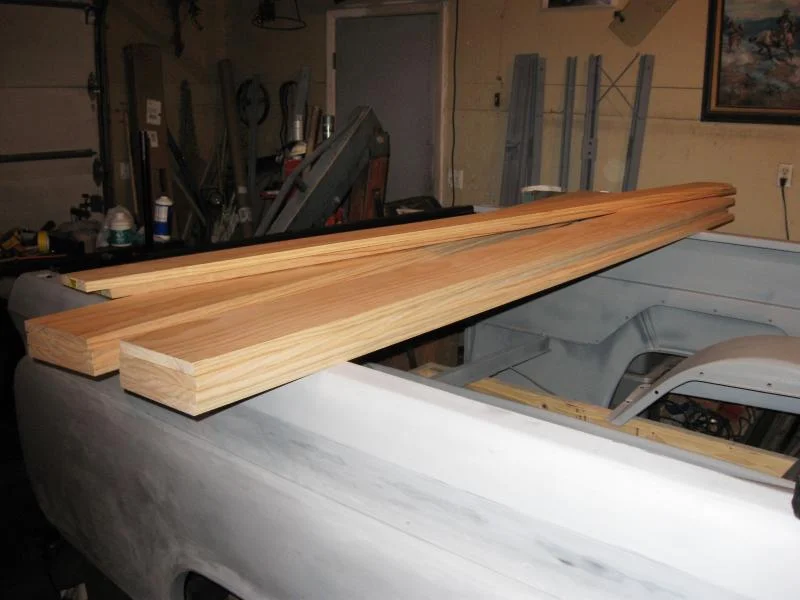

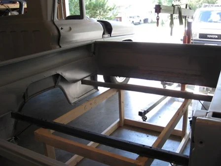

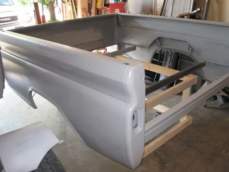

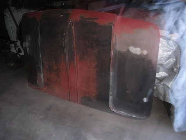

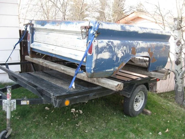

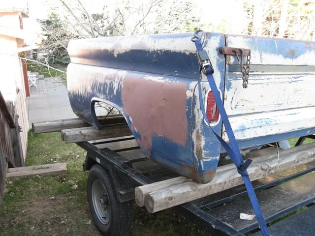

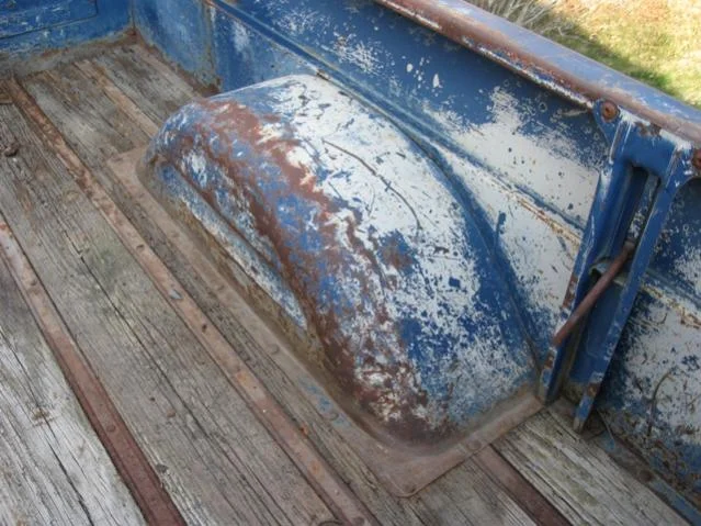

I tried to make the bed I had work but it was in too tuff of shape, I was passing an old homestead the other day and saw an old fleet short bed on an old trailer, it took several weeks to track the owner down and the short story is theut gave it to me, nice, I also bought an chevy engine for the truck, pic's included

Old 06-21-09, 08:36 AM   #26 (permalink)
250+ Club
brew8's Avatar
Join Date: Apr 2004
TLCA# 7165
Posts: 877
Update
It's been a while since I posted to thei project so here is an update, I finally finished most of the body work and sealed and sprayed some high build primer this week so it's finally looking like a truck, I modified the steering column it's too long for the power steering so I shortened it, I also had to convert to a hydralic clutch so I bought the advance adapter bracket for a chevy bell housing and used the toyota large bore slave, I think it will work fine, I'll paint the interior in the driveway and take it to the paint booth for the rest after I assemble the mechanicals, pic's to follow, cheers, Larry
__________________
Larry Brewster, TLCA 7165, Billings, MT
Cares may come and cares may go but I have ceased to worry.
My ROTW http://forum.ih8mud.com/40-55-series...otw-brew8.html
brew8 is offline   Reply With Quote

More Pic's
Here are a few more body shots

Posts: 877
Here some pic's of the clutch and motor, I ordered some rams horn manifolds the block huggers are going away.

Brief update
Painted the interior so I could assemble the mechanicals, rebuilt the front drive line, splines were bad, someone dipped them in some blue plastic to take up the slack, the thing would not even move, the shaft between the tranny and the divorced case is in to be lenghtened, I moved the small block foreward and had to change it to match, I am putting U joints on the steering column to make it work with the slightly offset steering box. I also bought the wood for the bed today I need to cut it and make the groves in it for the bed strips and drill all the bolt holes before I paint the bed and finish the wood. should be fun. I have to paint the steering wheel before assembly and wiring so we will se how that goes, I also rebuilt the seat springs and ordered a pad kit for a upholstery place should be fun as well, more later, cheers, Larry

few more pic's
more of the same
