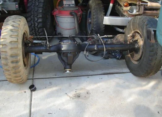

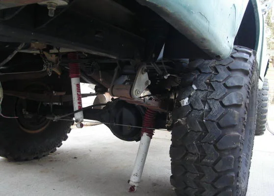

so shoot me now. i haven't even driven my piggie and today, i yanked out the rear axle i just rebuilt last year...to put in a rear axle. an fj60 axle no where near done with the install. need to get it exact in it's local, mod a brake line/fitting, notch the old spring perches for ubolts, weld the new perches and hook everything up.
the front needs to be cut and turned and i need to install the outboard kit i got from jeremiah
someday i'll get to actually drive it instead of sitting in the drivers seat and saying "vrooooom"

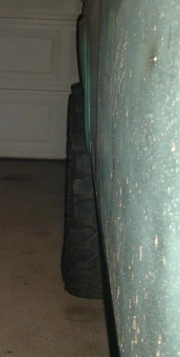

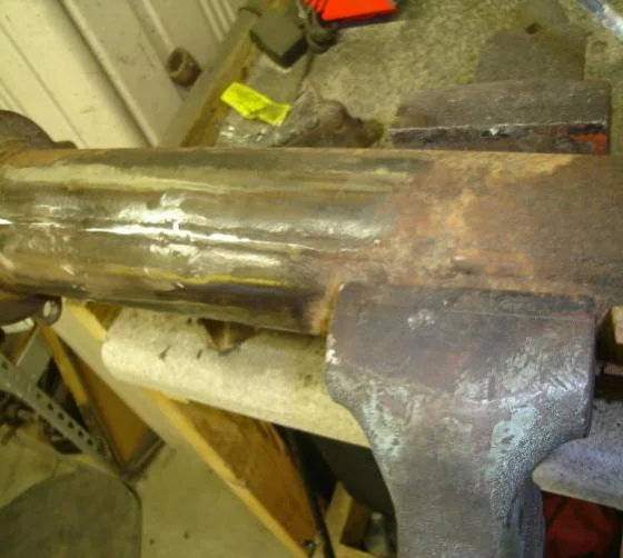

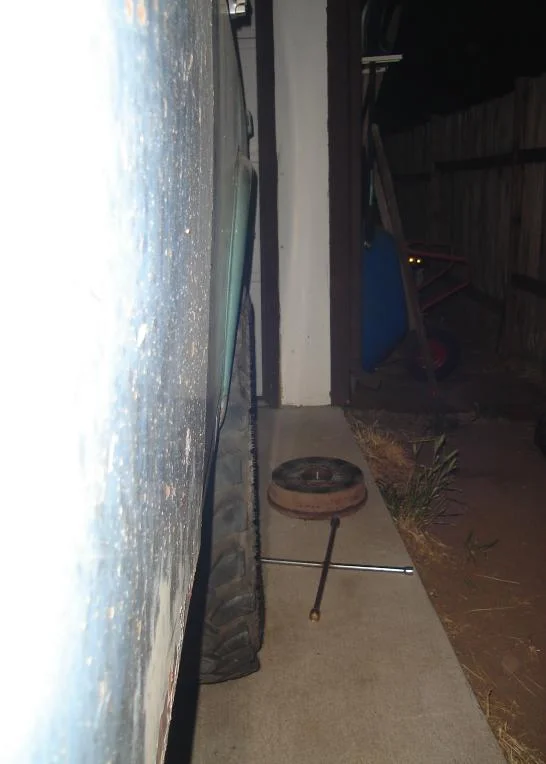

don't know if i think it's worth it yet...i don't see that much of a difference

just spent time with 'root analyzing the swap and i guess it does fill out the fenderwell better. we compared it with the pic i posted in the photos thread here. it seems the old axle left a hare of the flared out section at the top overhanging, whereas the 60 axle runs the tire out to the edge.
i'm kicking myself for not getting comparative before and after pics.

seems like a lot of work for an inch of width on either side... what is the actual difference in width between the two axle housings? any other benefit to going with the 60 vs. the 55 housing?
about 3" over all on the width. you do get the e brake relocated to the wheels and they are "self adjsuting"

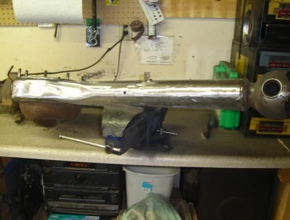

ok, now that it's been forever since i started this, i finally got some more work done.

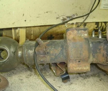

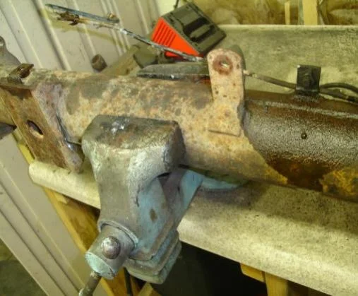

while i've had both axles, i had put the rear under there to keep it out of my way, sell the old axle and drool a bit.
in the meantime, i acquired another 60 housing for free, so i decided to clean that one up (the one under the cruiser now is literally just sitting there, i haven't even cut the old mounts off yet).
so, the last couple of weekends (had to stretch it out to two weekends because i ran out of cutoff wheels and grinding discs) i got the front housing and the extra rear housing completely cleared of all mounts and cleaned up. i mean everything came off the front and all that's left on the rear are two mounts for the ebrake cable.
here's what i started with two weekends ago...can't say i didn't get my use of the grinding wheel

is was how they looked that night. last weekend, i got the last few mounts off and finished cleaning everything up. since i know myself and that it will be months before i actually get any welding done, i rattle canned them for now.
btw, i would suggest a plasma cutter before ever doing this again
