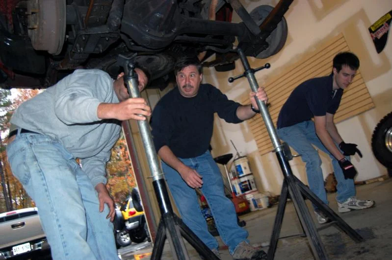

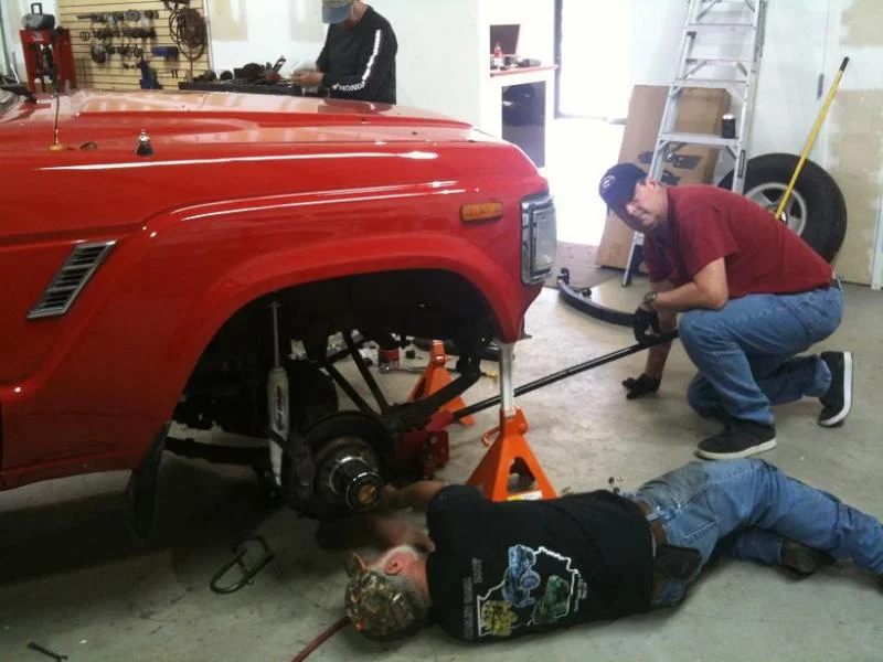

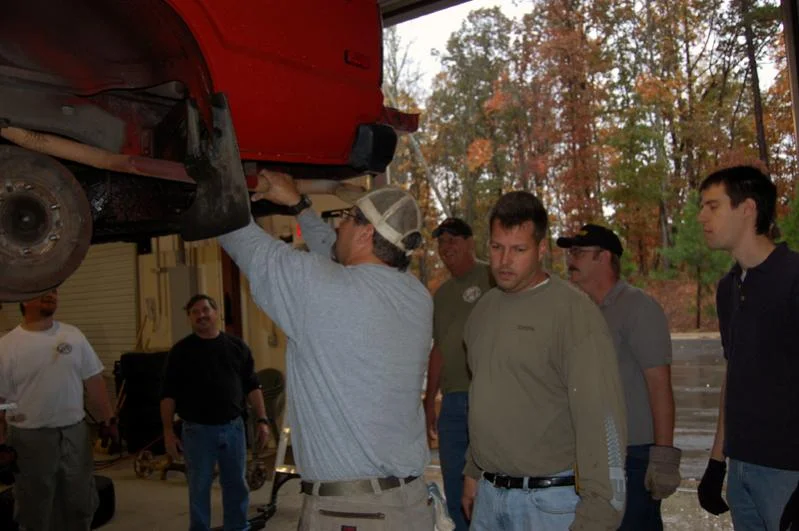

Had a great crowd today. Included Brian, Dave Logan, Nick, Downhill, Sylvain, Thomas, Dowlen, Tom, Andrew, Tom, Ben, myself. Thanks Guys for showing up.
Thanks again Justin (Offroad Outfitters)
We got one set of springs on, the fronts will be in this week (crossing fingers) and the Sliders should be on the way and scheduled for installation next weekend.

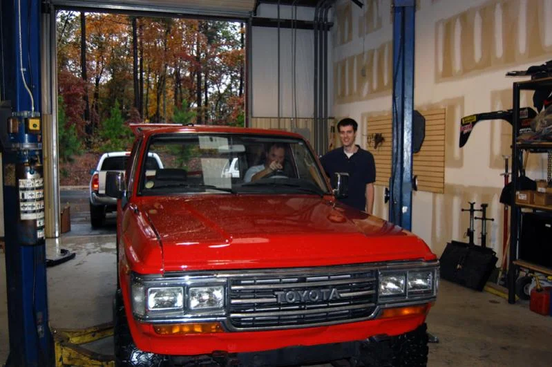

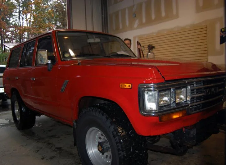

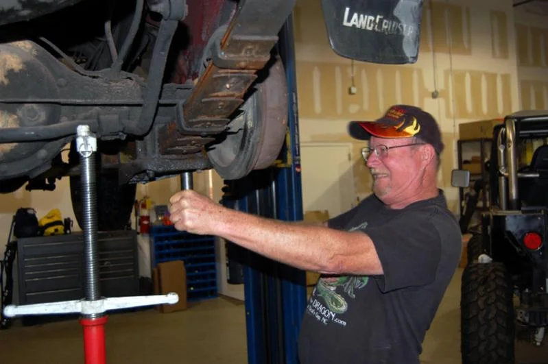

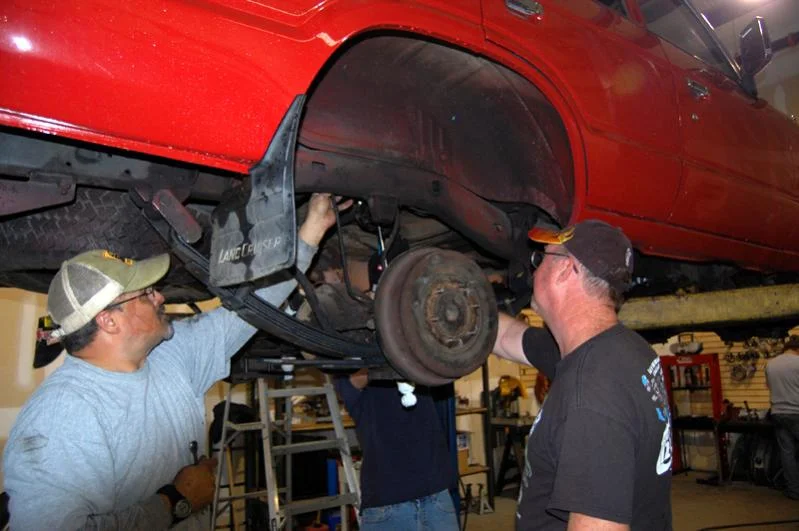

pics
a few pics

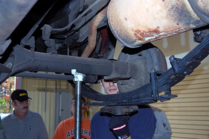

more pics

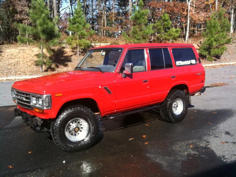

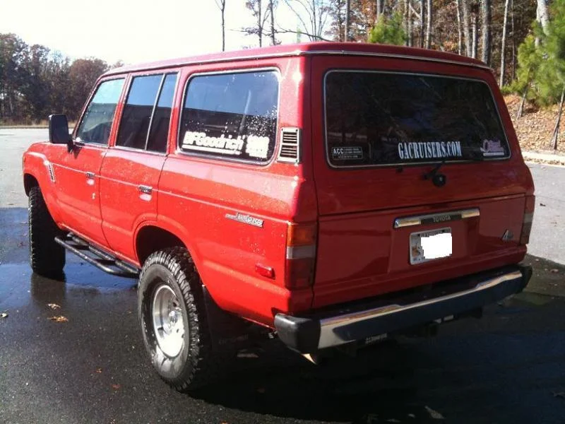

even more pics
sorry cannont figure out how to add more than 3 at a time

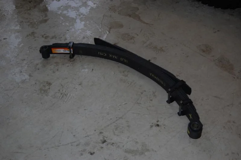

Did you guys get shackles with the lift kit? In the last picture it looks like a new spring and an old shackle. I am almost sure that OME recommends that you at least use their anti shackle inversion kit if you want to use the stock shackles. Either way we always replace shackles w/ OME springs.
Oh and you will want to grab some longer sway bar end links (Auto Zone carries the energy suspension links) that will work for the front but the rears will need to be cut, sleeved and welded.

They were on the list of needed parts. I thought that they were one of the things that were going to be purchased. You really should put new shackles on with those springs, I agree with Michael.

Major hurdle taken care of this weekend. Solid Rock Offroad sliders installed and OME Front heavies also went on. Truck looks fantastic!
Name:  Cell Pictures 063.jpg
Name:  Cell Pictures 067.jpg
Name:  Cell Pictures 055small.jpg

A few more:
Name:  Cell Pictures 045small.jpg
Name:  Cell Pictures 058small.jpg
Name:  Cell Pictures 051small.jpg

Attachment 369698
Why are ya'll making the old guy lay on the ground?
The truck looks great guys. Sorry I have not been around to help. Keep up the good work Ted.

Quote:
Sid
for the same reason you finish the beer in your hand, you kill the old one before cracking open a new one.
