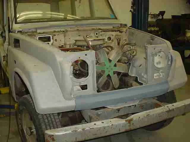

The piggy runs but the engine/carb need work. She had been sitting for awhile. The quadrajet doesn't seem to have anything beyond the idle circuit. The engine is a V8 chevy and when idling you can hear a backfire/exhaust leak into the exhaust x-over/EGR. The rear window doesn't roll down (extra motor/gears included), needs new tires, and rusty along the rockers. So...she is absolutely beautiful

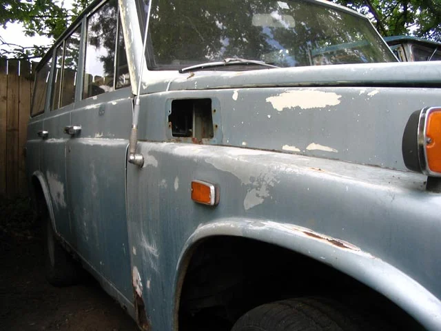

I was all set to drive out to CO to pick up the pig. I was really looking forward to wheeling with some CO folks out there including TreeRoot, Romer and Ige. A friend talked some sense into me and got me to check into having it shipped. Some searching in the new Mudship section got me the idea of using uship I put in a bid and two days later I choose from three guys who met my bid. I can't recommend Jay or uship enough. The pig rode in covered comfort and arrived at the shop on the 6th of Jan.

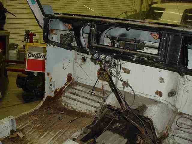

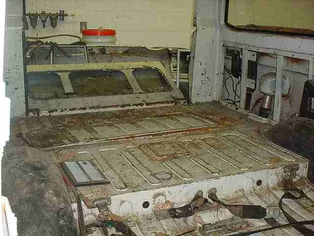

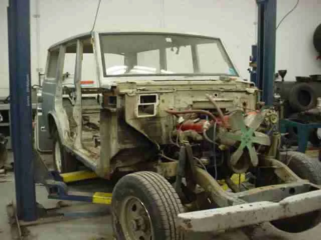

I spent the rest of the day getting it running, but never did get it to driving condition. The distributer wasn't advancing.
I ran the numbers on the engine. It's a 283, built on Nov 21st, 1964 in Flint, MI. It was in a 2 speed auto Chevelle. 2 bbl carb and 195hp gross. Some PO had put a 4 bbl intake and a quadrajet on it.
I got it running enough to drive it on the hoist and started to disassemble it.

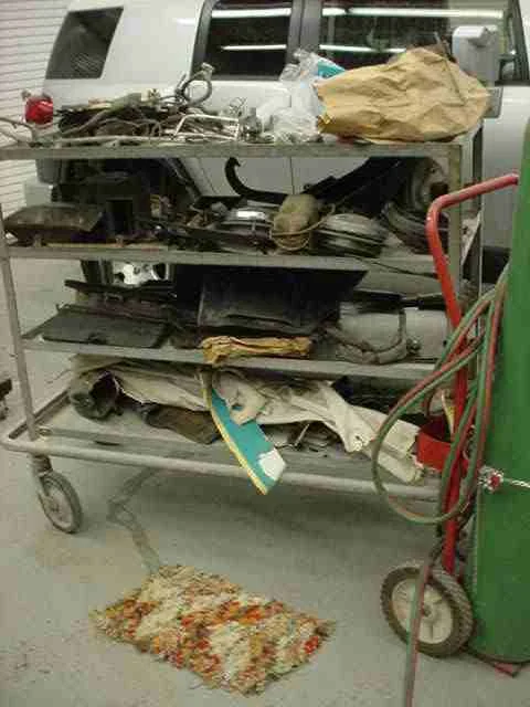

Dig the carpet scrap.
How many parts can you identify?

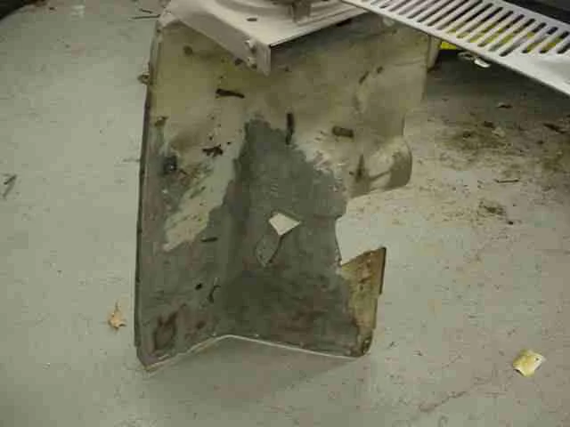

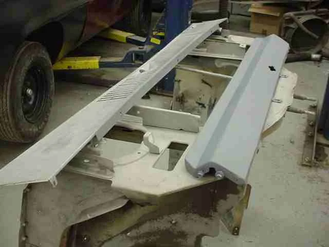

Yesterday i bought a pressurized sandblaster and started making a mess. I did the valence under the grill, the vent in front of the w/s, some of the front clip and most of the right fender.

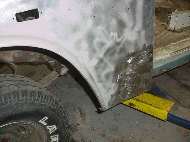

Garage

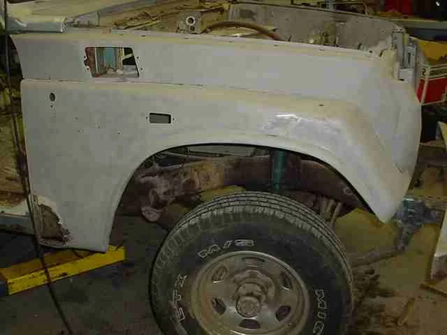

Today I went in for just a couple of hours. I attacked one of the fender lowers.
I got a before shot, but the pics of the repair didn't come out. I'll get some more of the finished repair and of the other side later. I still need to make the brace on the inside of the repaired outer skin.

#1 before blasting on the rs fender
#2 before blasting on the inside
#3 inside of the repair on the ls fender. I'm going to do something different with the brace where it comes down on the curve. The stock way leaves a pocket for gunk to fill up and rot out the fender. I think I may just double up the curve and leave the end of the channel open for drainage.

#1 Outside of patch. It's not perfect yet, but I needed a break from sandblasting, so I thought I'd get some pics and get 'em up.
#2 blasted rs fender. I think tomorrow I will show the kids how to make a patch so I left this one undone. I'll try to get a kid to take pics for a powerpoint for class and I'll post up a few.
I'm thinking I might fill in the t/s holes too. I was looking at these and they look pretty slick. http://www.4wheeloffroad.com/techart..._turn_signals/
Maybe a strip of LEDs in the little triangle pieces under the headlights.
#3 I hung the fenders and the inner clip while I was cleaning all of the blasting mess. Looks better already.
