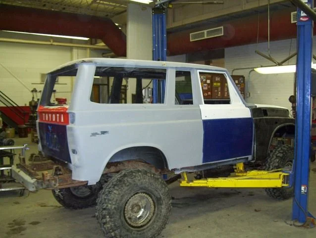

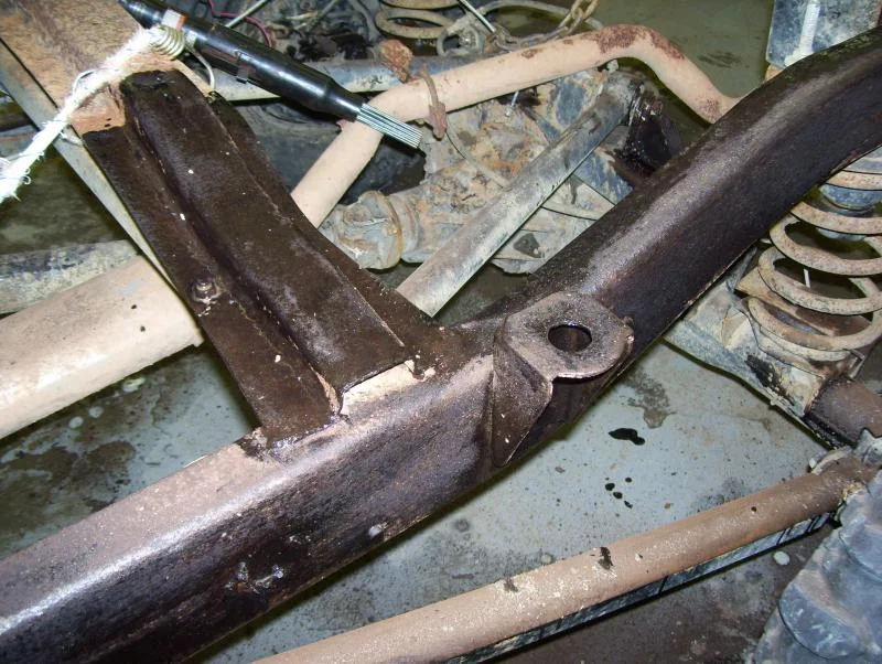

Spent a couple of hours with the needle scaler and the RustMort. Got about half of the frame looking really good. I have to yank the motor and trans to get much more, but that's not hard.
I'll come in this weekend and spray it all with epoxy primer sealer and it'll be looking good for a while. Hopefully, the nice clean paint will be easier to keep clean and easier to work on.
The old pig body is stripped. Only one major catastrophe. Rather than ask where the bolts to the uncracked dash pad were the kids just started peeling the vinyl off. Hopefully I can re-glue it if the foam hasn't been damaged.

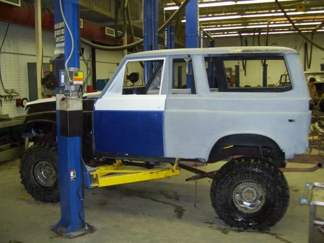

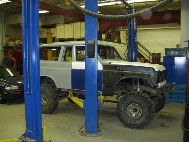

Body on the frame. I still have work to do to the frame, but I wanted them together so I wouldn't have to try and move them during winter break.
It's about an inch high in the back from where it will sit on the frame and a good 3 inches taller with the drive train out.

Got the front axle out from under the frame. Built a Medusa axle caddy. Bought and picked up a set of TJ coils. Mocked up the coil and shock placement. Ordered a boat load of steel including 1.5x.25 DOM and 1.75x.120 DOM for front links. Patched the P/S rear corner of the roof, the only rusted part that I had to keep.
I also had to buy, stain and poly a bunch of trim for the hardwood floor I installed for the wife x-mas and x-mas eve.
I got the steering swapped from the 45 to the 50 too. The 45 is all set up with the 4x4 labs steering and the sag 4-turn box, but needs a different lower u-joint and a reservoir. The 50 now has the Howe ram assist, but needs the mount welded in the new location, shaft modifications and the axle side ram mount. I need to box in the front crossmember where I had to cut away to locate the box further forward so the relay rod and tie rods wouldn't interfere with each other.

Sunday got almost all of the exterior body work done. I thought I could spray some paint, but my parts place sent me the wrong cartridges for my respirator.
Man, I hate body work.
Steel fab for the next couple of days.

Got it in the final coat of filler primer this morning, wet sanded the whole damn thing one last time. Ignored all the little flaws the best I could. Started spraying the primer for the paint system and blew out a couple of water drops hiding in the cracks so I'm home for lunch. Paint this afternoon.
Steel showed up this morning too. Gotta get going on the 4 link.
Painted primer and blue this afternoon, then home early to build some shelves for the new home office. White and clear tomorrow.

Made some progress today. I need to get more blue paint so I couldn't finish the paint today, but it's all in color and the jams are all cleared so I could mount the doors and the tailgate. I also cleared the window areas so I could install the glass. Tomorrow I'll put down the last of the blue and clear the whole thing.
Finding everything and getting it all back together is the next major obstacle. I was doing pretty good today up to the right tailgate pivot.

Bah! Today felt like a wasted day.
I had to dick with an Escort that stalls and drive to the parts store because they had a problem with my account and wouldn't deliver. Must be why I use a different parts store most of the time.
Folks in and out of the shop all day so I couldn't spray. I hope to get that part finished tomorrow.
Stripped the front axle, cut off all the brackets and ground them smooth. Cut the Ford Superduty shock brackets off of my old coil sprung 40 axle to use as axle side lower link tabs. Measured and aligned. Measured and aligned. Ran 3 link numbers. Measured again.
Then home early to build shelves for the wife. Bah.
