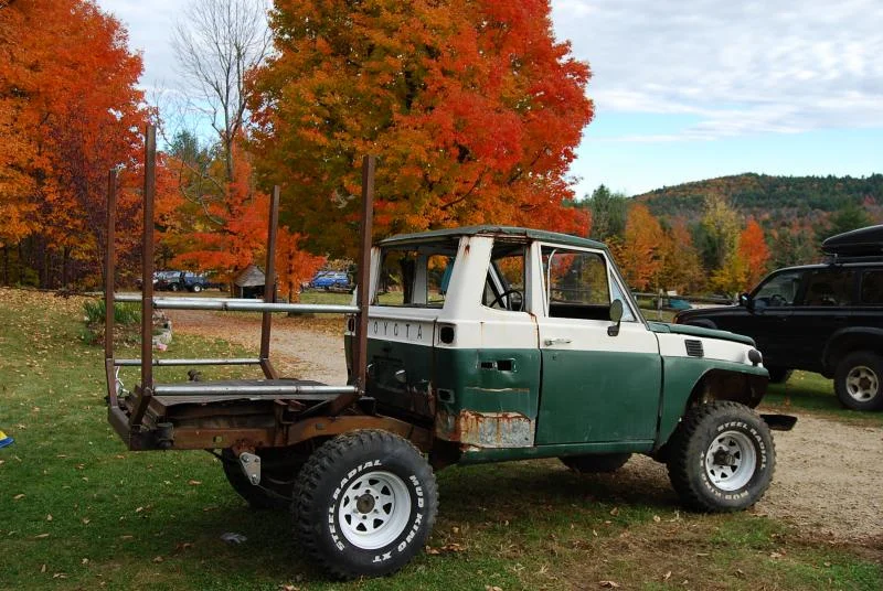

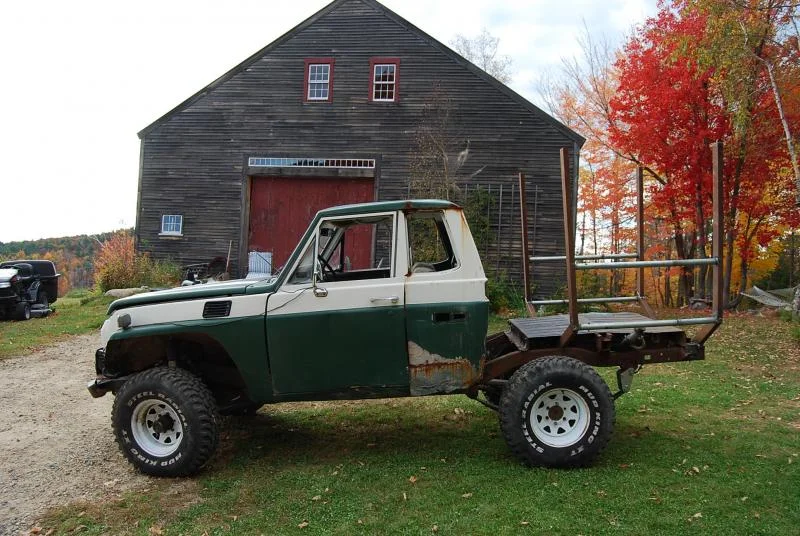

got parts
cruiserland's Avatar
Join Date: Jan 2005
Location: new hampshire
TLCA# 10389
Posts: 1,156
that was fast
looks great
my piglet turned into woodpig
