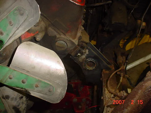

I've got the roof about half drilled out. The rear corners cut out and some panels built for the inners. I hope to start blasting it in a couple of weeks.
Mostly I've been distracted by the 67 FJ40. I've been trying to get the engine dropped so I can get it off the hoist.
motor mounts. I <3 my plasma cutter.

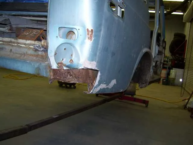

Garage
Finished the undercoating as much as I'm gonna do before the sodablasting.
Stripped the doors and tail gate for blasting.
I still have to mask the 1/4 windows. I don't want to try and take them out and risk ruining the unobtanium gaskets.
Gumby is offline   Reply With Quote

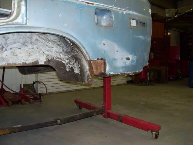

Garage

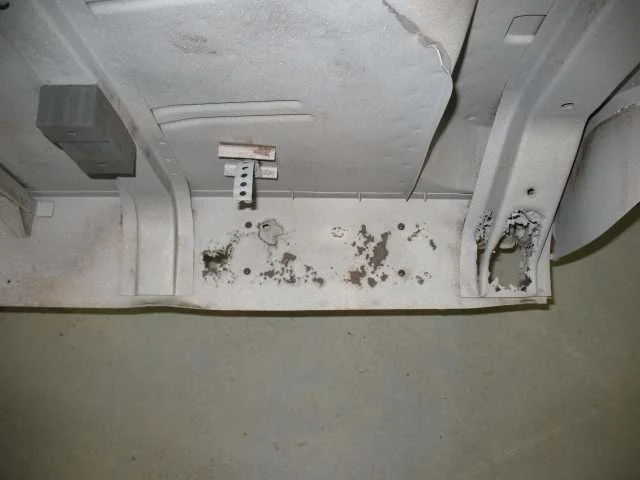

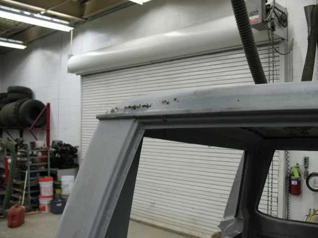

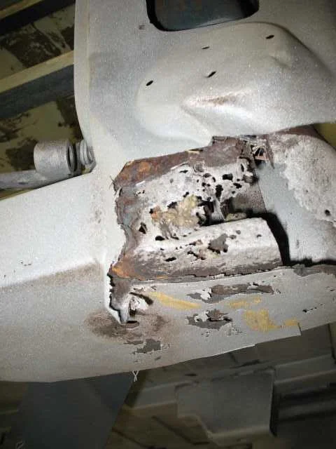

Pre-repair pics of the rust.

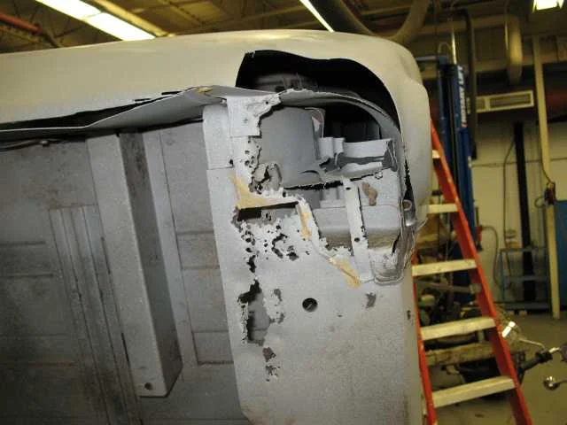

Garage
Nekkid Pig!!
Shes down to bare skin now. Camera batteries died so no 35% pics until tomorrow.
More rust, but nothing terrible and nothing I didn't really expect.
The big surprise was a 6 inch gouge through the sheet metal under a rear window and a caved in quarter.
I'm thinking about some trollhole quarter patches so I don't have to make wheel well flares.

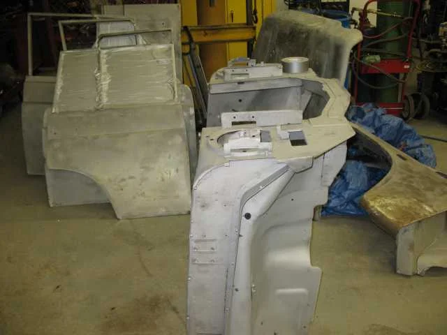

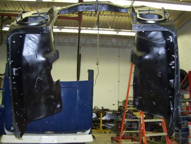

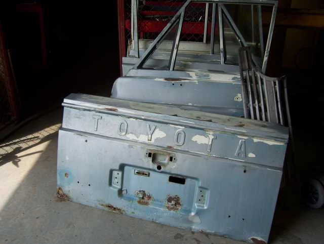

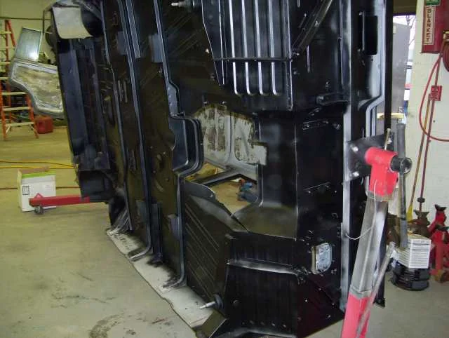

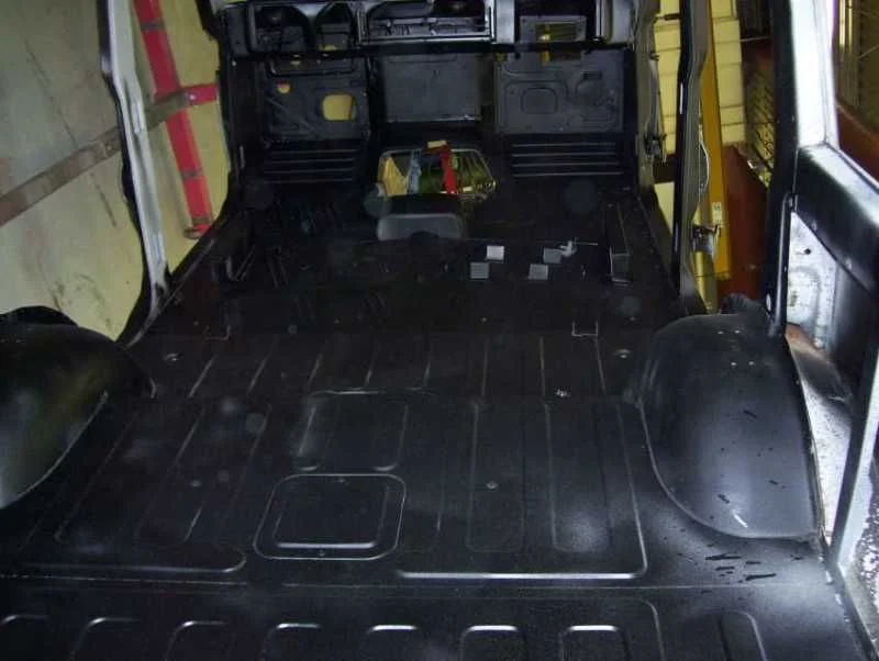

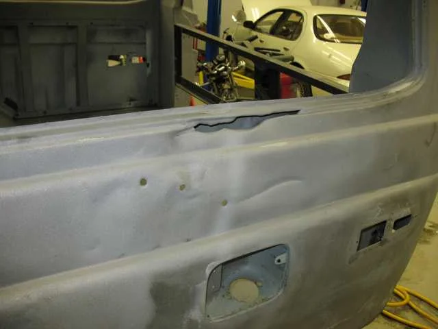

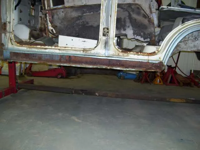

The good news
#1 The interior from the back
#2 The belly
#3 The stack o' parts

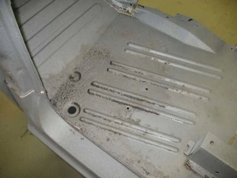

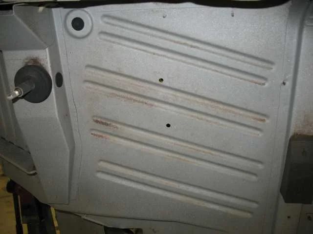

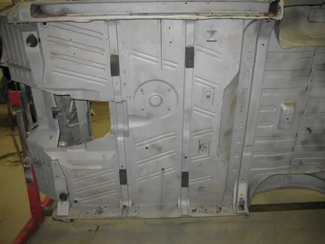

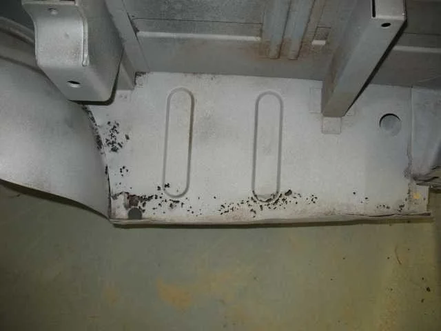

More good news
The floor pan from the top
The floorpan from the bottom

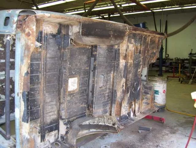

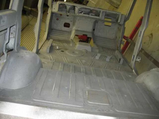

before and after blasting

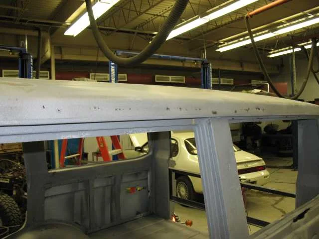

Garage
da roof, da roof, da roof is on fire!

Side gack. I think I can salvage this piece out of the war pig when she goes topless.
The blaster said the bondo was 1/4 thick through here.

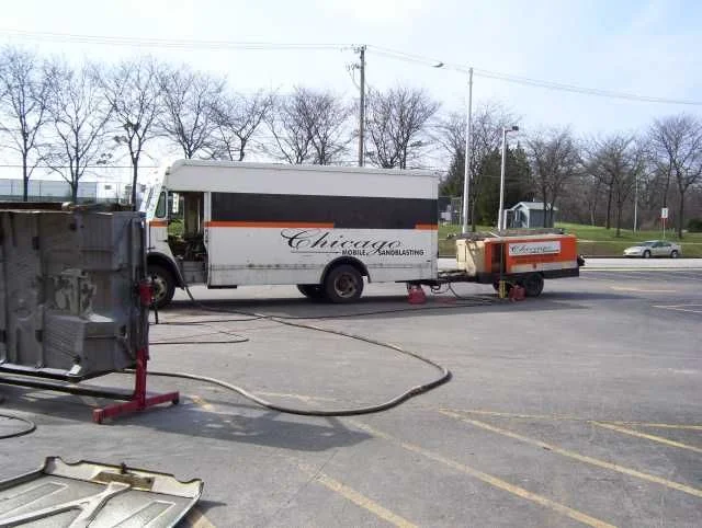

5 hours or so. He had a cool rig. Big Grumman panel truck with a tow behind compressor. The compressor ran a 6B Cummins. It was a big mofo
He used coal slag for the underbody and rusty spots and soda for the big flat panels.
I thought about dipping it, but what could I do about the rear quarter window gaskets?

Quote:
So he came to you to blast???
That's pretty cool. Did he also clean up when he was done?
Why not just dip every thing but the rear doors?
The only down side to a dip is having to get paint back into all the supports that the chemicals could get into but a nossel wont.

Yup. I had a mobile blaster do my 40 too.
He did clean the parking lot when he was done.
The really spendy local dipper ($4000) would e-coat it in a dip tank. I don't think the guy who was gonna just do the tub for $800 up in WI would have done anything like that.

Here comes the pig in black.
Started spraying the epoxy primer today.

Okay I have followed buckerasou's threads in the 45 section but never asked....
What is epoxy primer and why use it as opposed to standard grey primer?

epoxy primer is really hard. It's used in marine applications. I'm using it as a sealer and an undercoat.
Regular old primer is soft and is used to fill imperfections as well as give a base for the paint to stick to.
I'll use the regular primer over the epoxy when I'm ready to paint. The epoxy will be way to cured by then to be used directly under the topcoat and it's nearly impossible to sand down anyway.
A lot of the hot rod crowd uses it as a top coat. It looks cool as a final color.
