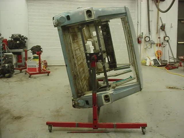

Hope more to come this afternoon

I did do the blasting indoors.
What a freakin' mess.
I will be doing the rest outdoors some dry weekend.
It seems to be going slow to me. I hope for it to speed up a bit once it's on the rotisserie and I can blast the body.
Stretching the doors is going to take a bit of time as well.

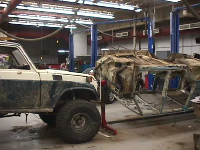

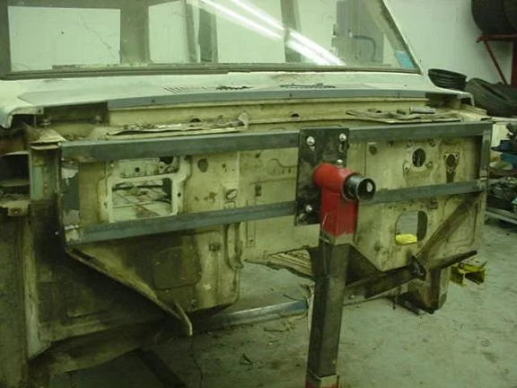

I taught the old girl some new tricks today.
PIG! Lay down!

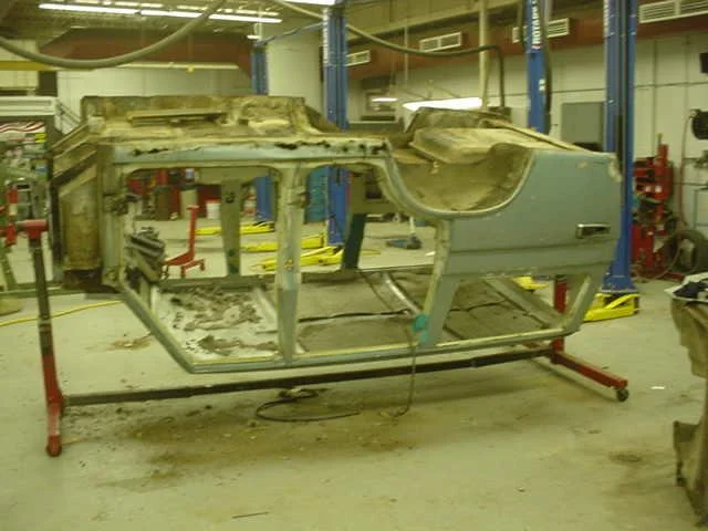

PIG! Roll over and play dead!

I can roll it around the shop all by myself. It'll make it way easier than even having it on the frame with no drivetrain. I can roll it over upside down pretty easily with one person too. I think it'll make it tons easier to do the body work, especially the rockers and drilling the roof panel off.
Just removing the windshield gasket was easier doing one side and then spinning it over to do the other side.

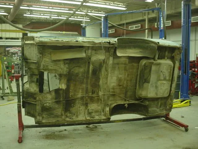

Whats holding the gas tank in?
Looks good. I wish I had the room to do that.

73 tank is bolted to the body.
Surprised me too. The 78 is bolted to the frame
Part of why I did it was because I didn't have the room to have it on stands. You do kinda need room to have the frame and body separate.
I can roll it in the corner my self now, and roll it out into the middle when I can work on it.

gumby, can you PLEASE post up some detailed pics of how you put that rotisserie together!! I need to do this on my pig for sure, now it is on stands and it looks like the way you did it would be fairly simple, appreciate the help!!

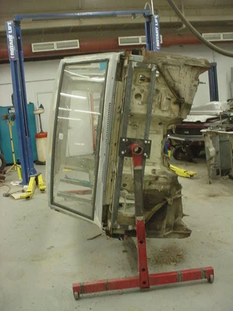

gumby, on your rotisserrie, when you are flipping the body over, does it want to overspin or get dangerous, can you flip it half way safely?
how did you figure out the balance points for attachment, etc.

I'd like to say I did a ton of measurements and math and figured out the perfect balance point, but it was a lot easier than that. I used the vertical flanges where the inner fender bolts for the front, made them as long as possible to spread the load and ran the angle iron from side to side from the ends of those. Then I mounted the head of the engine stand to the middle.
On the rear I used the tailgate stay holes and again made them long to spread the load, but here I set the weight down on the front stand and picked up the rear with the hoist until the rain gutter was level. Then I built the bracket to mount the head there.
It does like to sit flat, but one guy can spin it with a 2 foot pole through the end of one of the heads. The heads have a locking pin to stop it from rotating and one needs to be used in every position except flat. The bottom is certainly the heaviest part, especially without glass.

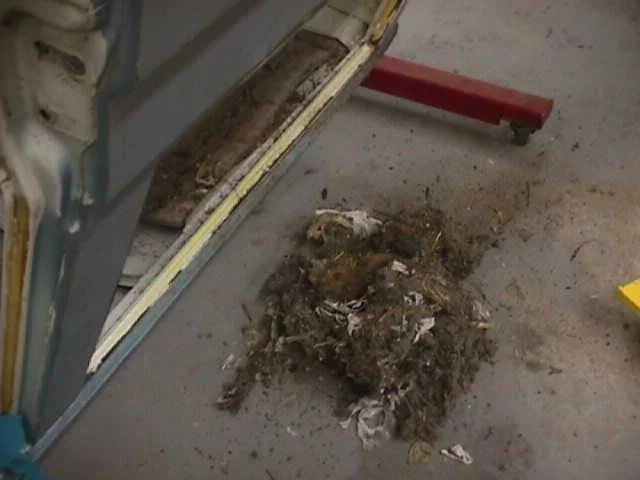

The mouse nest in the quarter was a little bigger than I had thought.

do you plan to do all the bodywork on the rotisserie and then just transfer the body to the frame? that sound like it would work perfect, man I need to build myself one of these.

I hope to do all the body work on the rotisserie except I might have to build another jig to hold everything square when/if I stretch it.
After driving the wife's FJC tonight I sure wouldn't mind putting one of those under the pig and it has the same wheelbase as the pig.

Cut off the outer rocker panels yesterday. Found more wasp nests than I'd ever seen in one place. 'Root's gonna have a homeless wasp problem in the spring.
Debating making rocker panels or buying them. Anybody have experience with the purchased ones? Are they just the outers or the whole thing?
I'm also trying to figure out the rear corner stuff. I wonder if I can make a wooden buck to shape the corner on.

Quote:
The one from IPOR are just the outer skin. very thick and durable but just the curved portion. Since you are extending the pig you will most likly have to order 2 sets, then cut and paste them together to get the right length. If you do that I may be willing to purchase the remaining portion for my pig extension. Lance at IPOR recommends going to your local steel yard and picking up some 4x4 box tubing and cutting it into 2 sections diagonally. But he says not to cut them corner to corner but just off. So that the rolled piece of steel will weld right up.,
I have yet to try it but it looks pretty close.
http://forum.ih8mud.com/fj55-iron-pig-preservation-society/118138-rear-corners.html
