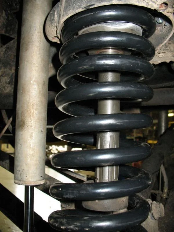

The old bumpstops were mangled. They were nowhere near sturdy enough and didn't guide the spring well enough.
So I needed something with about a 4" wide bell or cone on the end and a long stub coming out of it, preferably with a threaded end so I could bolt a rubber stop on.
Fortunately, I have about a dozen of these around the shop.

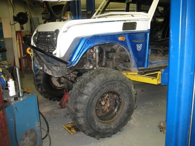

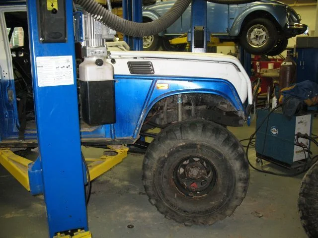

And they say I don't have any Toyota parts on my rig.
On jackstands about the right height for 39.5s. I wouldn't put these on. They are junk. I got them to check stance and clearance for new tires. The 36s just look too small on this rig.
