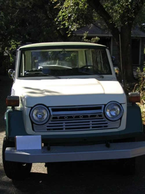

Here is a later hood with the slight hump in the center to clear the 2F air cleaner/carb.
