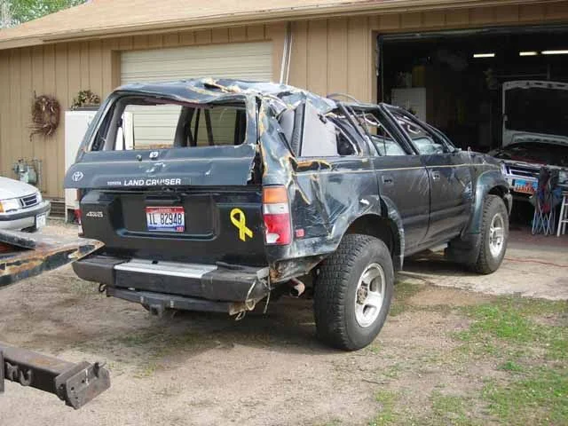

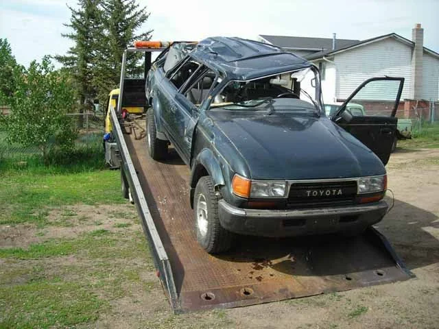

KliersLC's old FZJ80. Judging from a good look at it, AFAIK, no frame damage what so ever from the roll.... But boy the body is mangled

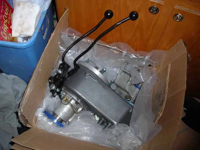

Also the Dana 300 arrived the other day. Got a heck of a deal I think from a guy off Pirate... Heavy Duty front and rear output shafts, clocking ring, and twin sticks in a rebuilt 300 all for $750 shipped... I want the 4:1 gears but with budget as is not sure I can pull it off currently -- $600 extra. (I also paid off CC bills too :( ), so that will have to wait. I will have to order this http://www.jbconversions.com/pages/p...300ret_29.html for another $300 to allow the Dana 300 to bolt behind the NV5600 (same rear bolt pattern / output spline count as a NV4500). I might have to ditch the AA clocking ring though, we'll see. But I can probably get a little $$ out of that too...

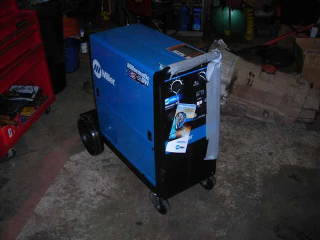

the new welder. I am pretty psyched about this. Even in 110 mode it burns in SO well, I was even getting some decent penatration on some 1/4" thick stuff on a fairly low setting.. I am totally pumped, this is something I have been putting off for a few years so I am pysched to finally have a decent welder...
brand new miller matic DVI machine...

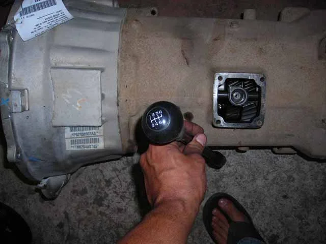

I also brought home the NV5600 finally. I am starting to learn a lot about these, these are light years ahead of the NV4500 though there are some similarities. Took three of us to get it unloaded, it weighs that much, about 360 lbs...
And the best part...

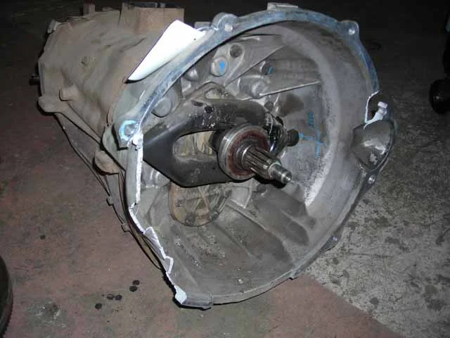

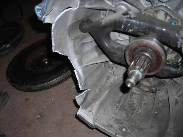

but some bad news... I had heard from a bunch of different people about a "integral" bellhousing on the NV5600. I bought this one cheap ($1850 for the trans, with a warantee) because it was in a wreck and has a broken bellhousing... So I looked at it and saw it has an aluminum bellhousing so I thought "they must be wrong." Checked into it. Turns out the bellhousing is sort of the 'core' of the trans, in that everything is built off of it. Bummer... The trans will require a **complete teardown** to replace the bellhousing... So I am pretty upset about his... But I guess its better to be rebuilt than not. I have a good shop to do it (same people who rebuilt my NV4500, and I get a 2 year warantee out of it). But I have a feeling it will be at least $1G to get it rebuilt :(

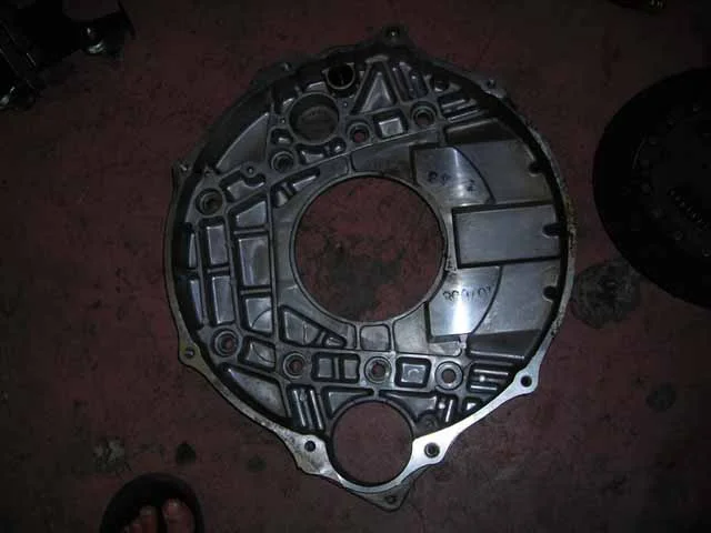

adapter plate was also broken from the wreck so I had to get a new one. Got this used in SLC for about $100, this will bolt right to the back of the 4BT to give me a dodge pattern to allow the NV5600 to bolt up...

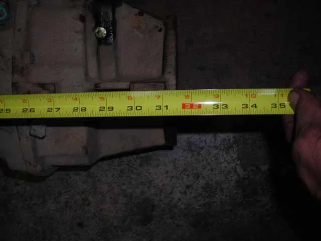

I ended up with everything (trans mount, clutch, slave and master, flywheel, adapter plate (broken), starter) and even some weird things I didn't need like the PEDAL MECHANISM (why would they throw that in?) and even the boot / center console for $2000 out the door. So pretty good deal. If there wasn't any damage it would have been a heck of a deal... :(
To get an idea of overall length of the trans...

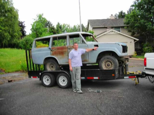

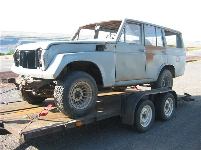

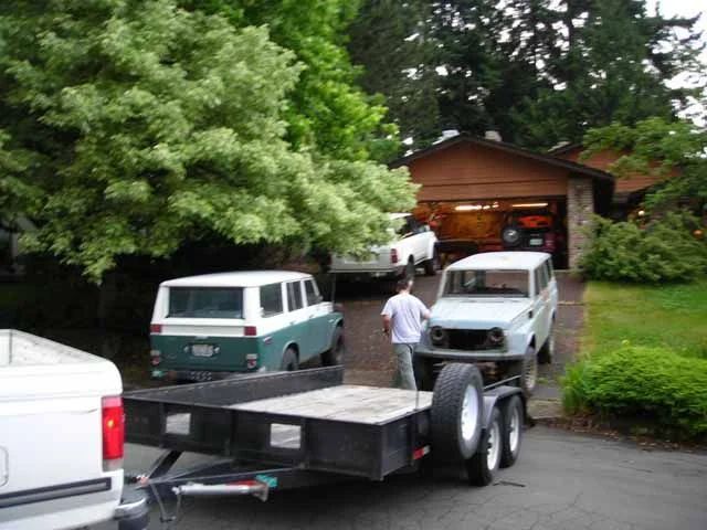

and finally, I take off first thing in the morning to go pickup the FJ55 in Portland.
Borrowed a Ford from a friend for the weekend. Should be a good trip and I am pyscehd. Never been the PNW and Carrie will be meeting me on Satyurday. We'll be staying in a funky hotel there called the Jupiter, 70's retro style and full of young people supposely... Come back Monday...
Couldn't find a trailer to borrow and Carrie already had plane tickets so ended up having to buy one as well. Pretty funny trailer, a car hauler that was converted to be a lawncare and equipment hauler. I saw it used, a guy bought it from this company to haul his Jeep around on and never cut off the storage box. Good payload though, but the 55 will probably just barely fit on it (16ft bumper to bumper and the trailer is 14' long). Luckily there is no motor etc in it so I shouldn't have too much tongue weight if I were to load it in frontwards. Not sure if I'll sell it afterwards or just keep it and maybe sell my military trailer instead. Probably keep it and use it for the rest of the project, though I'll need the money for other parts of the project...
I already hacked the box off and other things this afternoon, I'll post a photo later... And the Ferd is hauling my military trailer which I also use for hauling things around, it is a M416A2 if I remember correctly. I have more info about it posted somewhere in "outfitting" if anyone wants to search...

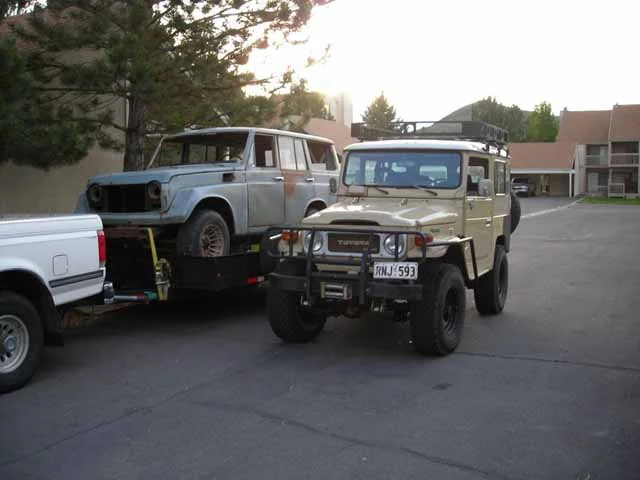

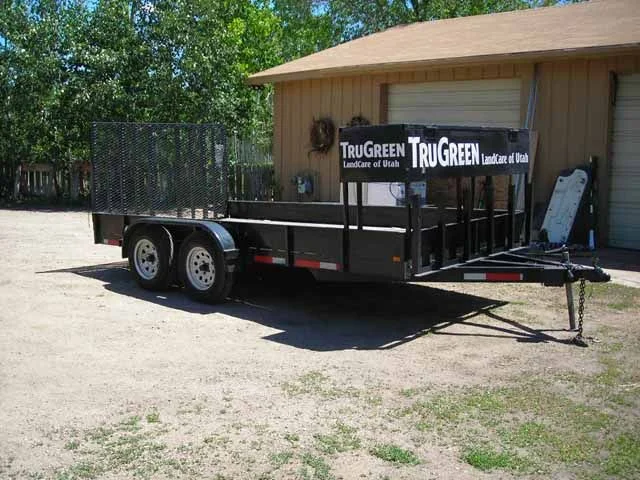

What is the width between fenders on the trailer?
Looks like a nice trailer. I would add some steel underneath with that sweet welder ... The tongue should truly go at least to the front of the spring hangers. There are some pics of a trailer like that on RME that the tongue busted off from hauling a heavy rig. Are you sure it has a 7k payload 2 3500 lb axles?) it looks more like a 5k trailer (2 2500 lb axles). Either will haul a carcass just fine, but a loaded complete rig can push 3 tons...
6 speed... bitchin!!!

Here is the piggie getting loaded. Also the tow rig was awesome, a Ford '89 diesel F250 with a ATS turbo kit. Great truck, pretty good power and ran like a top the whole way. Did about 65-75 most of the way for the most part.. But did guzzle (10-12 mpg - ouch ). Trailer was the one I picked up earlier (seen in photos before)...
Photos:
1) At Brian Ligenfelter's getting loaded up on Friday evening. Of course with plenty of Oregon rain... Brian is a true FJ55 guy and stored it for a few days between him and the guy I bought it from (notaJp here on mud aka Jim Kramer, nice guy on the phone).
2) His awesome bone stock beatuful original FJ55 with OEM paint and everything... I met Brian at CM05 if I remember correctly when he had his awesome also green and white SOA piggie that now resides in LA. Brian and his wife and three kids were awesome and super hospitable and I had a blast hanging out with them two nights in Portland and at their house... One of their kids is named Trey after Trey Anastasio, pretty cool
3) Photo is of him infront of the new pig... You can see the pig barely fit on the short trailer. But trailer towed it home fine, no problems home at all...

more photos, all loaded up at Brians, then a nice rear view pic on the way home. We did have a blast in Portland but again didn't really take too many pictures for some reason. Great city though and I really had a blast there. Also dug all the cool old Volvos and diesel Benzes among many other very cool old cars all over the place there...
