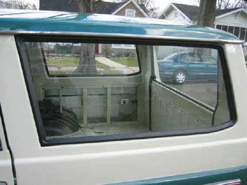

Post The FJ55 Weatherstrip Guide
I've been compiling this list for awhile as I have been "refurbishing" my 55. Following are part numbers, prices, sources, and pics for most of the rubber parts on the Pig. Most parts are identical or very close to factory - while a few were chosen for economics. If I left out anything, please add.....
FJ55 Weatherstripping
Source Price Part # Length
Window Channel
Driver / JC Whitney/ $9/ ZX184879T/ 8 ft
Passenger/ JC Whitney/ $9/ ZX184879T/ 8 ft
Left Rear/ JC Whitney/ $9/ ZX184879T/ 8 ft
Right Rear/ JC Whitney/ $9/ ZX184879T/ 8 ft
Tailgate/ PV Cruisers/ $225/
Window Felt (straight chrome w/ felt)
Driver/ JC Whitney/ $14/ ZX193480P/ 8 ft
Passenger/ JC Whitney/ $14/ ZX193480P/ 8 ft
Left Rear/ JC Whitney/ $14/ ZX193480P/ 8 ft
Right rear/ JC Whitney/ $14/ ZX193480P/ 8 ft
Tailgate Inner/ JC Whitney/ $14/ ZX193480P/ 8 ft
Tailgate Outer/ JC Whitney/ $17/ ZX819752R/ 4 ft
Door Weatherstrip
Driver/ JC Whitney/ $17/ ZX813688A/ 10 ft
Passenger/ JC Whitney/ $17/ ZX813689B/ 10 ft
Left Rear/ JC Whitney/ $17/ ZX813688A/ 10 ft
Right Rear/ JC Whitney/ $17/ ZX813689B/ 10 ft
Tailgate - Sides/ JC Whitney/ $10/ ZX133178W/ 10 ft
Body Moulding - this piece is a little too thick to allow the door to close easily. See thread details for other possible solutions...
Driver/ JC Whitney/ $38/ ZX132562B/ 25 ft (enough for 2 doors)
Passenger/ JC Whitney/ "/ ZX132562B/
Left Rear/ JC Whitney/ $38/ ZX132562B/ 25 ft (enough for 2 doors)
Right Rear/ JC Whitney/ "/ ZX132562B/
Tailgate/ JC Whitney/ "/ ZX132562B/
Glass Weatherstrip
Windshield/ SOR/ $39/ 120-03G-A
Cargo - Left & Right/ PV Cruisers/ $230
Left Rear (small)/ $UnObtanium/
Right Rear (small)/ $UnObtanium/
Other Items
Metal clips for attaching door and cargo panels/ www.restorationspecialties.com/ page 100 part#1969
Plastic insert for " " " / www.restorationspecialties.com/ page 101 part#5127
Metal clips for attaching window felt / www.restorationspecialties.com/ page 91 part#11411

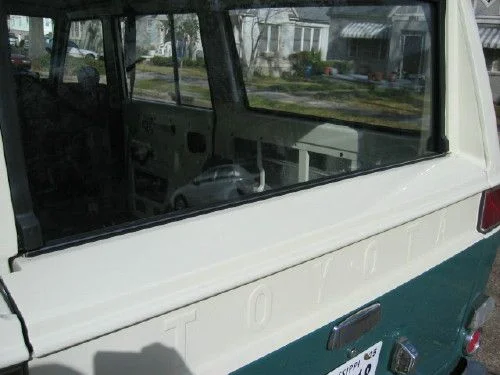

Pics 1

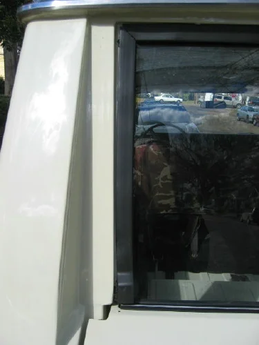

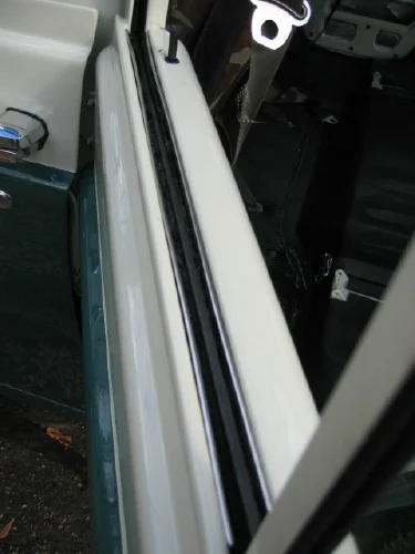

pics 2
pics 2

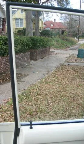

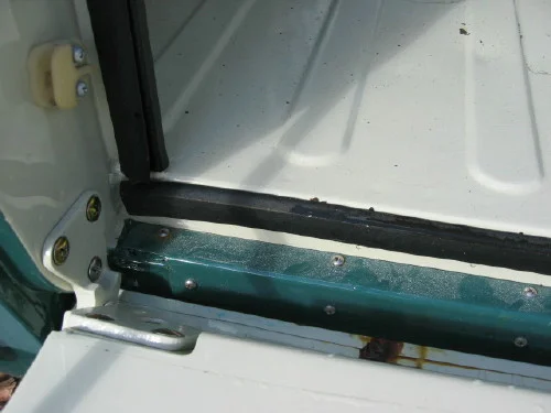

pics 3

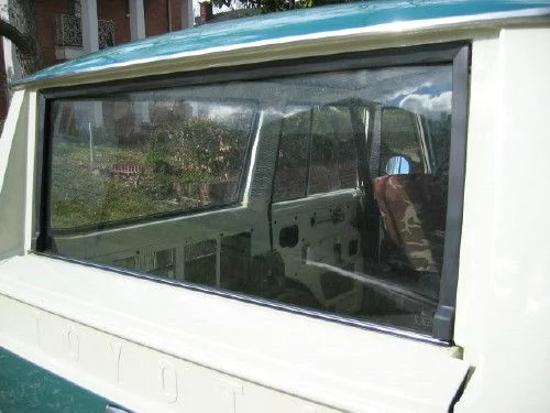

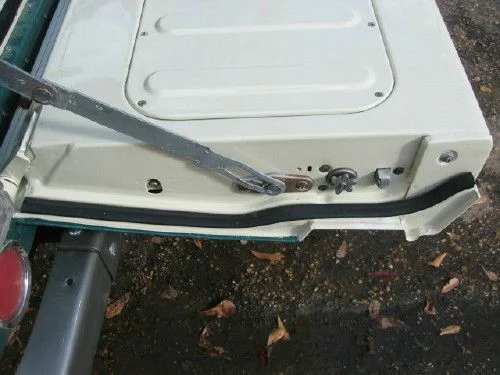

pics 4

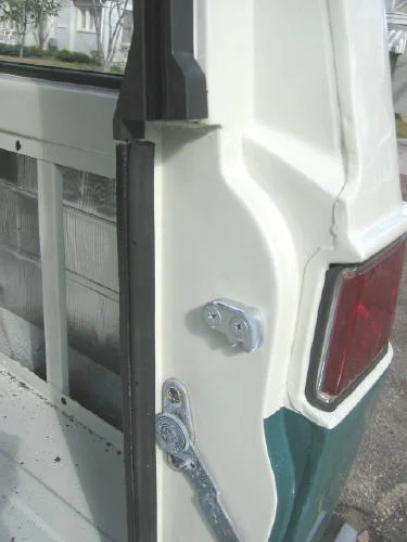

pics 5
