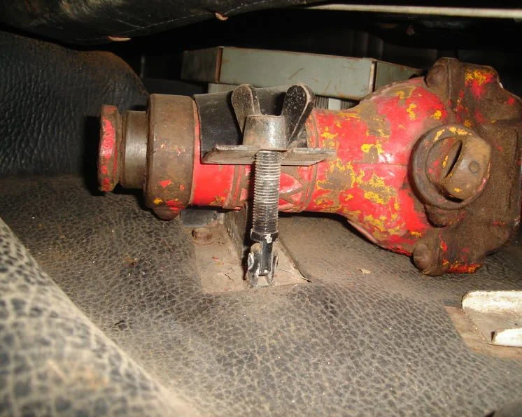

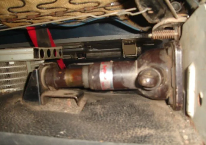

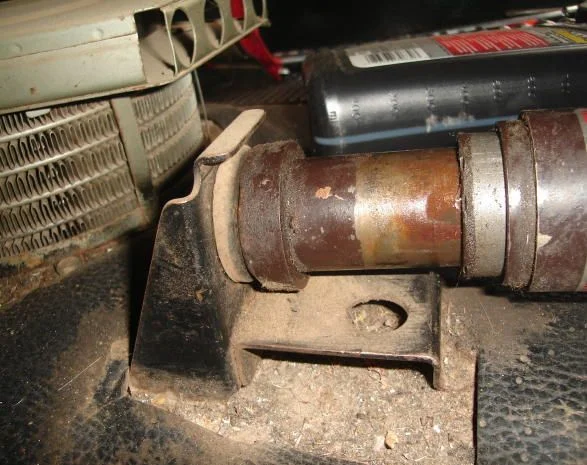

here's the jack setup on my 73 and my 76

Lou, that's EXACTLY like the part I'll send with the gears!

Thanks C-G and Nuclear Lemon; I have the piece that attaches to the floor BUT still a bit unsure of how it is held on it?;

how the jack is held so it won't rattle;

Just turn the crank and extend the jack until it's tight, you can source a rubber ring like that.

Lou, do you have the part that attaches to the floor? That is what I was going to send! What EXACTLY are you missing? Does your floor bracket have the rubber pad that the top of the jack comes up against?
Like Luke111 says, just crank the jack open until it is wedged between the seat support and that bracket.

here's the wing nut style. early pig and 40 series. the only thing i've ever seen held by a rubber oring is the tool bags. the two pigs i have here both have the canvas straps holding the tool bags. tool bag is under right hand side, jack is under left hand side. then, the jack tools are clipped to the bottom of the rear seat.

Lou, there's your choices!! Does your floor support have the rubber disk? My spare does if you want it. The rubber disk is not removeable, you'd need to replace your's with my spare to get that rubber disk.

G_G and Inge; thanks for the input and pix; could not have figured it out....mine is a 78 pig and the jack is wedged in the way Inge shows in her pix; the Large rubber O-ring was probably to hold the tool kit; C-G I do not have the rubber piece so if you could; please send the jack support along with the gears; are there any more left?
