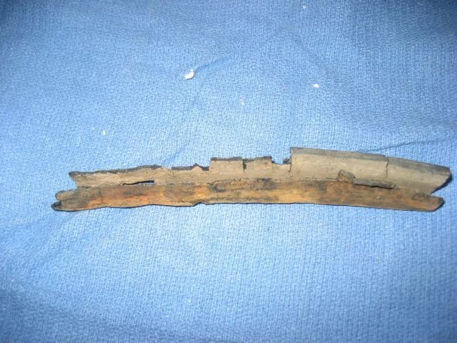

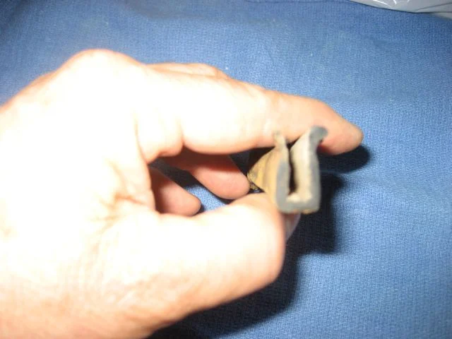

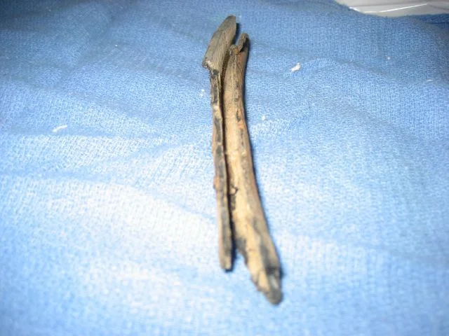

old tailgate regulator channel rubber
Changed the tailgate window channnel rubber wed- thursday; took out the old crapped out rubber and put in the new on the 74.........wire-brushed the rusty channel and hit it with rustoleum rust converter....had to give it 24 hours drying time and then installed the new stuffit is an incredible difference just how smoothly the glass glides in the grooves and NO more binding........just a thought after the fact initially tried replacing the old rubber with a strip of inner tube but that did not work after several hours of.....another option we looked out was the rubberized adhesive tape.......but it did not have the "pinch" of the original rubber....... I think the design of the the lips on the rubber are important as they will spill any water rundown OFF the metal part of the channel and hopefully keep it from it rusting out; if the lips were not there then the water will tend to accumulate and if there are cracks then will filter down into the metal channel setting up the rust demon again........think I will go ahead and take a look at the 78s tailgate rubber and change it also if I see any cracking even though it is not binding.........just thinking as I type HTH
Lou
here are a few pix of the old tailgate regulator channel rubber removed
thanks again Ige, Luke111, Eric Ellis and Romegadave

That rubber is DONE!
Lou, that makes my rubber/WS look new. I can't believe that would work at all...
I have trimmed the lips off of my orig. rubber in order to make it work, several times over the years. It still works, but only occasionaly. I can't wait to install the new stuff...

Carlos; I think the lips are important to keep the water from running down into the metal channel and rusting it out.........the lips will spill water outwards where it will drain out the tailgate drain vents......just my thoughts on it.......

Yep, I think you're right. I actually had to keep trimming my weatherstrip because every once in a while when it would fail and the window became loose, I would try to reinstall the W/S and it would fold and eventually crease and then deteriorate and then fail again, etc...:(
