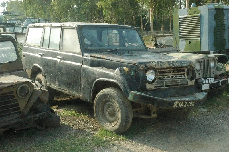

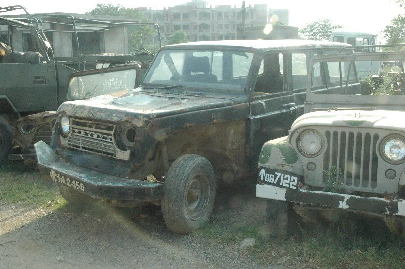

Found a Body for making the repros off. What do you think?
Ehsan

Quote:
Ehsan
ugly but she will work
cant wait

Quote:
cant wait
Is the bumper on this one OEM?

Garage
nope looks very beefed up, might be a stock front with some added gussets to the rear, 55 bumper should look similar to a 45/40
