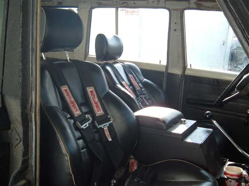

This is what I am thinking of doing. Lance over at IronPigOffroad makes the bracket and sells the seats. The Tuffy console is an option. It's the cleanest idea I have seen yet for the pigs.

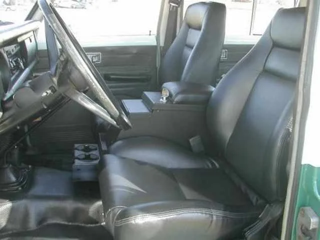

Celica...

Those are the heated ones right Greg? mmmmm.......heated seats...
mmmmmm.....hog-fat...

I like those. I'll have to check out some Celica's on Monday when I go to the pick and pull
Where are your four points attached in the back? I've heard they have to be solid mounted close to the top of the seat or when you go forward, they will crush down on you.
