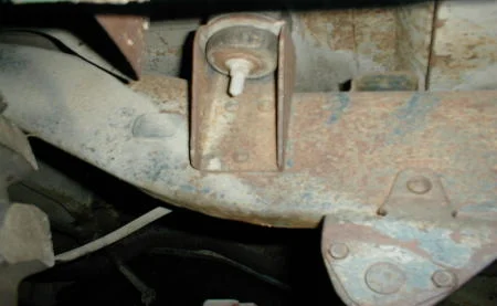

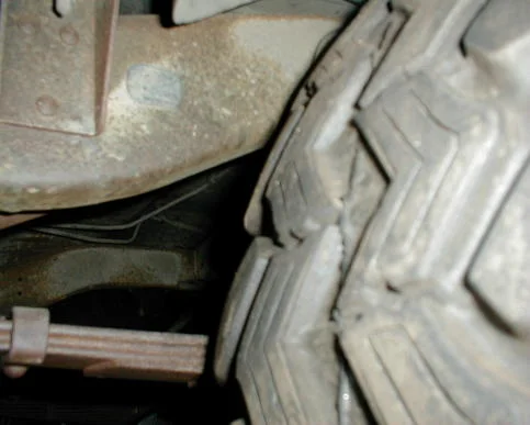

Here are pics of what I am asking about, driver side has the two holes... passenger does not... is this consistent with other 55's?
has the two larger holes good for mounting sliders.....
does not have the two large holes...

here's left and right on my sept 72 frame

thansk lemon... seems mine is an oddball and maybe a PO drilled the holes... I'll mount the sliders somehow! seems many ways work...
is it preferable to weld to the frame or drill holes? Anyone?
