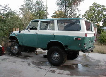

Here is my rig with 35" MTRs on SOA stock axles.

Cardinal, does your Pig wander on the highway to the trail? I realize that Pigs are not a sports car, but te mini truck that I had with 12.50's wandered very bad. That is my main concern for going with the 35 x 10.50's. Plus, I could run just some regular old school rims.

Nope, it runs a lot better on the road than my 40. It does not have stablizer, but will soon.

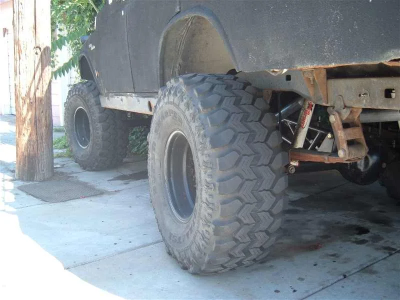

35x14.5...don't look too bad...

thanks for the pics yoop, looks good, wgenever you git round to that measurement it'll be nice to know where you sit heightwise,
heres a couple shots of mine for comparison:

back end just needs to be welded (waiting till i get the powertrain in). front, needs a lot of work...and tires ... no motor or trans/xfer, so front will drop some. 35x12.5x15 on stockers for now, but i'll get them widened when i get closer to running it.

Just took this. I didn't do the work, so I know nothing - ask Lance for details.
