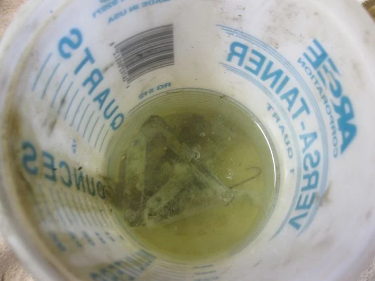

I have had seen any post about using muritic acid on parts on MUD or Pirate. So, I though I would break up the subject. I learned this from Mark Whatley some time ago.

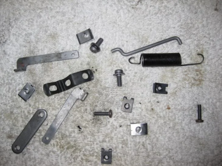

I regularly use Muritic Acid (Swimming pool acide) to clean and remove rust from a lot of small parts and pieices. It is really cheap and does a great job
Below, I tossed a few of the screws and parts from the tailgate into a plastic paint container. When the acid starts fizzing, it is eating the rust. Doesn't take much to clean the parts. But, warning, you must clean and paint the parts right after removing them. They will flash rust real fast if left out in the open. I wash the parts in clean water, dry them, then paint.

just goolged Muritic Acid. do you know what strength the stuff you have is?? because that stuff can be pretty corrosive?? eat the metal away completly if left in there for any period of time. how long did you leave it in?? few minutes??

It is pool acid, so it is not a high concentrate? HCL is a different animal. Very strong acid.
I leave the parts in the acid until it stops fizzing. On small stuff, about 10min. But I have left some parts in for hours without any ectching.

Guppie- I've used phosphoric acid (bought at the hardware store) to try and neutralize rust on the sheet metal of my pig. My impression is that I either did not leave it on long enough or the acid wasn't a strong enough concentration. The rust is back where it was after 1.5 years. It's even showing through the zero rust. :(
EDIT: Oh ya Cardinal...what did you paint your nuts and bolts with? Galvanizing primer?

I use 1/2 muratic acid 1/2 water. Pour water in then the acid.
I leave my stuff in for around an hr or so. I also just pull some parts out and check every 10 min or so.
Works well on greasy stuff too.
