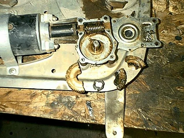

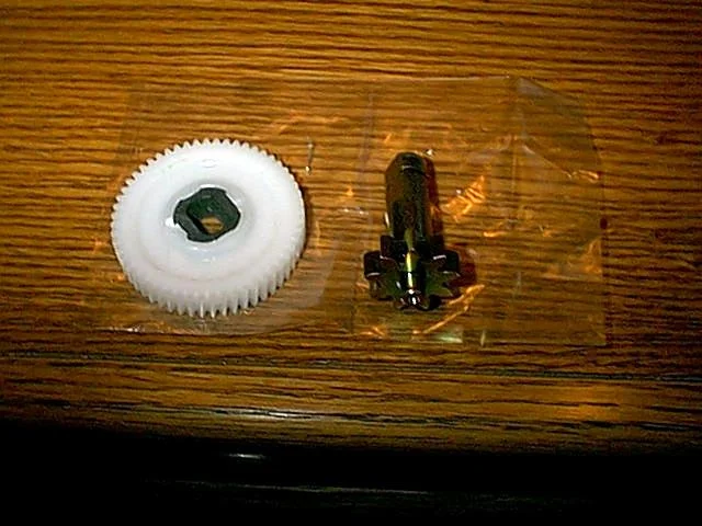

It is the plastic gear in the rear window motor. Classic problem with a 55. You have to take the glass, arms, and motor out of the vehicle to fix it. Been there, done that

Gear is less than a year old, back to my question, how do I get to any of the bolts or mechanism with the glass in the way?

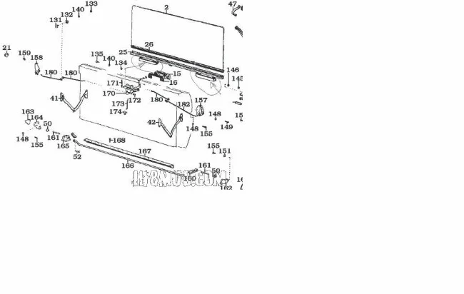

Here is diagram of the aformentioned window clips....slide them towards the center IIRC.
