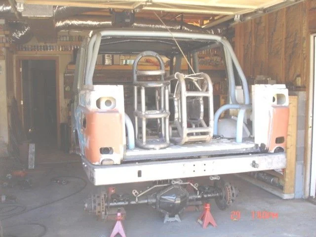

Can you trim all that low hanging, rusty rear section off? Back before I whacked my rear sides, I was able to trim just below where the tailgate torsion bar resides & level it all out. Just wrap the bumper around on the outside. On the inside underbody, I was going to use some perforated metal to join the outer panel & inner so I can clean everything out & no dirt or rust can get trapped. If you decide solid panels there, I'd make the panels removeable. I know this is a lot of work but it'll be worth it when your tail doesn't drag all over the trail
