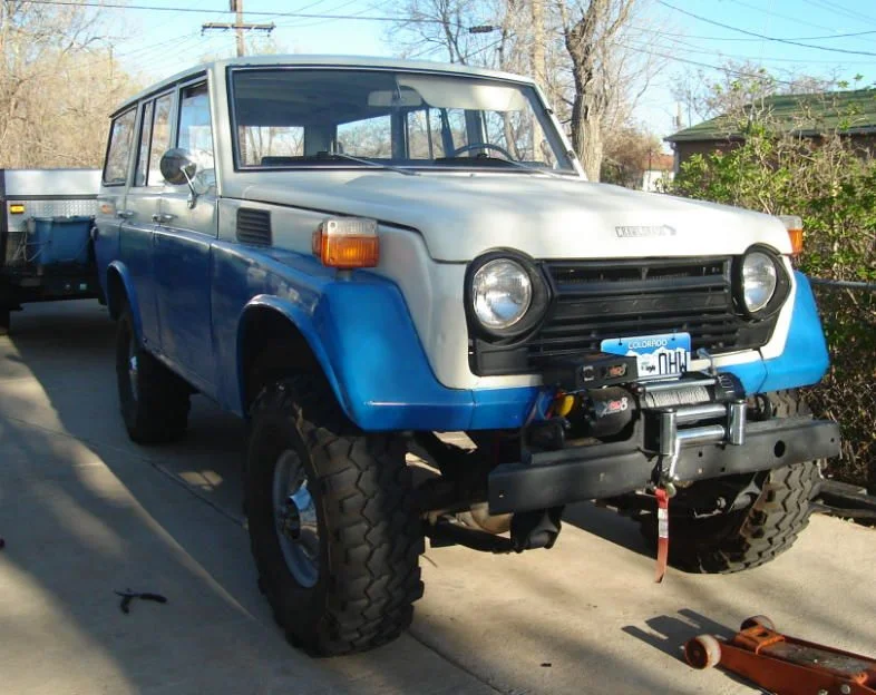

i was trying to sell my 60 a couple years ago, to weed down the overflowing cruiser herd, when the offer of a trade came up. i loved my 60, but i'm a swine lover at heart.
originally built up by trapper50cal, i've been tweaking it here and there, fixing a few small things, breaking others, then having to fix those too. yep, it's a pig.

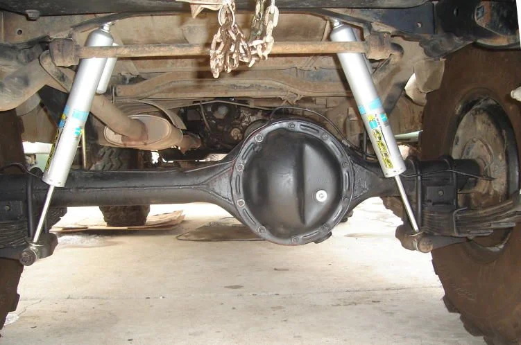

first thing i did was go through the hydraulics and throw a locker and winch on it so i could take it to moab and wheel it. i still remember gary cobberly-waggoner laughing as he watched bondo fly out of the front fender everytime i flexed the tire into it on cliffhanger. i also remember he and a few others were amazed when they watched me turn the steering wheel multiple revolutions without the tires budging, or the tires turning sharply while i held the steering wheel steadfast.
needless to say, power steering is a planned future mod.
right now, i'm working on finishing up the last of the things that don't work or not well. i've got to strip and clean the rear window regulators then, readjust the arms for the lift window in the tailgate and fix the rear heater. then everything will work.
next will be the body. i've rebuilt the front door upper hinges and the lf door is perfect, but i think the rf door is cracking away at the lower hinge like our babies are so prone to do. i've also cut away the offending front fender and made some patch panels, i just have to final cut them and weld them in.
rockers, rear sill and the non existant body mounts will be happening after that. motivation will tell how much farther i'll go

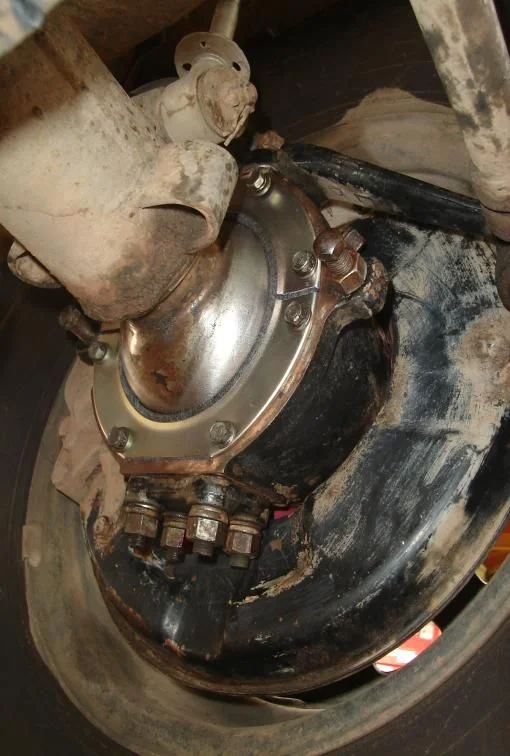

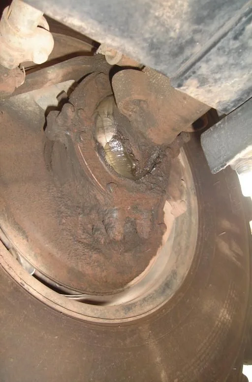

the underside needed some cleaning and the knuckles were in typical cruiser neglect, but that's something i freakishly enjoy doing. i love having a cruiser that looks clean underneath, so a bit of work was started there. someday i'll finish.
i also fixed a couple of sketchy electrical parts, upgraded to a 60 series starter, made longer heavier duty sway bar links, and relocated the rear shackle hangers almost two inches forward to get some angle on the shackles. oh, yeah, and i got rid of the spokes and went back to factory rims with hubcaps, cause hubcaps look cool with knobbies

I really like the looks of those Swampers and the stock wheels. What size are the tires and how much lift?
JackA is offline   Reply With Quote
Old 07-02-09, 04:27 PM   #4 (permalink)
not an addict
nuclearlemon's Avatar
Join Date: Jan 2003
Location: meh-ico, colorado
TLCA# 1431
Posts: 9,314
Garage
tires are a 34x10.5, lift is 4" springs with maf shackle reversal kit and 2 1/2" over rear shackles

I need to do my Pig knuckles, I want to go to 60 series while I am in there.

More power to ya !! IH8 doing knuckles, I end up looking like tar baby for two days and the smell stays in my beard for a few more. Nice piggy Ige Now back to some wine and getting my act together for CMCC in a couple days.

lol..i'm not a clean wrencher, so i end up looking pretty greasy at the end also. it's amazing how awesome a shower can feel after a front end job. but the satisfaction is awesome, plus, you know how crappy it can be, so i never let it get that hideous again.
