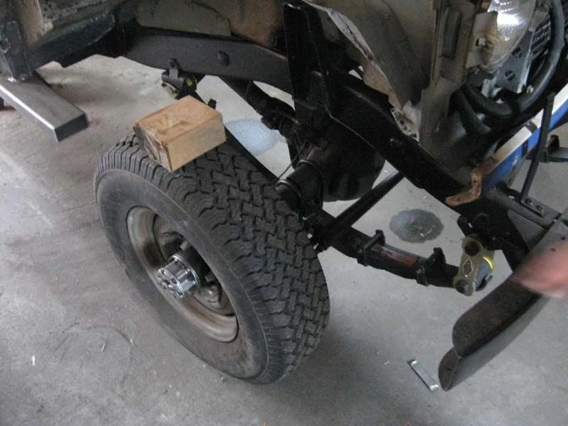

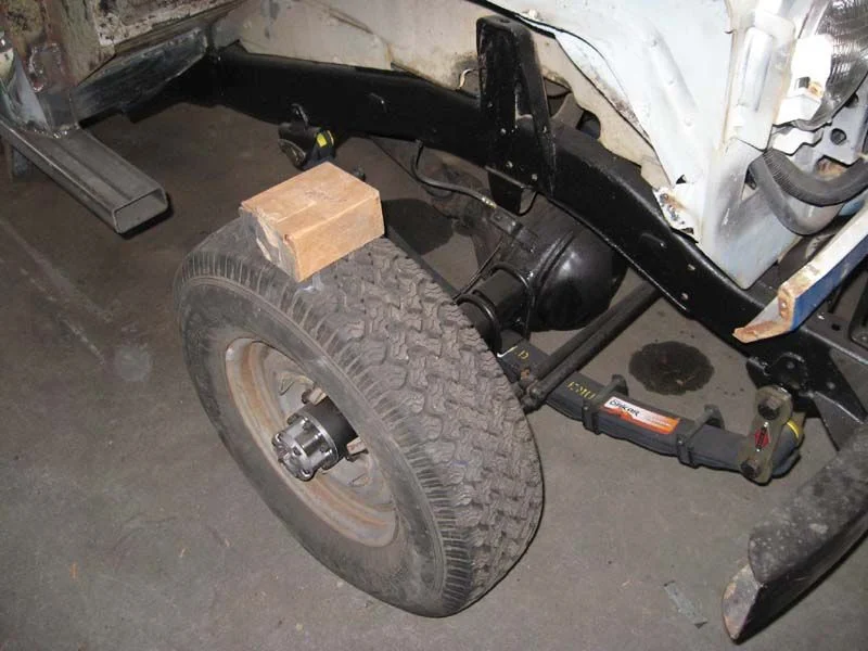

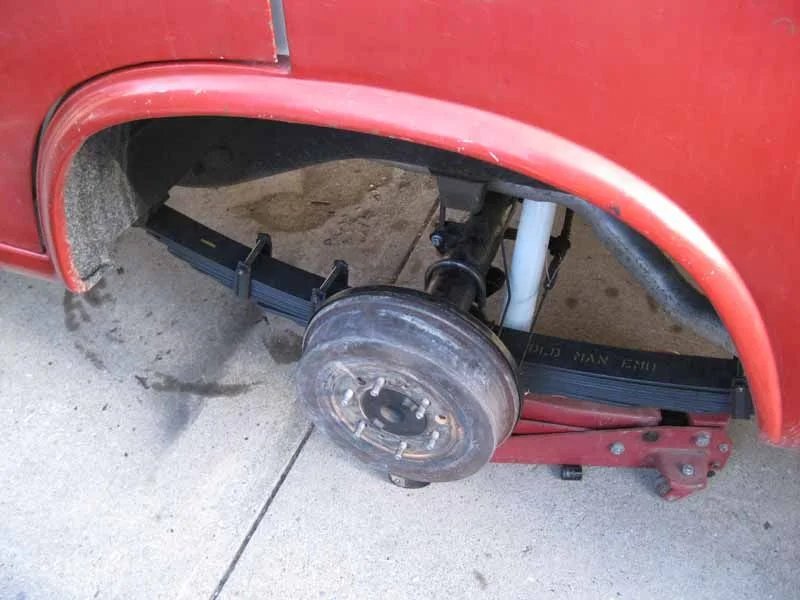

Here's what I have from Scott Pilcher's house last fall...

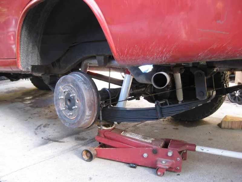

I've got a couple pictures, AJ & Jim brought the Cruiser down to the Cruiser Outfitters show-shine & BBQ last weekend. Looks freakin' awesome!
Thanks again for making the effort to get it done and come down AJ. Of the 60+ Land Cruisers in attendance, yours was one of the crowd favorites for sure!

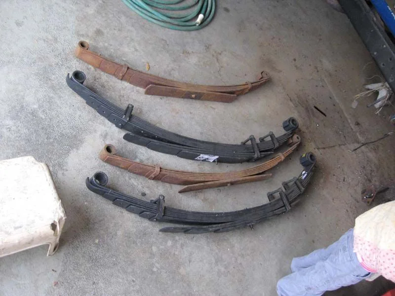

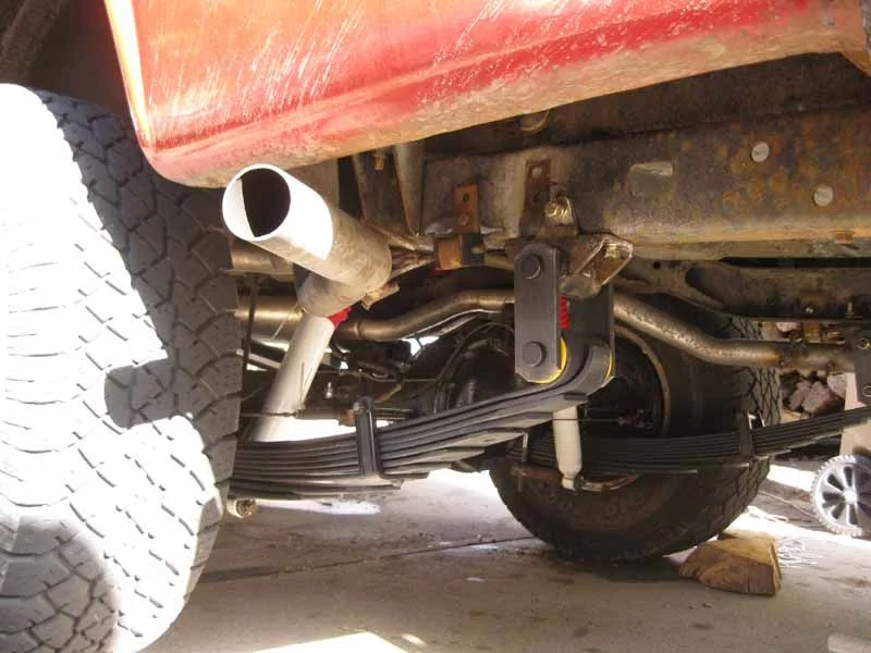

Some more... I stopped by AJ's this afternoon... Check it out with some sweet, familiar looking, new 33 x 10.5s Looking good AJ! I was very impressed with it...

AJ also I really want to apologize to your old man, I kept calling him Rick mostly because I knew a Rick Oliver back in the day... I had totally forgotten his first name is Jim. Jim... If you can relay the message!
Truck looks great, almost like the kit was designed for it

The shackle hangars on the red Pig look to be bolted in three places. Are they also welded?
