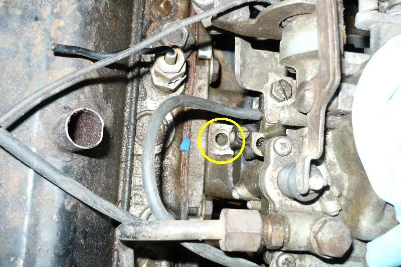

new question
looking down at the intake manifold, between the carb and the valve cover.
i can't tell if this hole goes all the way through, didn't notice it till i was checking for vacuum hoses.
any idea

that is for a bolt to mate the intake to a stock exhaust manifold. If you have headers(and no aftmkt heat riser), its going to look just like what you have.
