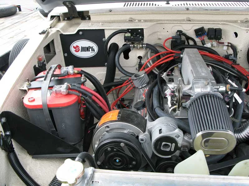

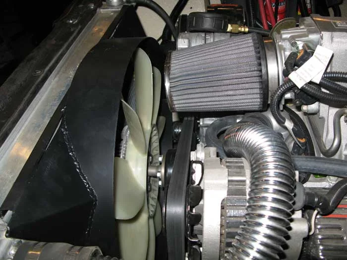

You might give Lance a call at IronPig Offroad, he did my 350 install and built this fan shroud. I'm not sure the brand of radiator.

Wow!!! Sweet set up Lou!!! Might be outta my budget... But I will check it out. Looks like a custom shroud. Thanks for sharing the pics.
