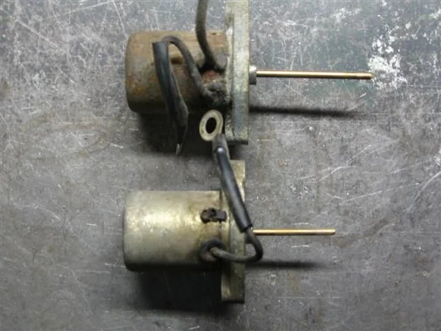

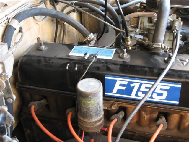

Got the solenoid today and installed it. The old one had a broken power lead and the pin had been cut down. I also swapped out the secondary jet from 200 to the 175. Seems to run (no road test yet) better. I am shooting to retest next Friday. In the meantime, I can get 30 day registration and drive around some more.

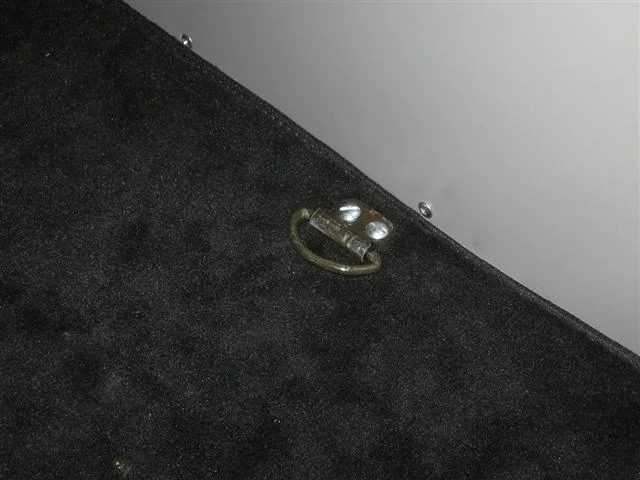

Added the SOR carpet kit and some hold downs. Got a few more upgrades planned before the weekend too.

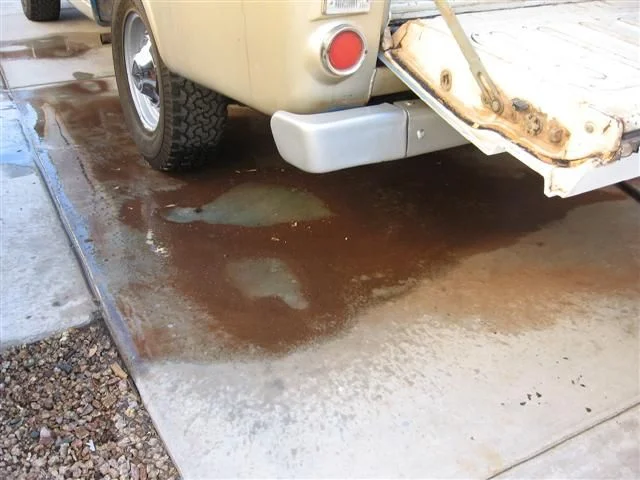

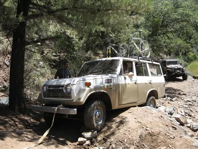

Here's a couple of shots of the 55 on it's first wheeling trip. Made it back home with no problems...................just alittle rock rash and a leaky battery (discovered after sitting in driveway awhile). It was about 150 mile round trip with about half off road.
