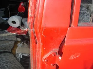

The first picture is a picture of some stress cracks that I have around the drivers side door.
- Question... Can I just weld this up and be good? I weld pretty well but I have these all over my drivers side door and a couple on the passenger door.

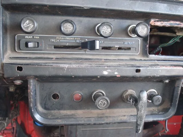

The second pic is of the dash controls
- Question.... So I have no idea what some of these controls do. I have been able to trace the heater fan control as well as the obvious wiper control but when I traced the left pull switch and the most right switch they lead to nothing on the firewall. Any idea what these are suppose to control? Thanks guys

The far left pull knob traditionally goes to the choke...

Choke - Wiper/Washer - Central Vent - Throttle control
space - FD indicator - FD=Front drive - PO mod?!?Throttle cable? - Cig lighter.
Its all I got

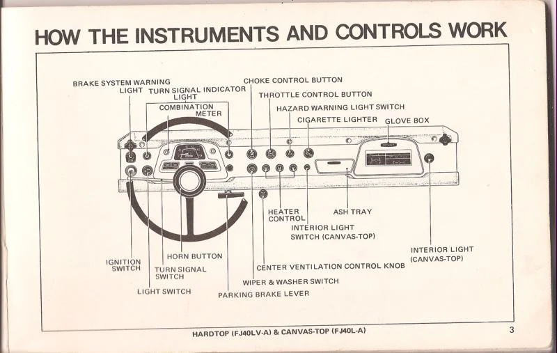

Here you go!

vacuum transfer shift...actuater.
like that scan..."heater option"

do you have floor shift for the t-case? some PO's will leave the old t-case set up still in the dash.

Thanks alot guys... you are extremely helpful. I have the transfer pull on the dash, not the vacuum or the floor shifter. I think that you answered my questions tho and I really appreciate it!

Your T-case pull = Vacuum shift
Lever is the hi/low range

So the dash pull is a vacuum? Hmm that is odd... any idea how that works? Seems like that could be an issue on trail if I loose vacuum, What do you guys think?

Vacuum portion is just a switch. When you pull it, it goes to 4wd and stays there no matter the vacuum. It doesn't behave like the ARB lockers where you loose air and it unlocks.
But, to answer your layout question for the lower part:
  • blank - not sure... mine has it also but didn't have anything in it either
  • red light - 4wd indicator
  • F.D. knob - 4wd pull (this goes to vacuum switch on firewall in engine bay
  • H-N-L handle - this is the high low handle for the transfer case
  • cig lighter - uh... cig lighter

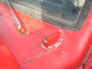

Another quick Pic
Hey Guys What is this? Has anyone seen one of these installed in their pigs. If so where can I get the components to get a spotlight back on here? Thanks
Carmon

that was put on by a previous owner, one of the many things you'll probably find on your rig.

This wtf moment has been brought to you by..... duct tape.

I broke my pickup and had to use the Pig for wheeling yesterday, love that big ugly thing.
It's a 1969, early, like yours. Before you pull that fresh air vent knob, clean out the junk. It goes to the vent infront of the windshield. Those are a cool thing other pigs didn't get. The throttle control is something I've never seen hooked up, but is still intact on my pig.
I have the dash 4WD and hi-lo lever and I love them. It always goes into and out of 4wd and low without any hassle. When I first got it, the vacuum diaphram in the transfer case was bad. It was cheap, available from toyota, and easy to change. The vacuum actuators seem to last forever. I really prefer the dash set up. A plus is that modifying it for 2WD low is simple, there is just a pin to remove under the dash, that's it. No tools needed.
The rubber is crazy priced in my opinion also, but that's how it works. I really give props to those who stepped up to reproduce them (like PVCruisers). Too bad they ain't cheap to make. FJ55-100 used a windshield rubber gasket for the cargo windows by cutting it to size and glueing it back together. It looked very nice and was cheap. With the profile of the window frame, universal rubber seems like an awesome idea.
My pig also has a toyota power steering conversion. I run a supra pump on the passenger side. (currently kind of rigged, need to change the harmonic balancer on the new motor I installed. The old F145s came with a 2 groove pulley). I have 33" TSLs on it and it turns super easy, 1 finger steering on the road. At low RPMs on the rocks, there is much to be desired but still way easier. The FJ60 setup is way pimp compared to the stock setup, but the stock still works great. If you never need to get too crazy in the rocks the stock toyota setup is great. The pump arrangement is bad though. I have a weber, but am hard headed and refuse to use the tiny airfilters and have a stock one instead. With a stock air filter and PS, something has to go.
