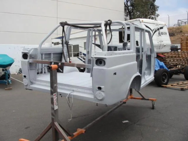

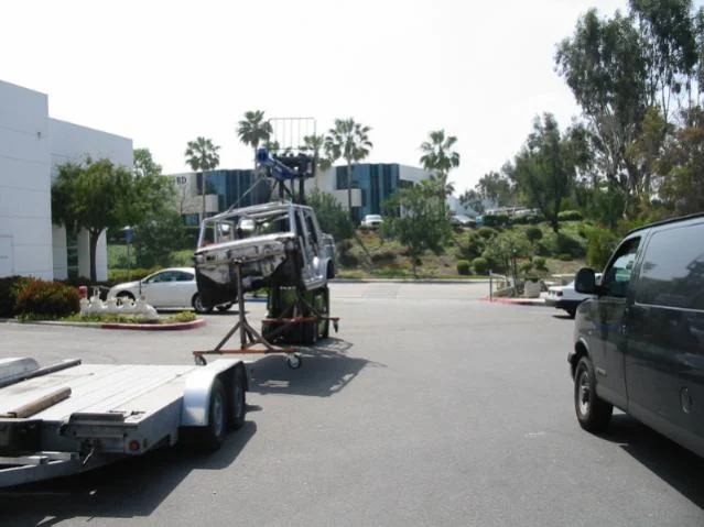

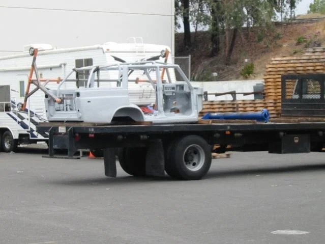

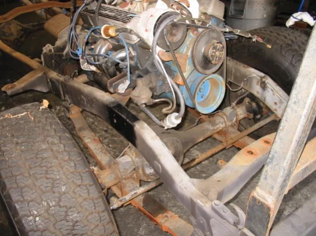

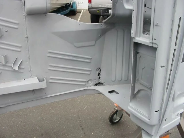

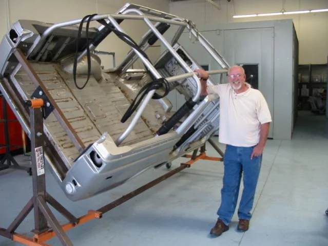

Well, I've finally sent my fat piggy body over to the Sandblasters shop. I hope there's some metal left!! Can't wait. I'll get some pics posted when it's out and primed. Later all. Keep those projects alive!! Noah, thanks again for the awesome Rotisserie

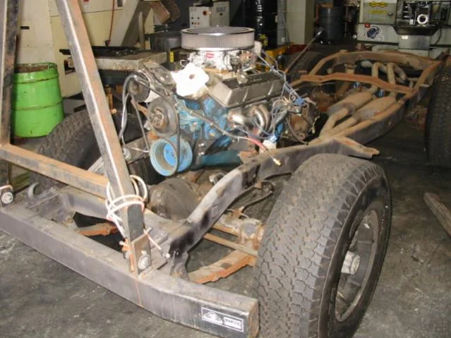

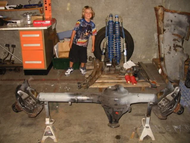

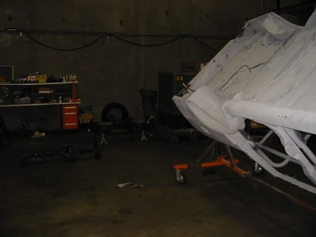

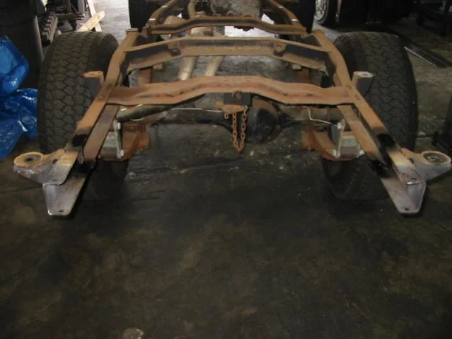

Well, now that the body is at the blaster, I can do a little more prep on the frame. I've removed the steering(putting is a FJ60 PS setup), and the shock towers(making room for the Fox Coilovers). I also removed the rear crossmember because of the severe rust. I'll have to fab a new one with a hitch receiver built in later. Three day weekend might give me some time on the pig?Enjoy the barb-Q's!!

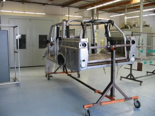

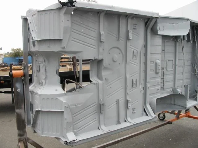

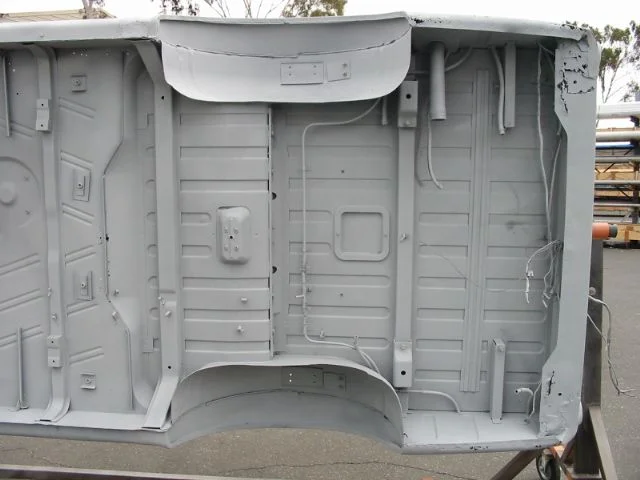

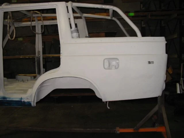

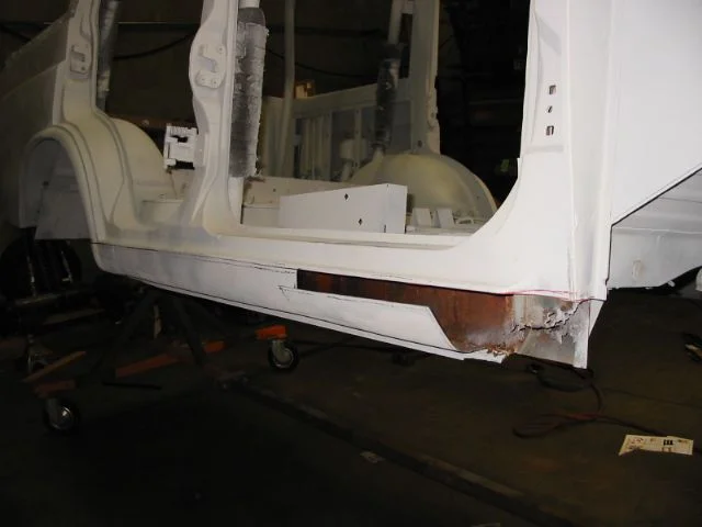

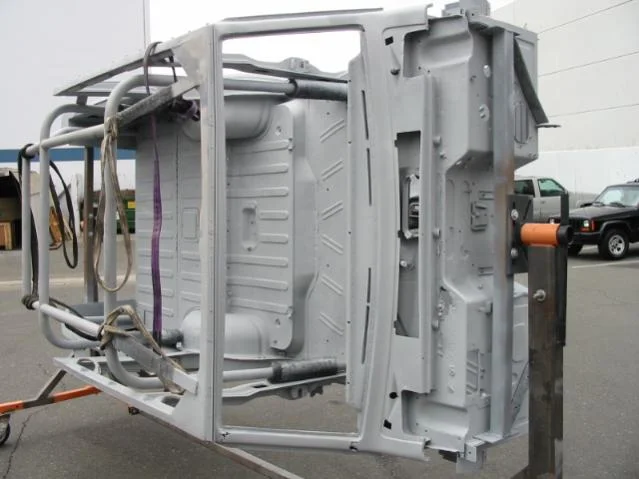

Back from Sandblasting!!!!!!!
Well, I now am the proud owner of a 1972 FJ55 with no rust I now have some sheet metal work that needs to be done. The bottom looks really nice. It's so clean. I'll post more pics when I can.
Later all

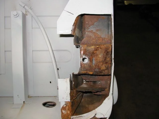

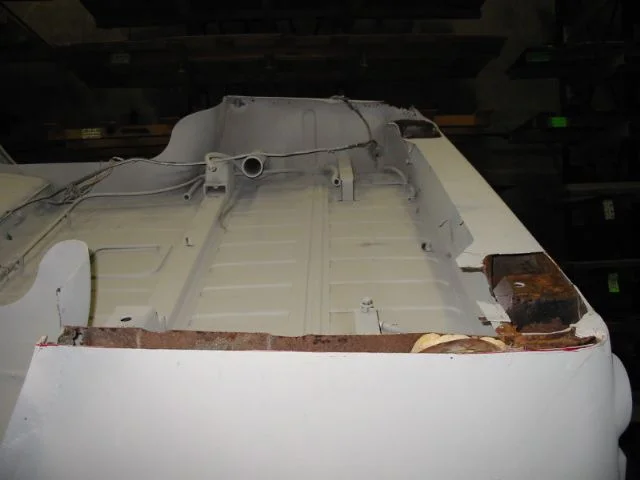

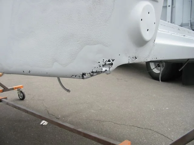

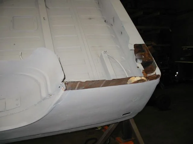

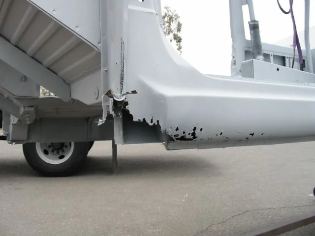

Sheet Metal work needed!
As you can see, there is some missing metal. The important ones are the rear corners where the mounting holes are. I'm going to cut out the rocker panela and run some heavy wall tubing sliders. I'm going to do that up to the from wheel well, and also behind the rear tires to the rear bumper that I need to make still. This will be the hard stuff.

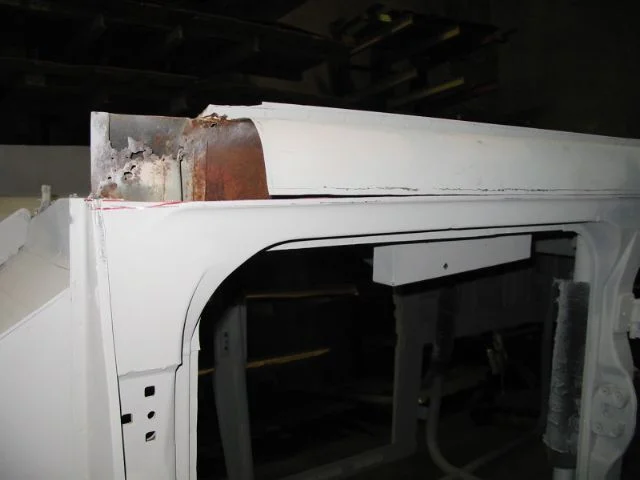

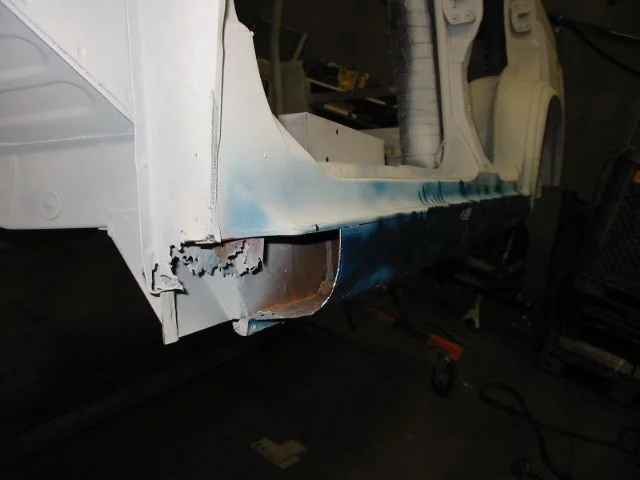

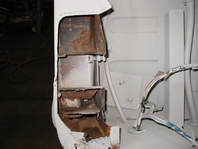

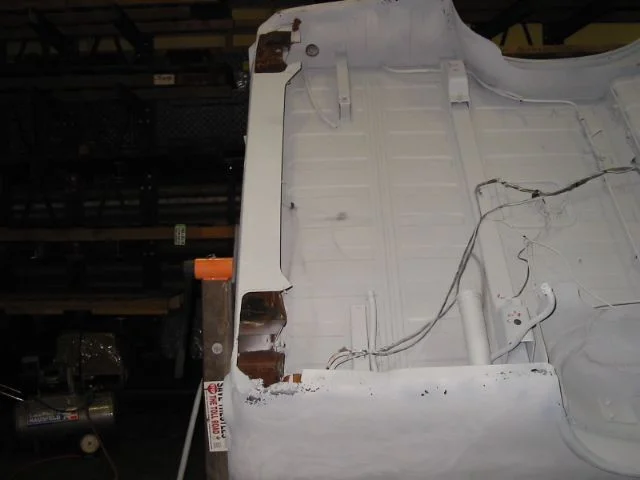

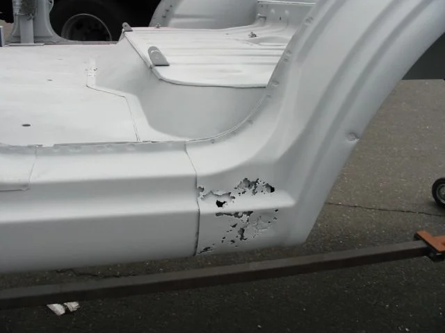

More holes
Need to get a die grinder with a cutting wheel and make some sparks!!

actually Pat, really does not look too bad, my truck was about the same, I should of had it sandblasted for sure, lesson learned, I spent a month chipping undercoating from underneath of it with an air chisel, although I don't think any sandblaster could of gotten through that stuff, it was like an inch thick! let me know if you need help, I could come by during the week with my daughter and take a look at it. Also, do yourself a favor and getting a small air saw, these work great and allowed me to get in tight corners to cut out that thin metal and place some patches in there.

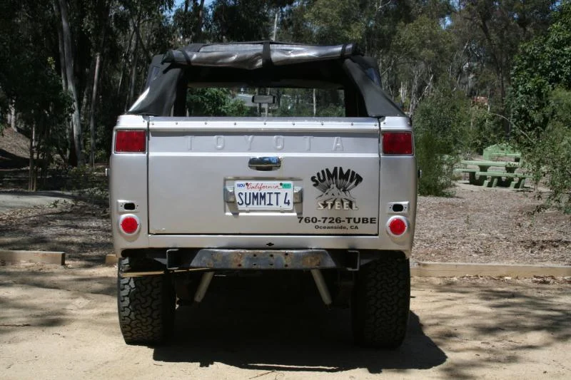

Noah,
Where did you get your Air Saw? I'm not sure what those look like. Did you get yours at Harbor Freight? You should come by. Let me know when you and your daughter can.
Summit Steel
2612 Temple Heights Drive
Oceanside, 92056
Later
Pat

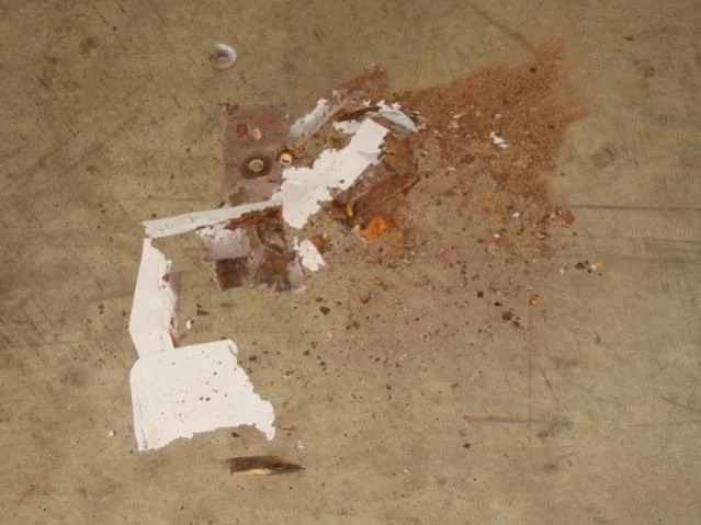

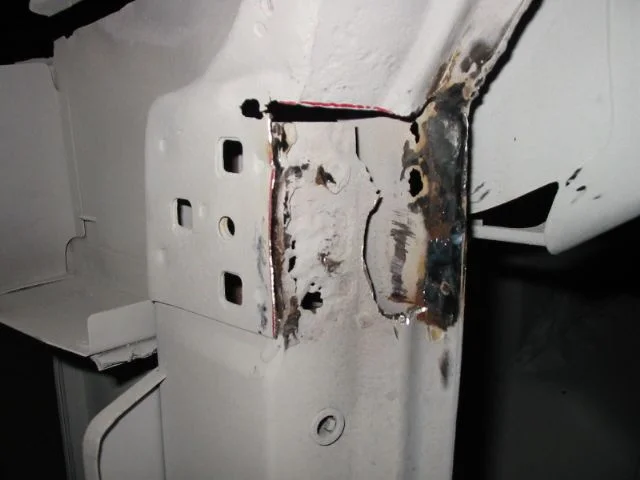

Got a little time to cut out metal
Well, the corners that I've been dredding are now ready for some new metal. One corner was a little worse than the other, but about 15lbs of shit came out of them when I removed the top layer. I'm going to use
14 ga sheet when I make replacement pieces. I'll be dead whe that rusts through again.

Wow! So that debris was between the inner and outer quarter?

That's what come out If those rubber panels are missing that cover the pocket where the bolt to the body goes, then they collect all kinds of

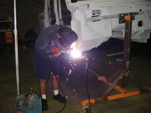

Had a couple of hours to spend on it today

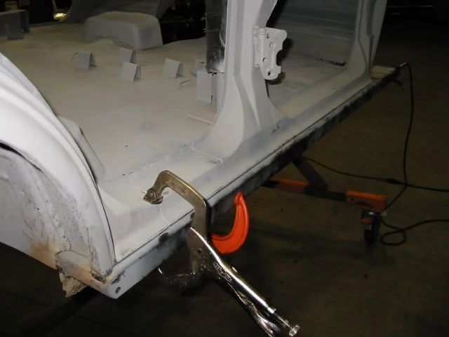

I got more cutting done on the Phat Pig Body. Making room for my side and rear sliders. Rear body mount will need to be rebuilt. For Fathers Day, I get to spend a whole day on my rig

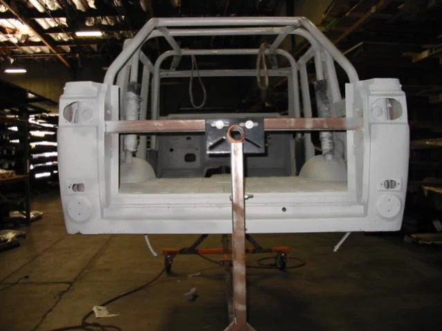

Posts: 327
more pics
mas Mine as well plug my business. Later to all and keep the projects alive!!!!!!!!!!!!!!!!!!!!!!!!!!

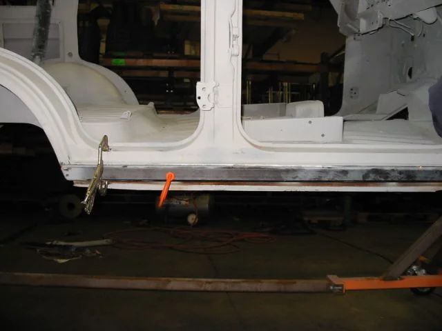

more body work
I've got the sheet metal pieces cut out for patch work. Almost done cutting the rockers for the sliders to fit both side and rear.

more pics
I've got a shot of my 6yr old son next to my foxy's.

Location: Carlsbad,CA
Posts: 327
Sliders getting done
Well, I had some time to get the sliders fabbed and welded on. 2"x 4"x .250"wall should be stout enough. I'm welding them to the body while it's off, and them I'll put some supports to the frame after they meet again. I'm going to run them all the way to the front wheel well. I've pretty much got all the bad metal cut out and have made some patches. I'll get those welded in sometime soon. Gotta keep going. Gotta keep going. I keep telling myself. I'm afraid to stop, because you know, sometimes you stop for too long My business has been slow, so I seem to have a little time during the day to put some time into it. I'll post more as I go. Later all
