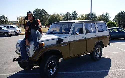

Hi FJ55 people!
Last week, I bought 1TonToy's FJ55. What a great looking rig! Australian right-hand-drive, little rust, nice Dual-Fuel Propane setup, big ol' 10-leaf springs, 2F, aftermarket header (the good kind supposedly), Front buckets, H42, 10 gallon tanks, aftermarket and CB radio, 2 1/2 in. lift, dual battery hookup. I don't have any plans as of yet, but zuluzeugma wanted to SOA it. Valves need to be adjusted, knuckles need rebuild, and t-case need a thorough inspection. I'm thinking stock wheels and bench seat?

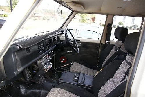

s'more:

Yeaaaaaaah Baby!!!!!!!! That's a nice rig firstade. What a sweet looking interior. Stock wheels w/ caps and a lift will certainly set off a truck that is otherwise just plain nice. Congrats on your purchase and here's my welcome to you. Dave
Looking forward to hearing more about your progress (although you're in the 23rd century while I'm circa 1495 on my progress!!!)

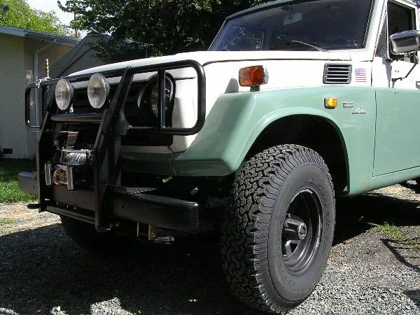

Maybe I'm missing something. You want to SOA that? Blasphamey. (Chuck will disagree) It looks to good to trash on the trail. There are very few barn door setups in the US. I cannot imagine very good performace out of a dual fuel setup with big tires.
I'd say keep the lift you have. Get some more aggresive tires. Maybe some taller pizza cutter BFGs KO's on stock rims and be done with it. Go SOa and expect to spend a lot of money. Gonna have to go power steering then.
Stick with the buckets. Just a lot more comfortable ride and much better on the tail. You will be sliding all around. Spend you time fixing the rust. There is probably more there than you can see. Refine all the little things and improve the ride. Maybe some Bilstiens, new body bushings, sway bar bushings, a bumper and a winch. A PTO would be the bomb.

I'll second troll on the lack of performance from dual fuel setup. Reg gas might work okay but propane would suffer: my understanding is propane needs higher compression than gas.
On the SOA, depends upon tire size and wheeling you will do. I think 35"+ need SOA. I went SOA on mine because of planned 35-37s and rock crawling(well, that and an engine problem)
On the bench seat, I am going with a 60/40 split from a Tacoma in mine... I want to have it look somewhat stock

yes, 35s will be cutting it close for sua, unless you go real skinny. also, keep in mind that there's not much to cut out on the rear fenderwell, so consider that when looking at the diameter of the tire

thanks for the feedback guys. I know I want to grab a pair of OEM's, and maybe 33's? I said I would initially wheel it, but I have second thoughts. It's in good shape. It doesn't have the ambi doors though.

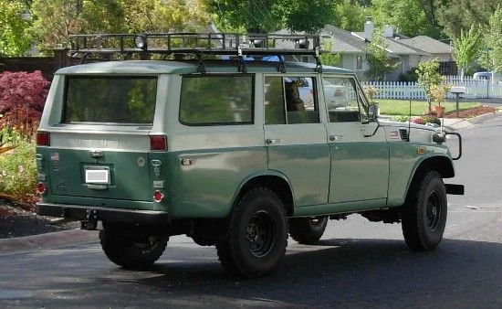

What are the tire sizes on this rig?
[IMG]file:///C:/Users/Andy/AppData/Local/Temp/moz-screenshot.jpg[/IMG]http://forum.ih8mud.com/members/trollhole-albums-cruiser-stuff-picture827-image4.jpg
That is almost exactly what I wanted to do: That tire combo with a nice fabbed rack and bar.

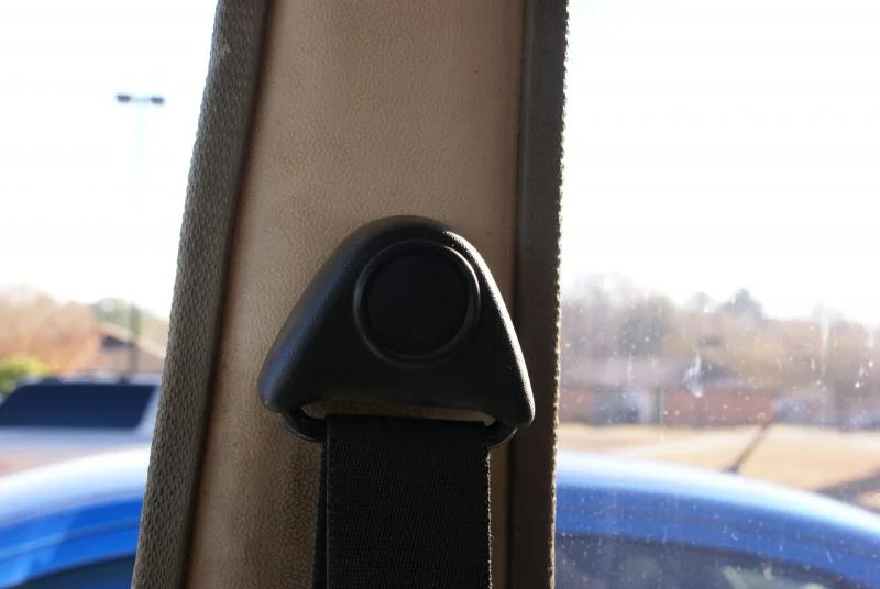

Are those factory 3 point belts in the front?

seatbelts
They look original to me.

Could I see a picture of where/how it mounts? The only 3 point Piggy belts I have seen mount in the roof over the rear doors. If there is emough meat in the B pillar I will consider mounting there...
