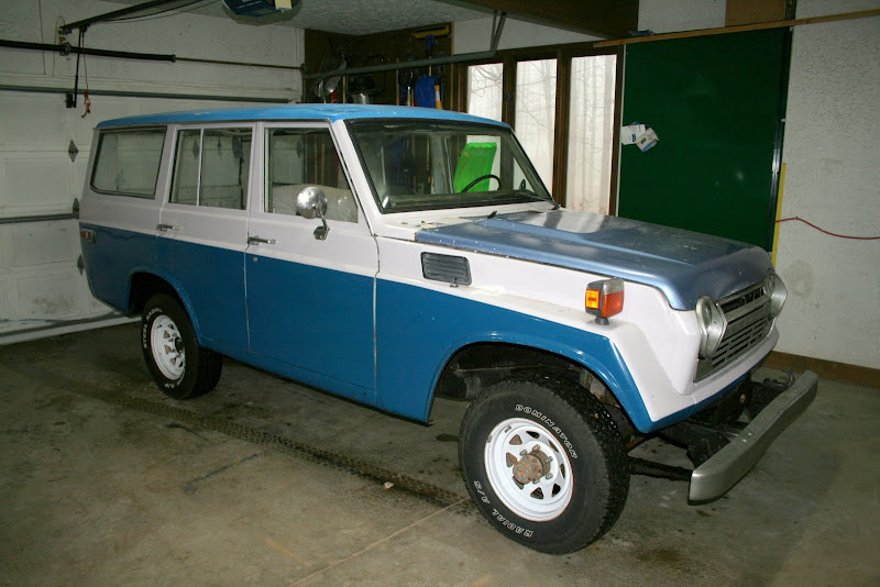

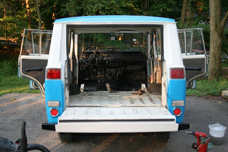

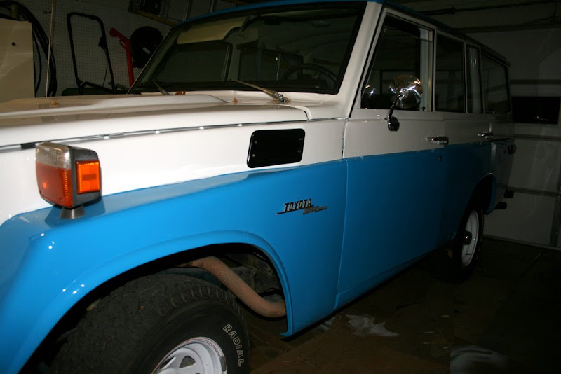

I wanted to use this as a DD. I work at home and don't drive a whole lot, so I am a great candidate for a less-than-economical drive-around truck. I probably only drive 20 miles per week.
AZ was very kind to this truck in terms of rust. There was bondo in all of the usual places, and a hole and some rust in the passenger floorboard due to AC water drippage - but overall a good candidate for a restoration. When I got it, it had a coat of Maaco on it, colors weren't stock and the dividing line between blue and white was in the wrong spot. The drip rails were perfect though, and even had the piece of chrome!
I took much of the paint down and re-bondoed the usual bondo spots, then I sent it to Maaco. They added $100 for the two tone.
This is what a fresh coat of Maaco paint looks like. Other than a few tape marks and masking problems, they did a pretty good job with almost no orange peel. Not bad for what I had in mind.

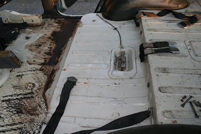

The cargo side panels were shredded, headliner half gone, some floor rust with one small hole, etc. I patched the floor hole with JB-Weld and sheets of tin, and painted all of the surface rust with Eastwood rust converter followed by their rust encapsulator.
One of the worst rust spots on the whole truck was on the passenger-side floor:

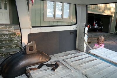

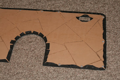

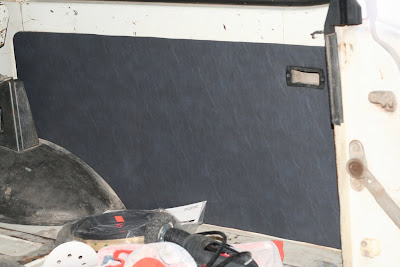

I built new cargo side panels using the sheet wood from a "scratch-and-dent" door that was $5 at Menards. I also bought the charcoal-gray pleather from a fabric store at an extreme discount. I think they turned out pretty nice. Eventually I'll do the front doors as well, and then if I have time, I may replace the passenger doors too just to make them match. (That's pretty low on my priority list though.)

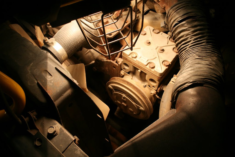

Nice Pig and write up. Could you post some photos of the A/C?

Sure- here's the AC pump:

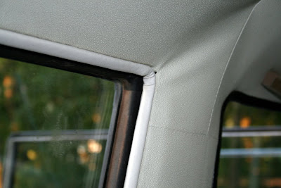

Headliner: I had my local upholster guy install my SOR headliner- There is a thread on here where I talk about it more - but basically, I had to deviate from the norm a bit.
What it looked like when I got it:
In order to replace the headliner you need to take out three windows - the front, and the two rear cargo ones. This means replacing the weatherstripping. This truck has a new front windshield put in before I got it, so the weatherstripping up there was new and soft enough for the upholsterer to be able to tuck the edge in with contact cement.
The auto glass company warned me - they said that there was a 30-40% chance that they would break the side cargo windows. Rather than take that risk, (and to save the price of the cargo WS in the process,) I thought of a way to attach the rear of the headliner around the windows without removing them.

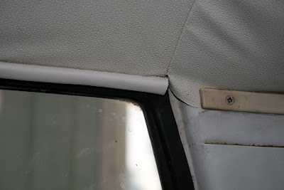

There is a metal lip that runs around the rear windows, and I figured you could screw in a small "seam strip" of sorts over top of the headliner edge. The upholsterer took it a step farther and did a pretty nice job, here are close-ups of the tricky area:
The photo above right shows the stock ivory-colored plastic strip that I thought would work along the edges of the window - that was what I was hoping for and would have been happy enough with.

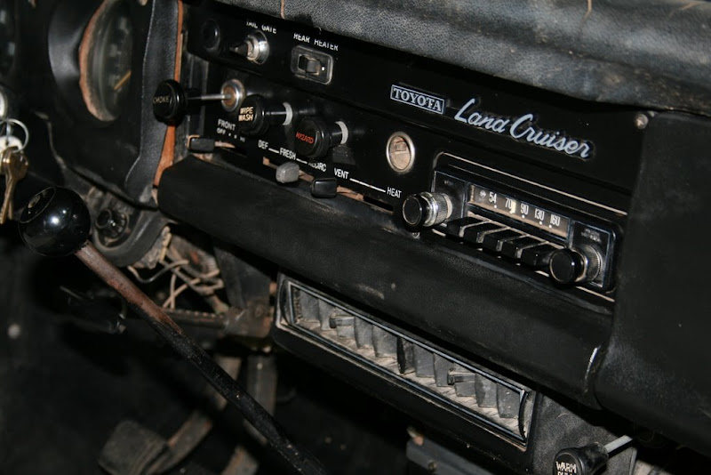

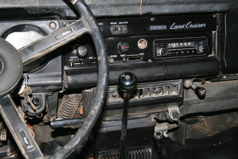

The dash on this old thing was 100% torn up, along with the steering wheel - just flat-out baked by the Arizona sun. The heater and blower works, and the original AM radio works. I haven't decided what to do with it though... install speakers and go with it? put in something new?

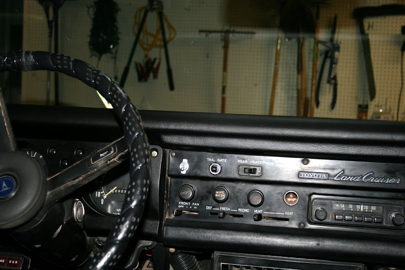

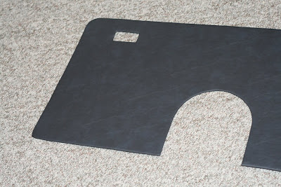

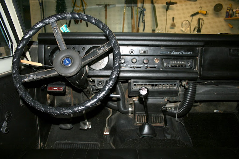

Now for some "after" photos. Here's one of the dash cap from SOR- it looks great. After getting it on, I didn't even bother to glue it down:
Also notice the switch I put into the dash to replace the old dome light switch that was broken off:

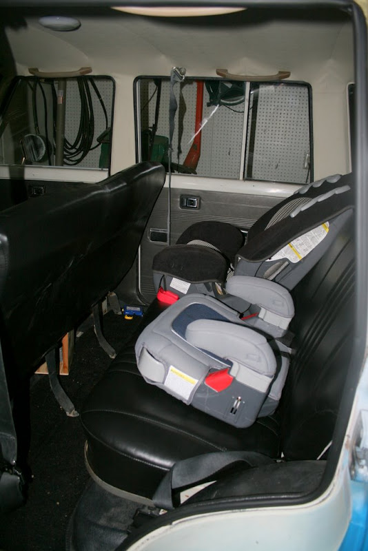

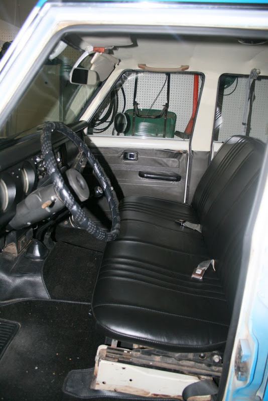

Here are some shots of the seats I had recovered, doing them in one single material saved me some money.

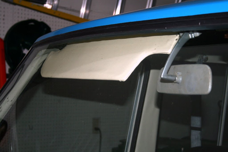

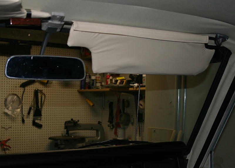

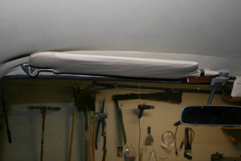

My wonderful wife re-covered my sin visors with vinyl, it's like a bag with a strip of velcro along one end to hold it closed:

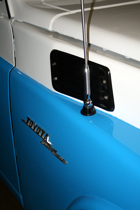

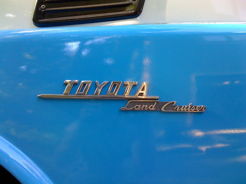

When I got Old Blue, there was one emblem - in the glove box. I really liked the older style fender emblems better, so after painting, I found two of them and put them on. One of them came from a super nice person here on these forums - given to me for free. I can't tell you what a great group of people these piggy owners are.
This emblem, being angular and looking classic '70's, really fits the look of the truck much better that the '76 script emblem that was originally there. Yeah, I know, it's not stock... but also not hard to replace if someone ever wants to go back to stock.
Also, note the new antenna from Autozone.

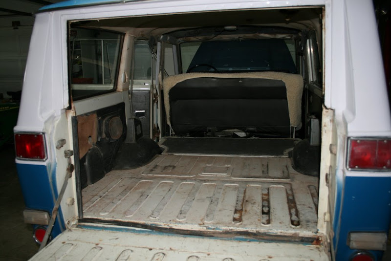

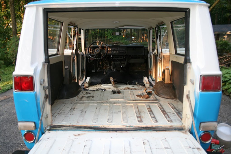

Here's some neat shots from the back with the seats and carpet pulled out. Look at how nice the floor is back there.
