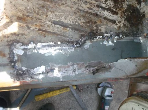

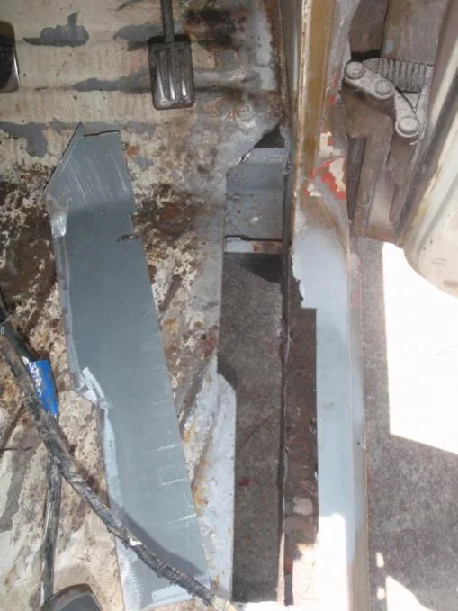

these pics are of the right hand foot well. not too bad actually body mount is still pretty intact. just the floor itself.
first is the hole i cut to remove the rut back to clean, weldable metal.

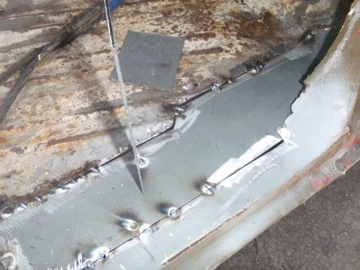

second is of my method of holding the new patch in place and flush as i welded it. what methods did u guys use? i was not sure how to do this....
and finally the slow tedious task of tacking it in place.

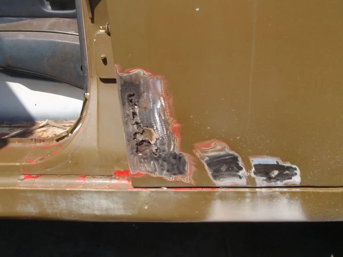

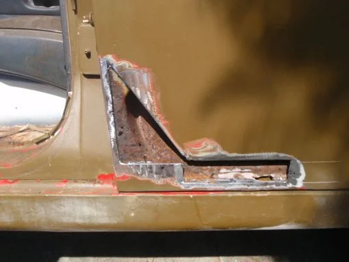

some more rust repairs.... (how many times will i say that tatement by the end of this ) this time the left rear door.
the rust that i exposed with the flap disc.

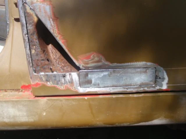

then the second is the hole i cut, tried to keep the edges as straight as possible so the patch was easier to make, this a good idea?? or is it just do what works for you??
then the first of the 2 patches sitting in its final location

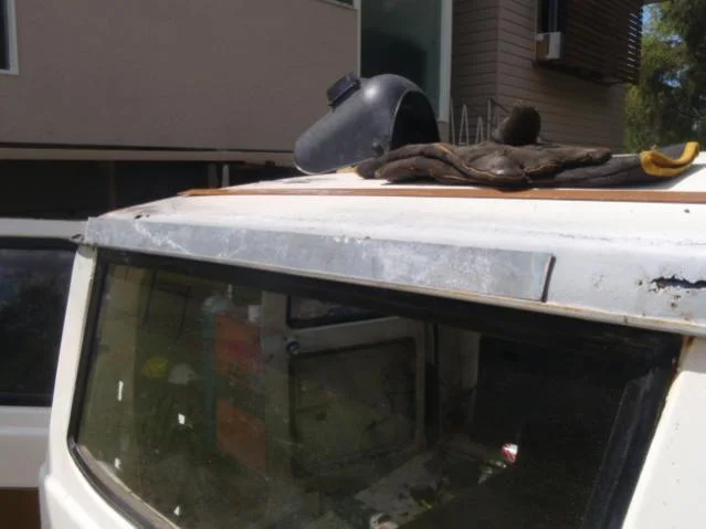

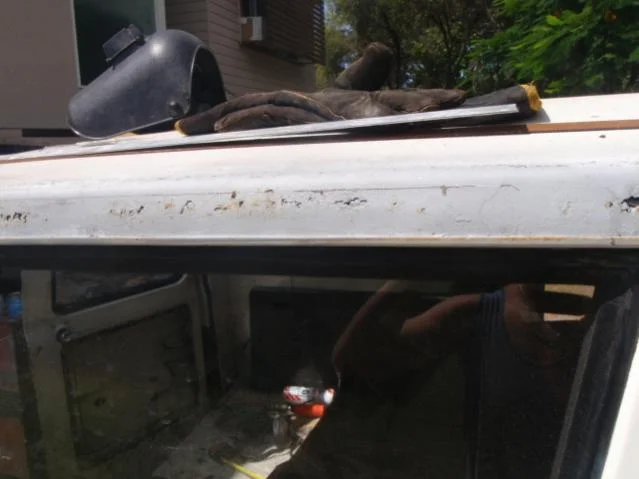

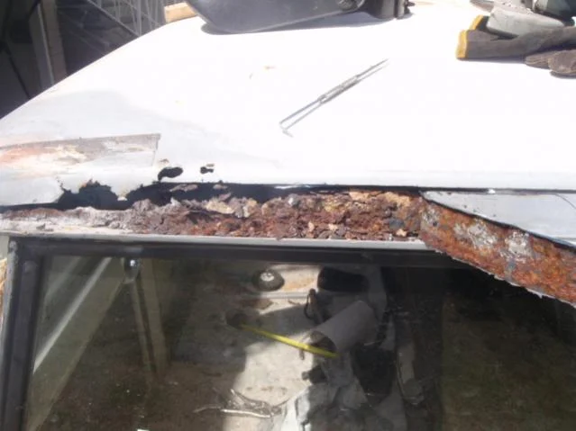

more rust.... this time the right rear roof rine rust.
before
during
new patch, just sitting there, not yet finely shaped to fit.

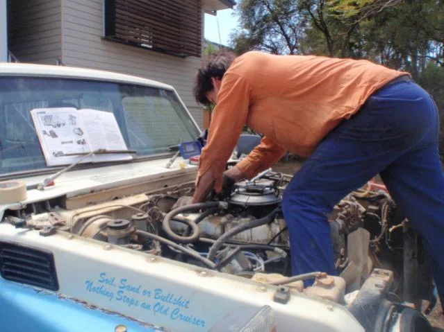

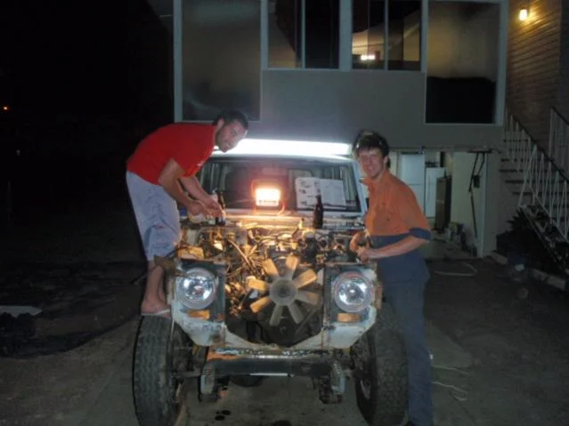

pulling the heart
this is a few pics of me starting the removal process,
first pic is of me and my super clean buddy (or apprentice as we called him for this project) he left at the end of the night that clean too. some needs to bag and tag the stuff that gets pulled off :P
me "hard at work"

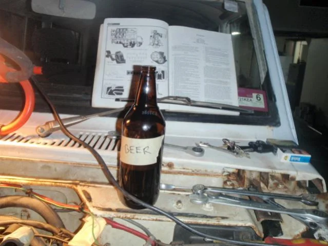

last is a pic of my beer, the boys thought it was funny to label my beer. i was labeling everything with almost a full sentance describing what the item was and where/what it bolted to.
oh and one of my, now many, workshop manuals in there too

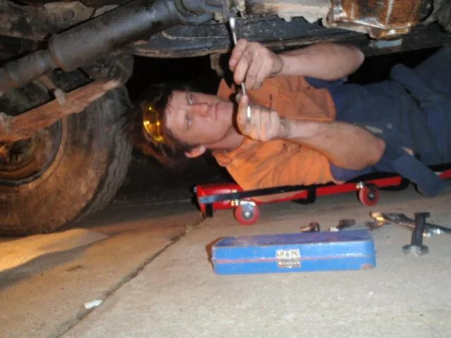

more pics
"see im actually doing some thing" is what he was thinking im pretty sure. he was good at handing me tools and getting me 's
se i ALWAYS wear my Personal Protective Equipment! the glasses are protecting my head in this one. looks like it was something difficult. haha. i think this is actually step 21 undo front propellor shaft from transfer output front shaft flange
