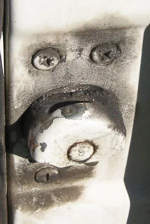

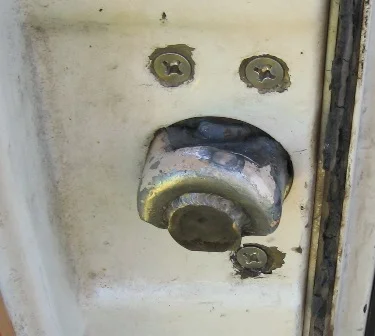

fj 55 door latch repair
The cup that supports this gear shown, also acts as its' bearing. Given, it's a treated surface and all but time and rough service (ya, right, like that never happens, the rig defines rough service) tend to hog out the cup material around the gear shaft. I can think of much better (read easier X 10) ways to do this, SO, maybe a forum, what have you done? Okay, I'll admit, just another way to satisfy my nipple fetish! Picture shows a gear shaft bearing surface in good condition. And guys, that's 23 grease fittings.......me thinks. 24?

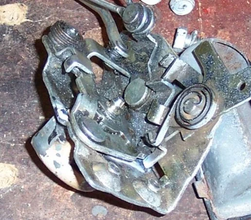

Step one, how hard can it be?
Ya hu, how hard can you make it......Rip the cup off the latch, drill through from the back of the gear shown clean through to the other side, no country for hss drills there, no sirreee! AND THEN, to make it near impossible, chuck up a drive in type grease fitting, turn it down to hole size because you were too afraid to go bigger. There you have it....a door latch fitted with a grease zerk.

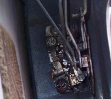

No country for a grease gun
I challenge anyone to say that they went to their Papa when they were a kid and said, "Papa, I wanna be an automotive door tech. when I grow up". No room for a grease gun back here so the connecting rods will have to be disconnected to gain access to the grease fittting. Picture shows an unmodified, installed latch.

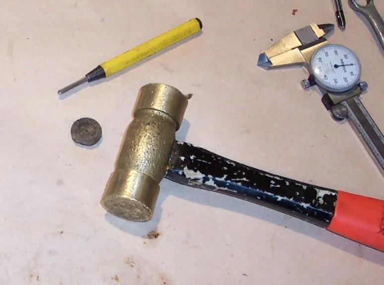

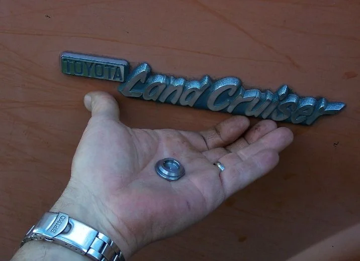

Cup insert
Made this from oil hardened drill rod using a lathe. Goes over the cup end of the gear shaft.

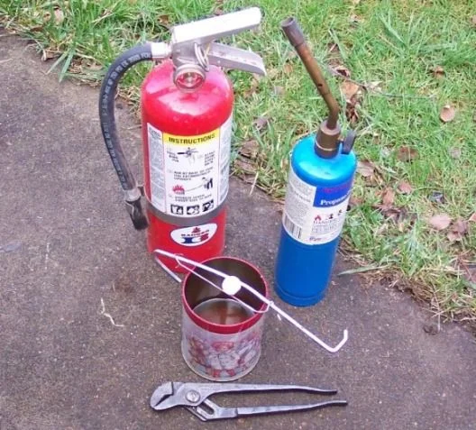

Heat treat
So you think I'm going to treat you to a lesson on the sophisticated science of heat treating steels? WRONG, get real, it's Bill Bob in his Carhartts doing some home heat treatin. Cook it till it is glowing orange, into the bucket of oil, I'm a thinkin thats what theys a meenin when they say oil hardened.

How hard can it be?
Fancy harness testing equipment? Come on, just picture the guy doing the heat treating. Another excuse to swing a hammer, smacked the insert with a punch. Not even marred and did not shatter, both, good signs.

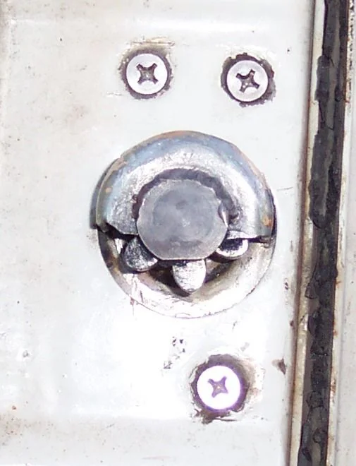

Putting it all together
Good time to know a good Welder, thanks' Adam. The insert is welded to the cup, the cup welded to the latch. Greased and installed, it works, plenty of clearance. Like I said, there has got to be an easier way. Road testing is now under way.

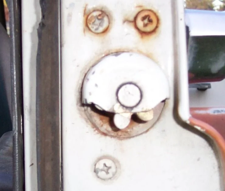

I like it, but I doubt there is an effective repair for a failure like this:
When it's gone this far, the back end of the shaft is very loose too.
It does look like an excellent preventative step. As long as the insert doesn't deform much over time, it could sure slow down the wear on the back end. If you start off with a relatively good part, I'd bet your solution will outlive the rest of the door.
As for using a rear latch in the front, I looked at this a few months ago but haven't tried it yet. To make it a dead on match, you'll have to remove three pins and transfer over several pieces. Pictured below are the right side latches, front on the left and back on the right.
I don't have the machining/mechanical experience to know the right way to do this, but it would be valuable. I'm sure there are a lot more working rear latches than front, and the problem will likely always be the cup, frame, and ratchet/pinion shaft - which look the same on the front and rear.

Hey, I'm doing the easy part here - photos and ideas for someone else to try. I'd wanted to start a latch thread anyways - either that or I already did and forgot about it. In any case you're doing some very cool work there.
Here's what happened with mine. I suspect the door sheetmetal on the bottom hinge failed first, causing the door to sag. I have some serious cracks there. This caused the latch to not quite line up, requiring a serious slam each time the door was shut - there is lots of wear on the strike plate where the pinion was hitting it in the wrong place. The slam started causing the metal in the latch frame (between the pinion and ratchet) to start to fail at the same time the cup started to fail. Once it was loose enough for the shaft to pop out of the cup, each slam did even more damage to the frame because the shaft could pivot against it.
Lesson: don't let your doors sag.
I've rethought my earlier comment -- a stronger bearing on the cup side might be enough of a correction to make the latch workable. If I knew how to do the work, I would add your bearing to both cups. Assuming the bearing made the worn out latch work reasonably well, I would swap the worn out one to the rear to extend its life even further. I think what will happen is, the extra slop between the pinion and ratchet will cause it to pivot against your new bearing, wearing it out faster and possibly causing issues in the ratchet, long term - hopefully quite a few years. I don't know if the grease will help much, but it might...I suspect most of the wear is due to impact against the bearing surfaces.

The door latch mod has been in place now for a couple of months. I noticed what looks like a little more strike on the top of the the modified latch. probably casued by a slight misalignment during welding but that is about all. Just an update to let you know it is still working. Planning on painting because there is rust on the weld.
