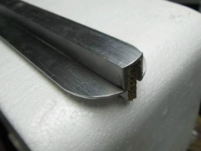

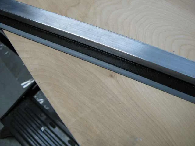

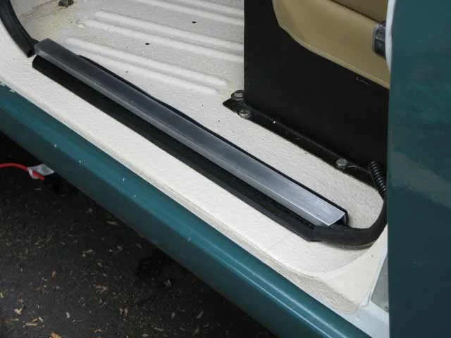

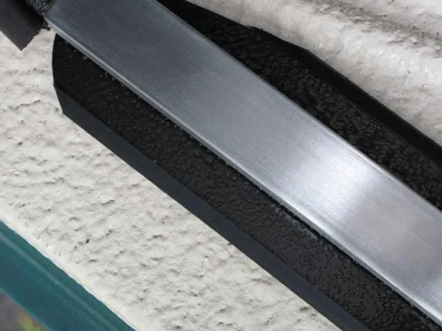

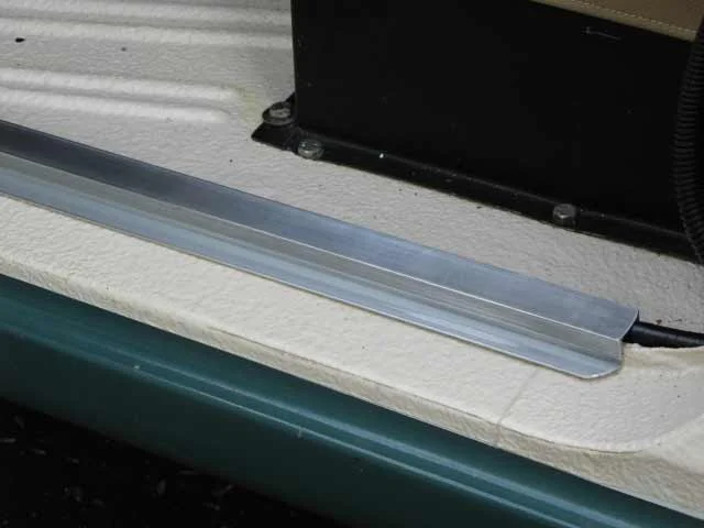

Started mocking up some idea's for scuff plates. Picked up some aluminum from the local hardware store and also a doorway plate.
Lou

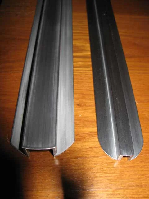

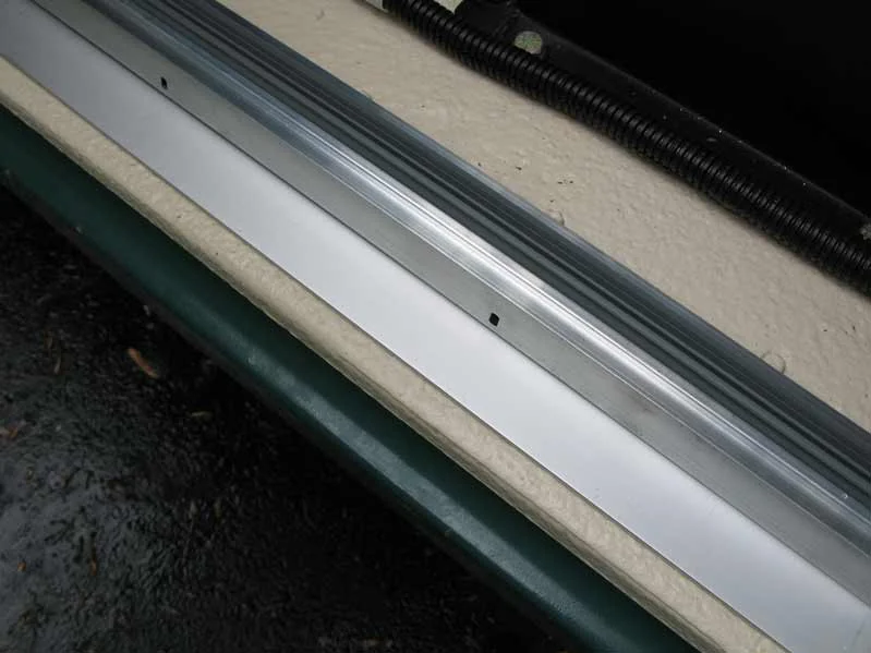

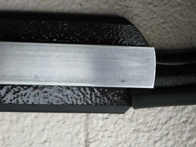

More pic's

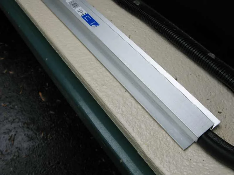

Scuff Plate

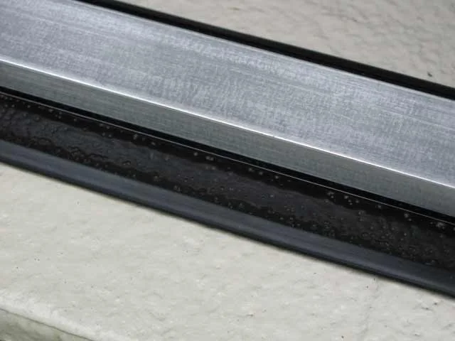

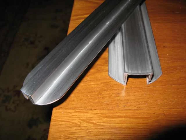

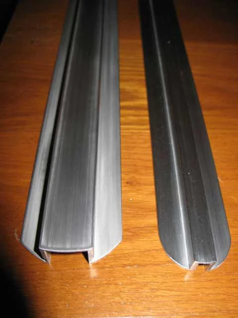

Another mock up,

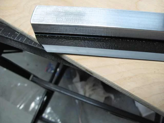

polished up

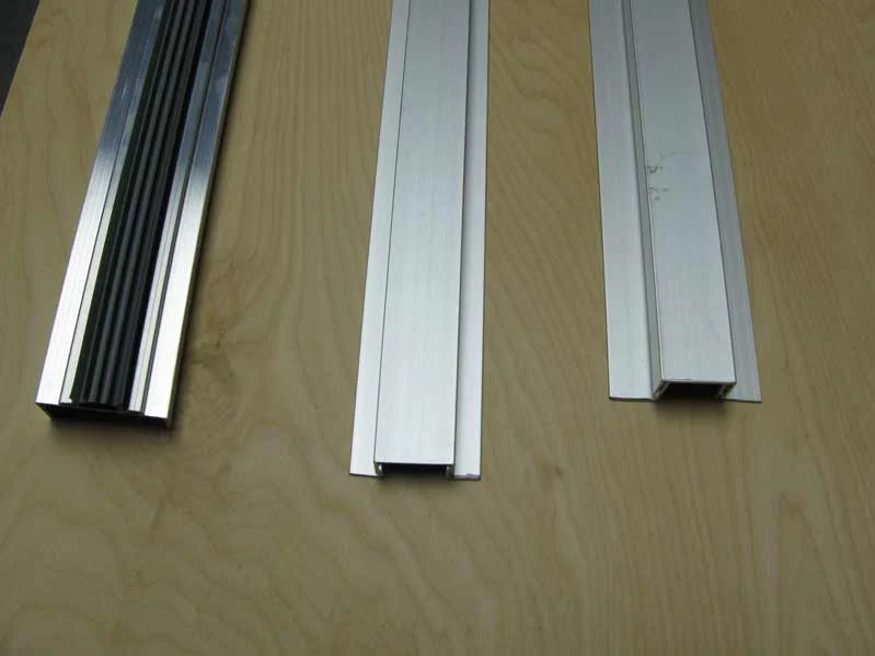

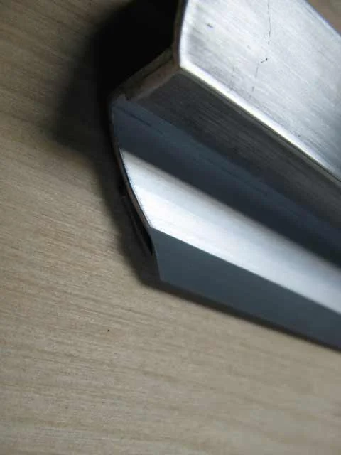

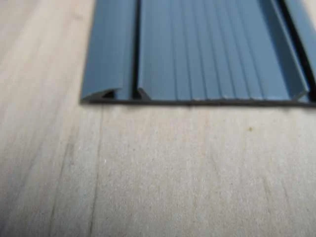

A little sandpaper, steel wool and Mother's, one of these should work. I'am getting close to something I can work with.
The smaller sample really came out nice without alot of work. Any thoughts , idea's , likes, dislikes?
Lou

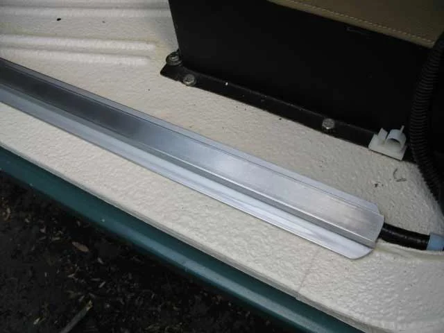

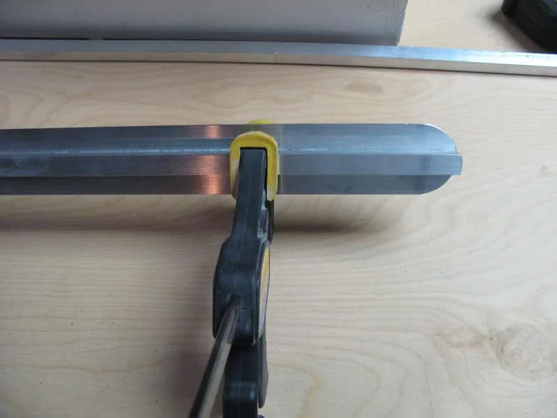

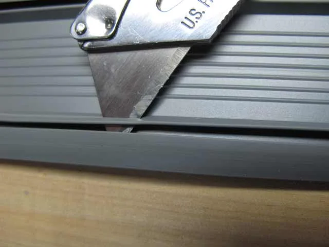

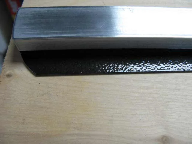

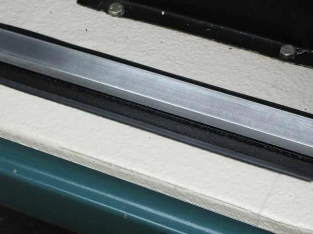

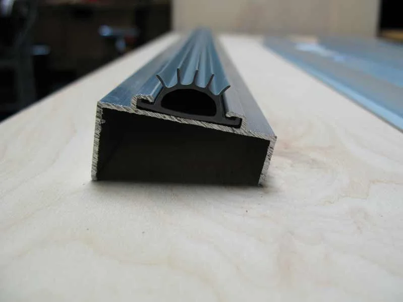

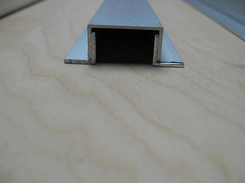

Ok, the wide version works great, as the wiring harness fits under it. I also found this threshold rubber with a little triming, fits the edge and covers the bottom of the plate. I just need to find it in black. Lastly I painted the lower portion in black Hammered paint and add the rubber trim.
This is not final but close.
Lou
