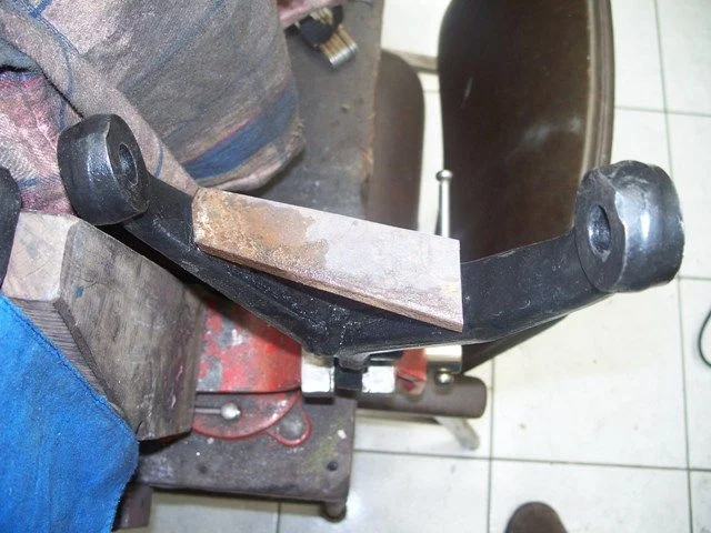

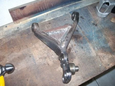

after a little pause (too much work) came back to my project. Due to the lack of HI-Steer I have decided to take momentary mesures Attachment 208980
the welding look not but actually it has been nicely done with 6 rod of 6010 an 3 rod of 7018, will be test on the trail soon (i Hope)
Attachment 208981

You need high steer. I doubt that welded steering arm will last long. How about sending a set of arms to "W" in Oregon-he can bend the stock arms into a hi-steer position. That's the cheapest high steer going.

Tratamos solder "steering arms" como estuviste; pero, rotaron muy rapido. How did I do?

Howdy! I was VERY lucky with my welded double steering arm. It lasted 20 years, done by a professional fabricator at the time. Nothing else was available. BUT, it failed suddenly, with absolutely NO warning. Fortunately, I was in a parking lot when fell off. I had just come off the freeway at 75+ mph! I highly recommend getting properly fabbriated steering arms for any setup. Bending them may be a workable method, but I think it will have negative effects on the steering geometry as the distance from the TRE to the centerline of the steering axis. I think it would make it a bit harder to steer and it would be very quick reacting, like a sports car. John

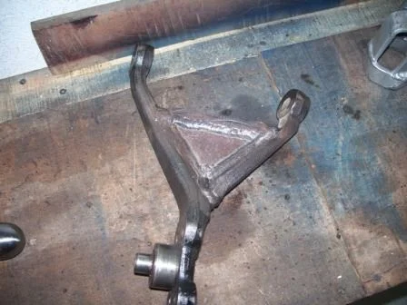

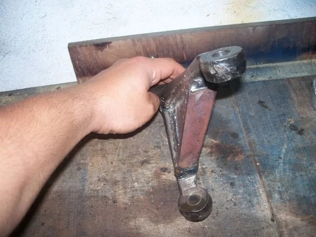

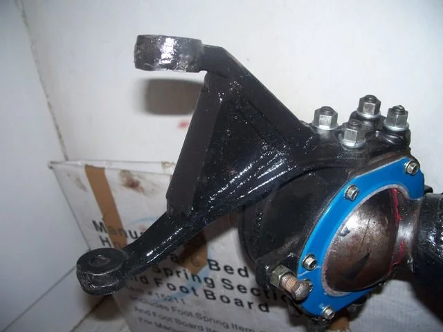

Old 02-25-08, 11:22 AM   #21 (permalink)
Forum Regular
animaldevictor's Avatar
Join Date: Oct 2007
Location: San Jose, Costa Rica
Posts: 138

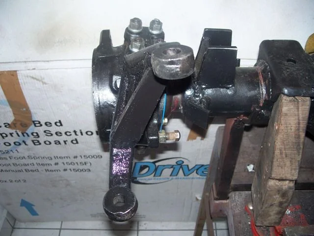

John thanks for the advice, yes actually the point of builtding the double steering arm a like just for a while until i get the money and the means to get the high steer from 4X4 labs or some where else , i was also wandering , well go to my friend the machinist and ask him if it´s also able to made the hight steering arms here, well i think if that costme the same than getting the high steer in US and shiping down to Costa Rica, but in the mean time i have mede reenforcements to the double arm, at least to last me enough to get the others later

Old 02-25-08, 11:37 AM   #22 (permalink)
Forum Regular
Join Date: Oct 2007
Posts: 138

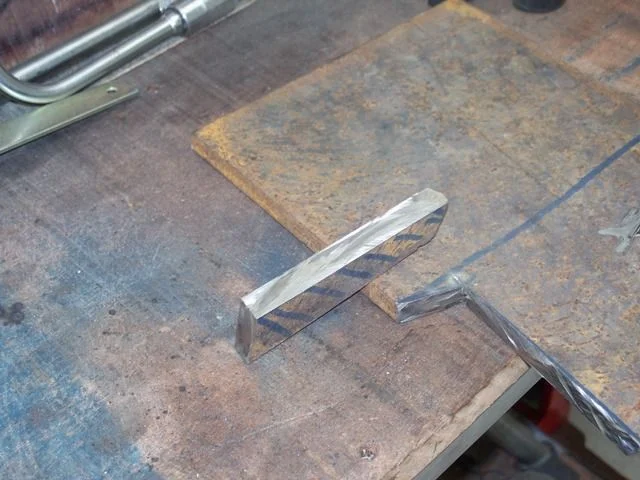

here are the pics of the welding proccess

and back to it´s place

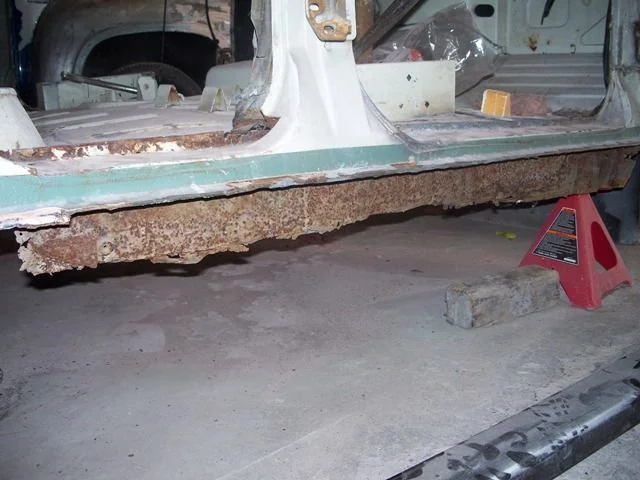

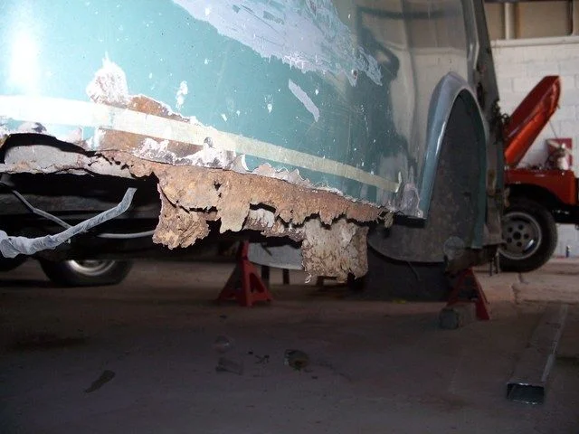

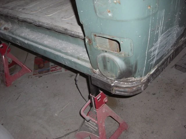

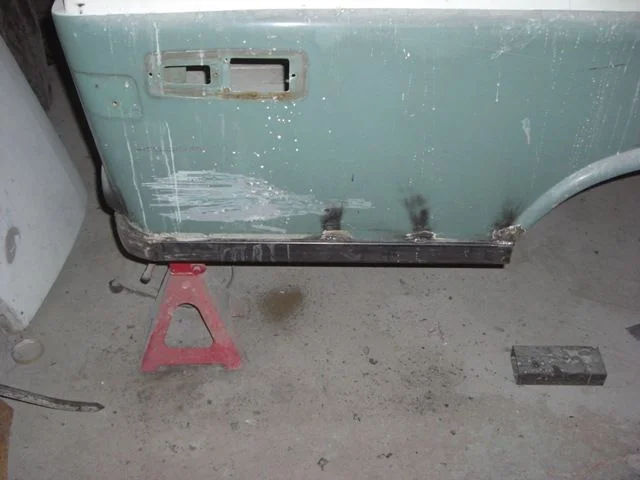

mean while, the other parts are starting to get on chape, on the body an paint are finally working
but i think there is more rust than i have espected

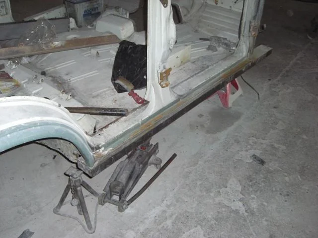

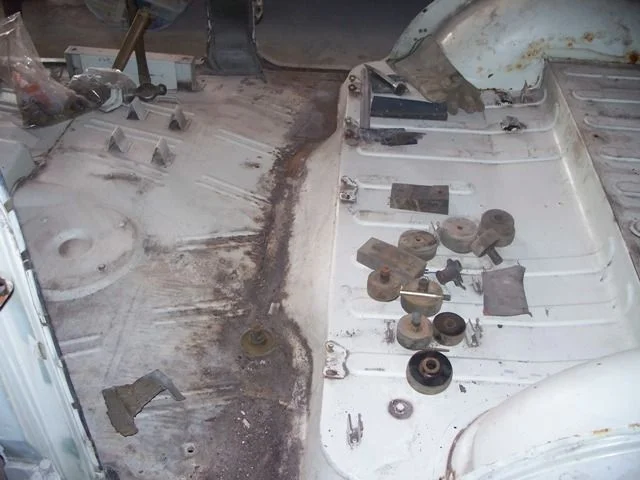

the resto process is goin slow, new job no time to get into, and the guys from the body&paint shop are also to I hope i Will get the paint job done by the end of the month, well at least still goingName:  CIMG0319.jpg

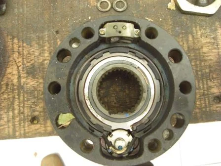

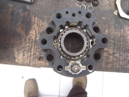

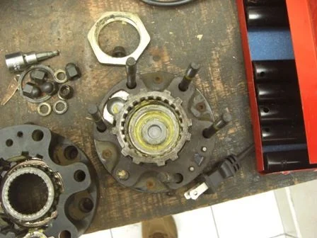

hi All, yesterday I went to get new birfields and hubs for my pig and y have purchase this hubs (impulsive fool)
They are electric activated hubs
and to be honest this is the first time that I see that kind hubs on my life and if one of you knolegeble guys have some information about how they work properly I will apreciate Name:  CIMG0338.jpg
thanks
