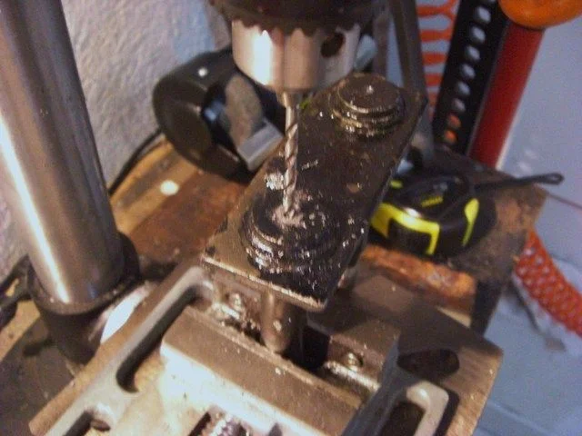

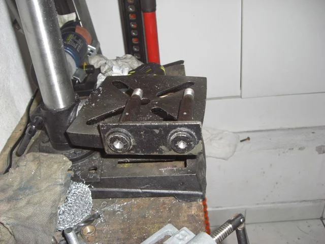

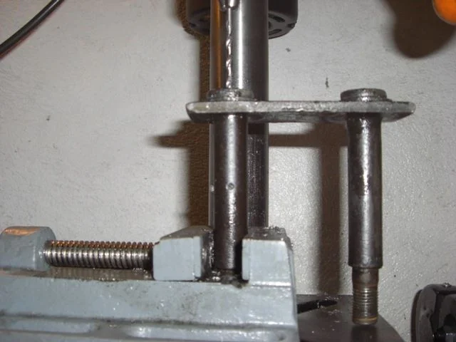

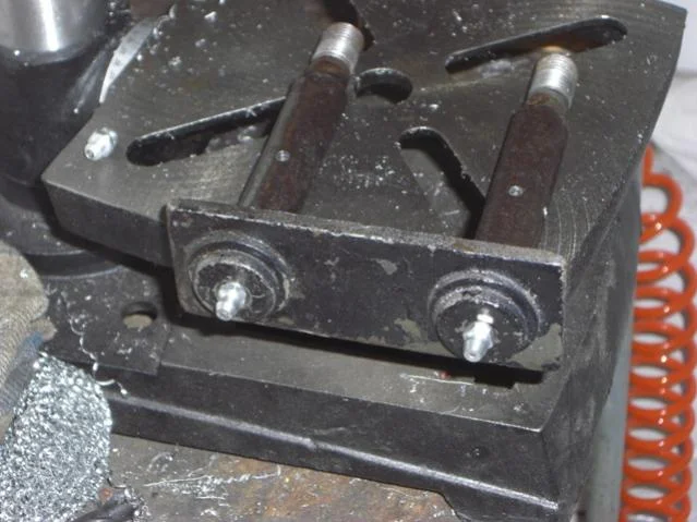

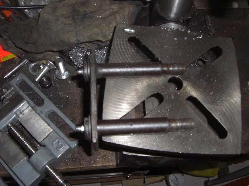

ok back to work, on the SOA that i am planing to my Pig i want to use as much OEm part as I can, when i was taking out the front axle I check the shackles and it simzs to be that they are no wormout, as I tough
takes a little time to drill the hole and change the old shackles in something that you can really reuse

Greaseable shackle pins are worth the time. I made my own too, however, I used grade 8 bolts. Needless to say, I went through a couple drill bits...
Looking good dude.

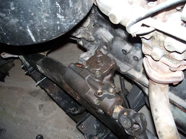

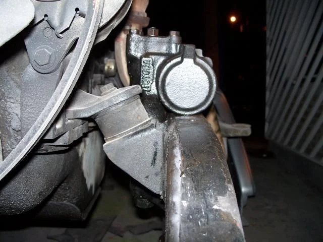

and here the first steering locations ideas

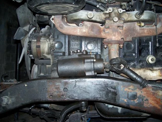

this is a BJ60 steering box japanese version (right side) I have found that location is a little far back but very clean and easy to install the only thing is we have to move the bumpstop 2 inches back

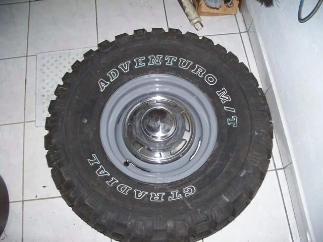

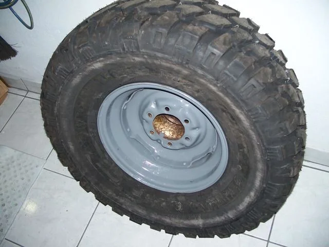

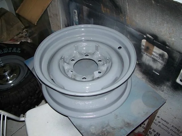

Well back to work !!!!
today I have finish painting the rims of the pig, already put tires on 3 of them
Name:  llantas animal 0012.jpg
Name:  llantas animal 0022.jpg
Name:  llantas animal 0042.jpg
I also need some help I am looking for 2 caps for the front wheel with the hole for the hubs, if some one has 2 that dont need, please send me an email to victor@eurobungy.com

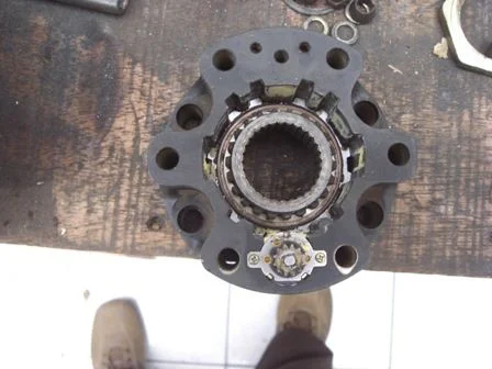

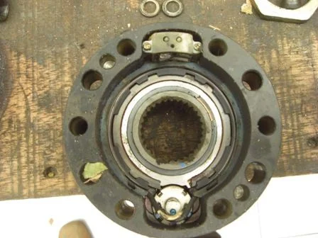

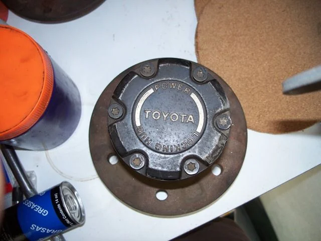

Quote:
Originally Posted by animaldevictor View Post

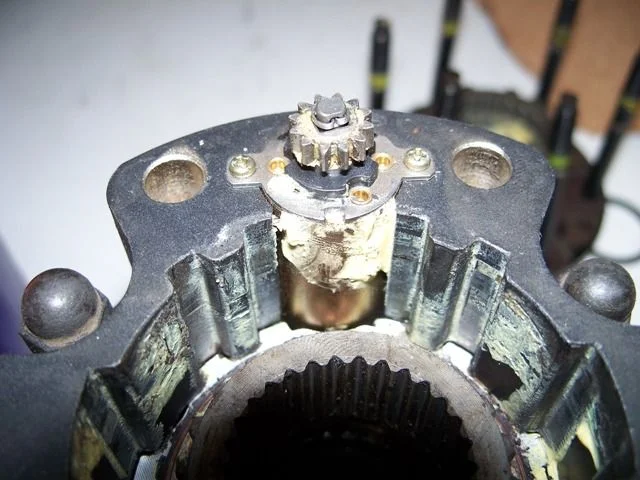

hi All, yesterday I went to get new birfields and hubs for my pig and y have purchase this hubs (impulsive fool)
Attachment 237579
They are electric activated hubs
Attachment 237581
and to be honest this is the first time that I see that kind hubs on my life and if one of you knolegeble guys have some information about how they work properly I will apreciate Attachment 237582
thanks
More pics. I have never seen a hub like that.

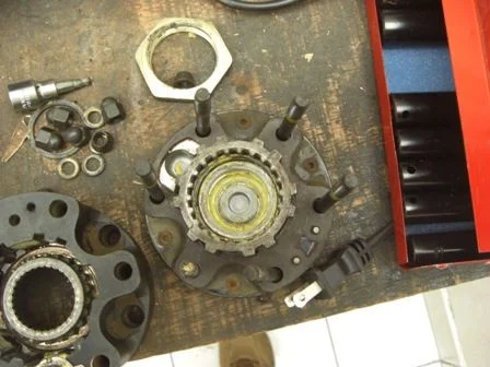

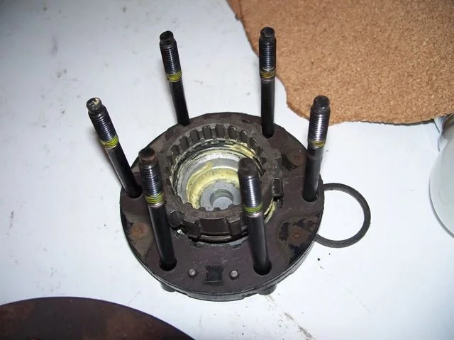

here are some pictures of the electric hubs

Those are totally useless and really just junk electric hubs which we would remove regularly and install manual units.
In otherwords without all the wiring harness etc you are going to need some cruiser hubs or mini truck hubs including hub housing.

well friends, back on work I had some issues with the OEM rims and the new Calipers and the tie rods, and I finish sending the rims to the rims shop so they can move the centerhub further inside in that way the rim descreases de back spacing like 3/4 inch good enough to fit nice

Old 12-01-08, 05:05 PM   #53 (permalink)
Forum Regular
animaldevictor's Avatar
Join Date: Oct 2007
Location: San Jose, Costa Rica
Posts: 142
here more pics of the paint job in process

Old 12-02-08, 02:03 PM   #54 (permalink)
Forum Lifer
RHINO's Avatar
Join Date: Dec 2003
Location: valley of the sunstroke, AZ
Posts: 3,189
posts like this help me realize things about the world, like who woulda thought the rim shop, local no less would be available like that to do what they did.
and another thing i notice, its not just mexican nationals who paint car parts bright colors
__________________
Clay
75 BDJ55- biopig
RHINO is offline   Reply With Quote

Old 12-03-08, 10:10 PM   #58 (permalink)
Forum Regular
Join Date: Oct 2007
Posts: 142
hi Rhino, the green I whant is the like the olive green but not too dark like pig on the photo I have also purchace a galon of ultratuff in olive green for the floors and under carriage and the chasis on black
I am also thinking in get a diesel engine like a 15B or a 13B-T someone here is seling a 2H in $5000 with 5 speed transfer but I most make the money first , well in a near future maybe
cheers
__________________
In Costa Rica there are a lot of of pigs!!!!!!!!!!!!!
animaldevictor is offline   Reply With Quote
