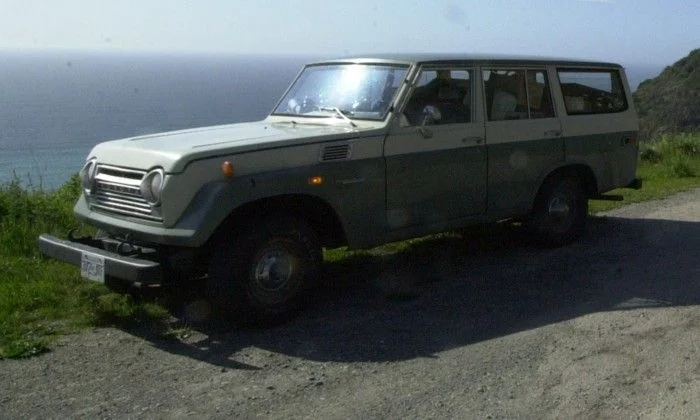

cruiser_guy's Avatar
Join Date: Jan 2003
Location: Cranbrook, B.C., Canada
Posts: 9,420
I have the SOR '55 springs, shocks, greaseable pins and slightly longer shackles on the '55.
Here's a poser shot both before with the stock 235/75/15 tires and after with 33x9.5x15.
I'm happy with the ride and the spring firmness so far. We did the lift in March of this year.
